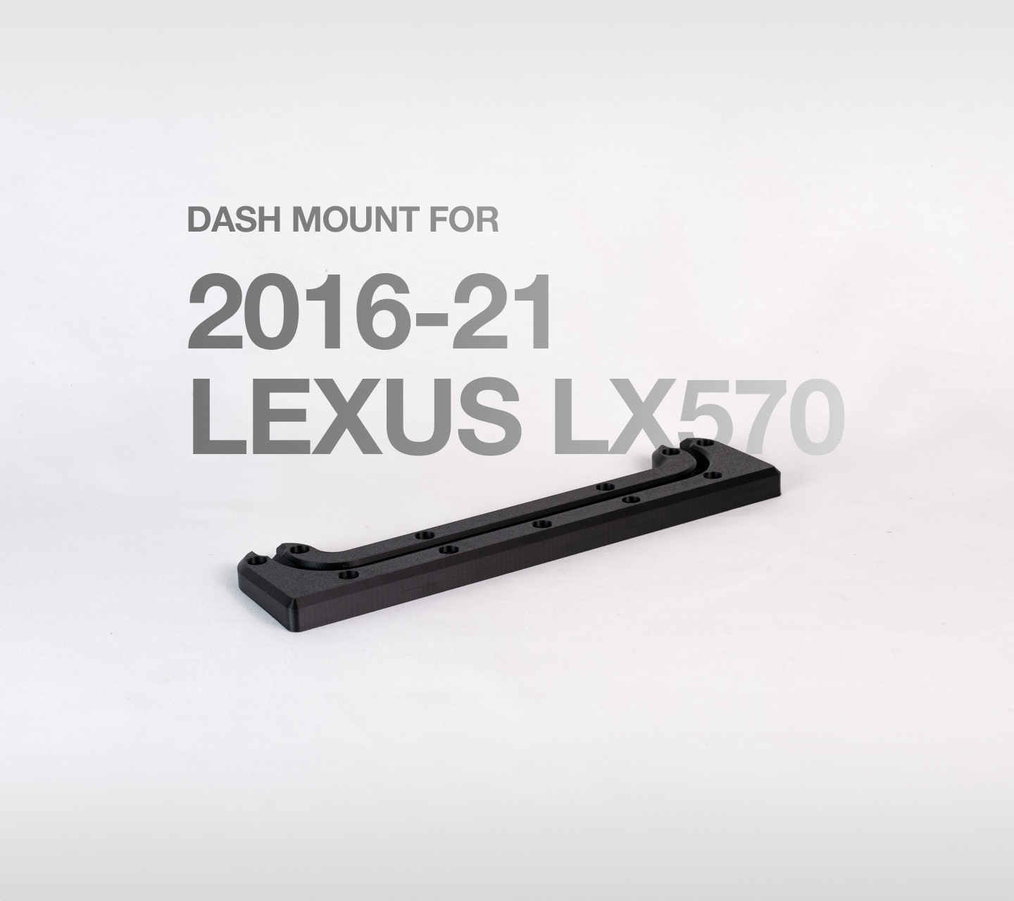

I can try but I have to find a stretch of washboard and drive about 30mph. When I bought the vehicle it had one of these installed and I need to double check it’s still mounted firmly. When I get the rattle it seems to stop when I put pressure on the dash around the HUD unit. If I try the warranty route I may need to remove it which means I think I’d need to replace the speaker grill as well.
