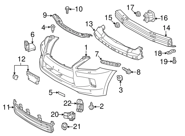

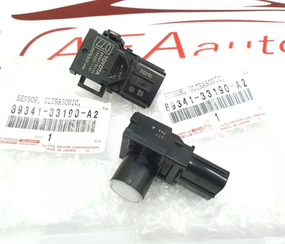

Looks like this is the part:
I am guessing it is just a plug and play and that none of the other accompanying parts (#s 21 and 22 in below diagram) need replacing:
just to clarify ... your pic is not for your color. The link is.
If you willing to paint you can get the new sensor at much lower price on ebay ($52 what I got, the silver is brighter than yours), partsouq.com ($105), or amayama.com ($75). Sorry you got the expensive color (I got the same).
