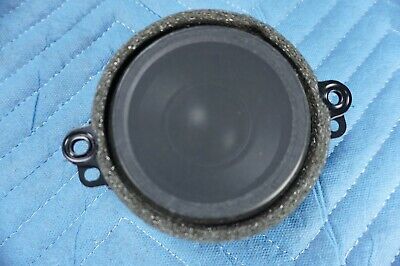

The speaker in the dash on passenger side is blown (crackling sound) and I want to replace.
Wondering how easy it might be to source speaker myself and replace? Has anyone tried to access these speakers before? Wondering if I should just go to dealer and bite the bullet?
You could always refoam the speaker. I am guessing that the grill pops out and the speaker unbolts fron the top or you have to remove a good portion of the dash to get the speaker out.
Blown speaker is kind of a generic term. It probably needs new foam or possibly a new capacitor. Either way pull it out and let's see what's up. I bet it can be fixed easily.

I’ve never pulled it, but looks like it’s clipped in like the center grill is.
As an update to this old thread, I investigated this for a while, including taking off speaker grill (snapped off one clip but it performs as should), but it turns out the “crackling” I was hearing was actually the fake wood trim on the door panel.
