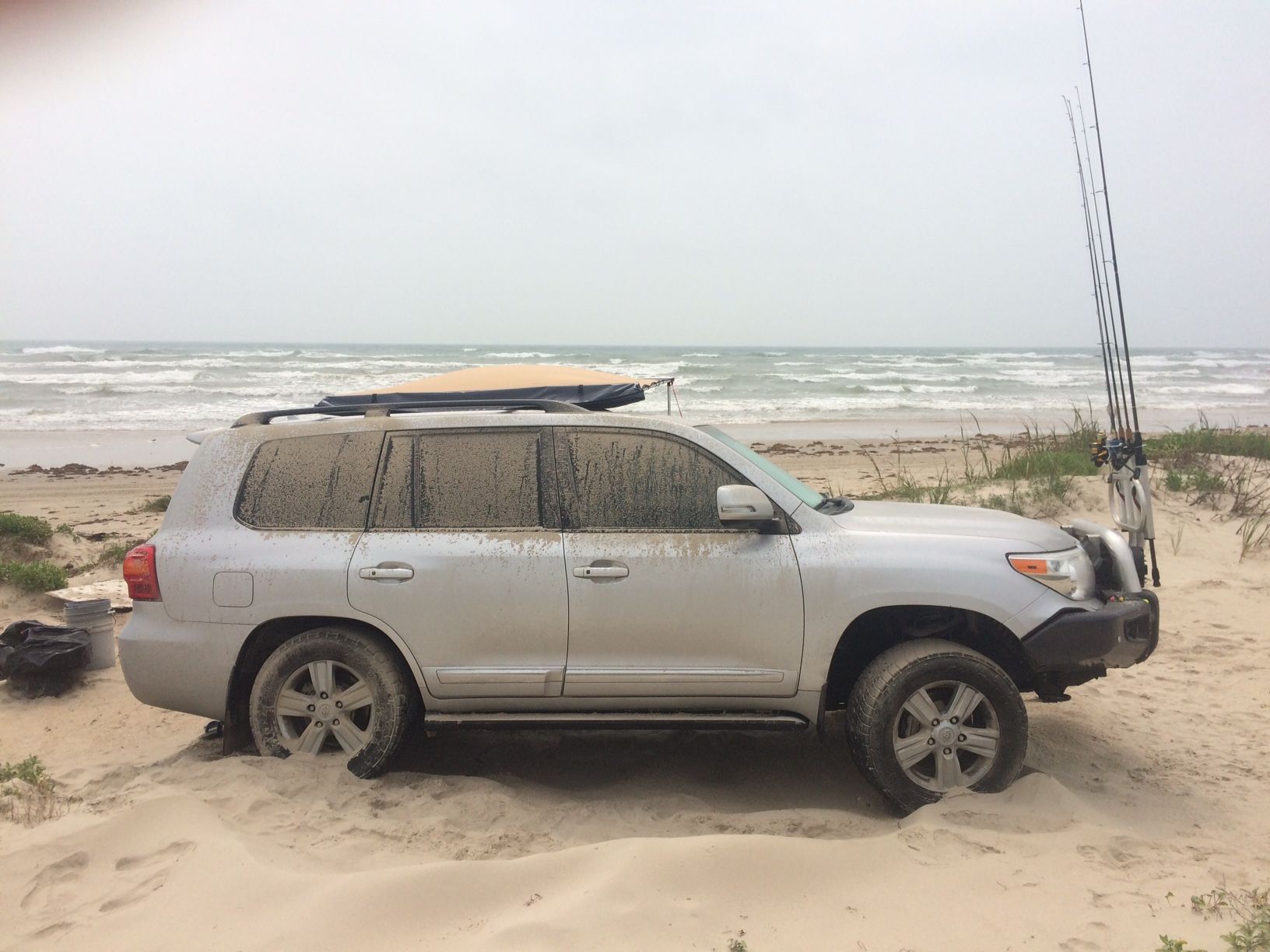

Installed ARB bumper and winch. 1" OEM lift kit on front. Phase 2 - add 1" lift to back and going to 70 size tires. Any comments on disrupting KDSS functionality, off road capabilities going down this path? I see caveats in ARB documentation re: make sure your installer knows about KDSS when adding lift kits. Any issues with larger tires besides speedometer influence? My off road is mainly on Texas beaches.

Post a pic of your truck....we love pics!!!
