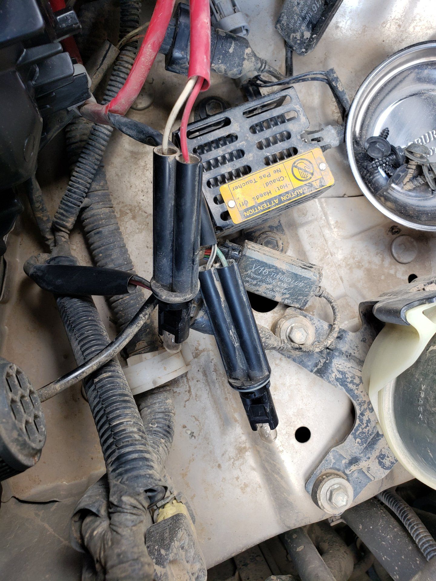

Hey bud, not sure if you figured it out yet or not. But I just replaced my headlamp on a 08 LC and there is definitely a bulb there in the side. the harness is part of the same loom that takes care of the turn signal bulb and your "clearance light"
Here is a picture of mine, hopefully it helps track it down for you?

On my truck the side marker light does exist behind the orange reflector on the side, but it consists of two low powered LED bulbs directly soldered to a circuit board which is mounted there. On the attached picture they are shown in the green highlighted area.
