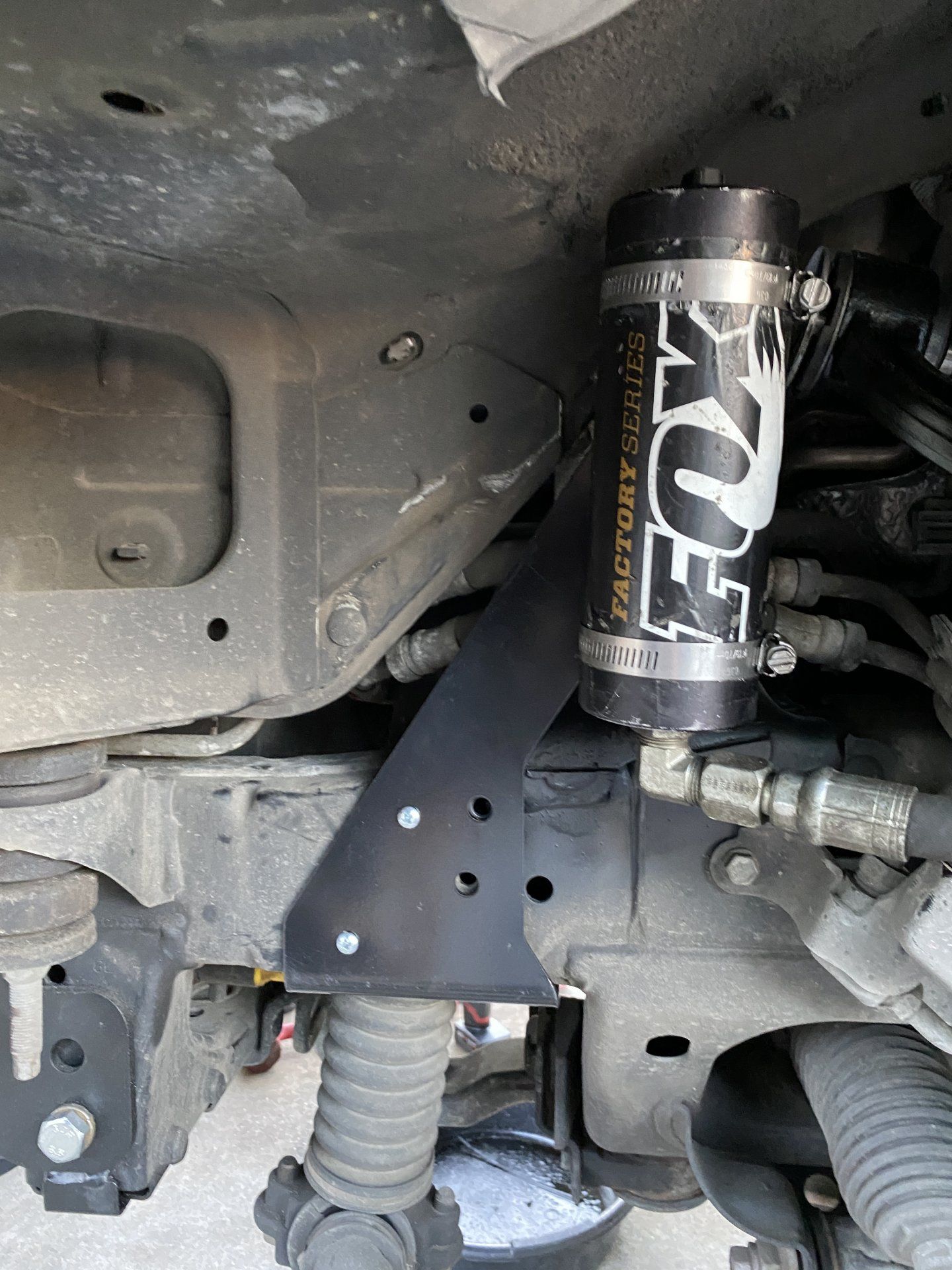

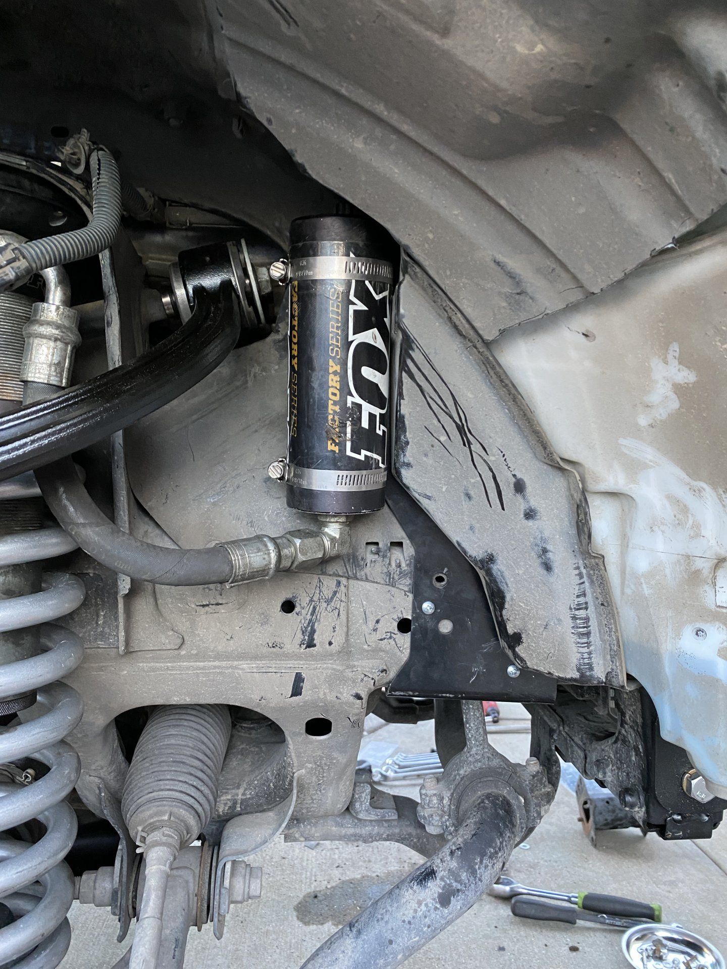

For the front reservoir brackets, I had to drill holes and use the provided tapping screws to install to the side of the frame. When mounting the reservoirs, you can adjust the hose orientation by gently cracking the nut just enough to rotate the fitting. If it was already installed on a 470, the hoses should already be set up. I think on the 470 they might use the sway bar holes to mount the bracket. In the GXOR facebook post, we discuss the passenger side interference with the windshield washer. For me this required a different routing of the hose, and the reservoir was mounted a little lower to clear the washer tank. The extended travel shocks require upper control arms. For this and all other Fox suspension products I recommend Camburg. I've been running their suspensions for over a decade in my vehicles.
Got them installed!
