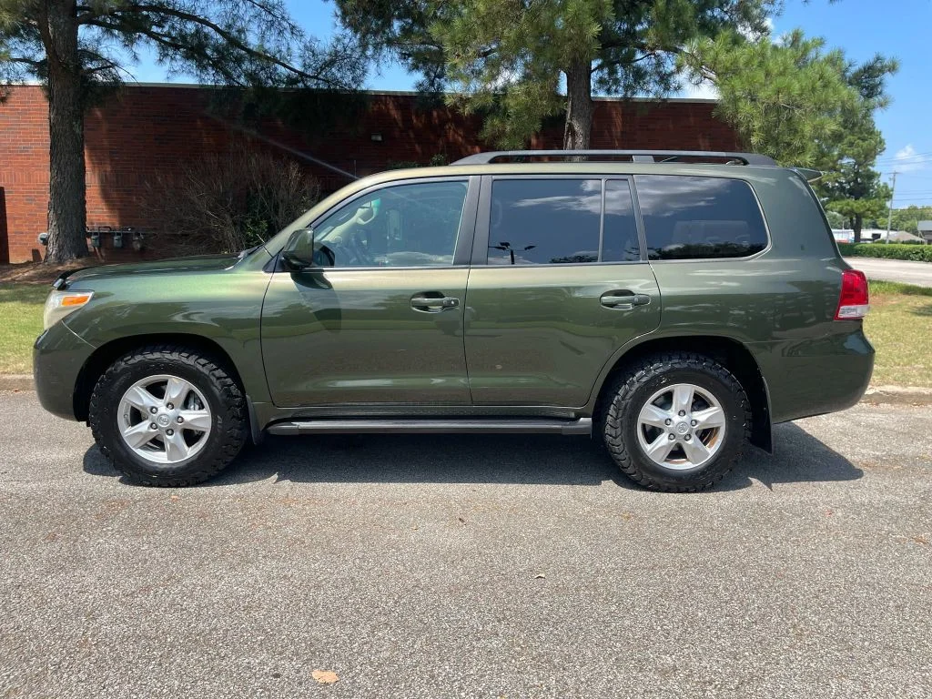

I was traveling for work and stopped my to take a look at this rare 2010 Amazon Green w/ Beige Interior. I ended up passing as I still love my 2008 LX570 and couldn't justify making a lateral move...even if I truly LOVE Amazon Green.
~245k miles for $22,995 at dealer (I have no affiliation)
For someone really craving the color and able to do a little bit of work, here is what you'd want to know. (From an LX570 owner of the last 3 years who does my own maintenance.)
1. Zero rust. Lived it's life in TN.
2. A little clear coat issues on roof & rear hatch (common for Amazon Green), but nothing bad at all.
3. Aftermarket radiator installed (Not sure of brand, but I'd swap it to OEM) It also had zero coolant in the overflow tank. I informed the dealership who said they were going to add some.
4. No evidence of coolant valley leak

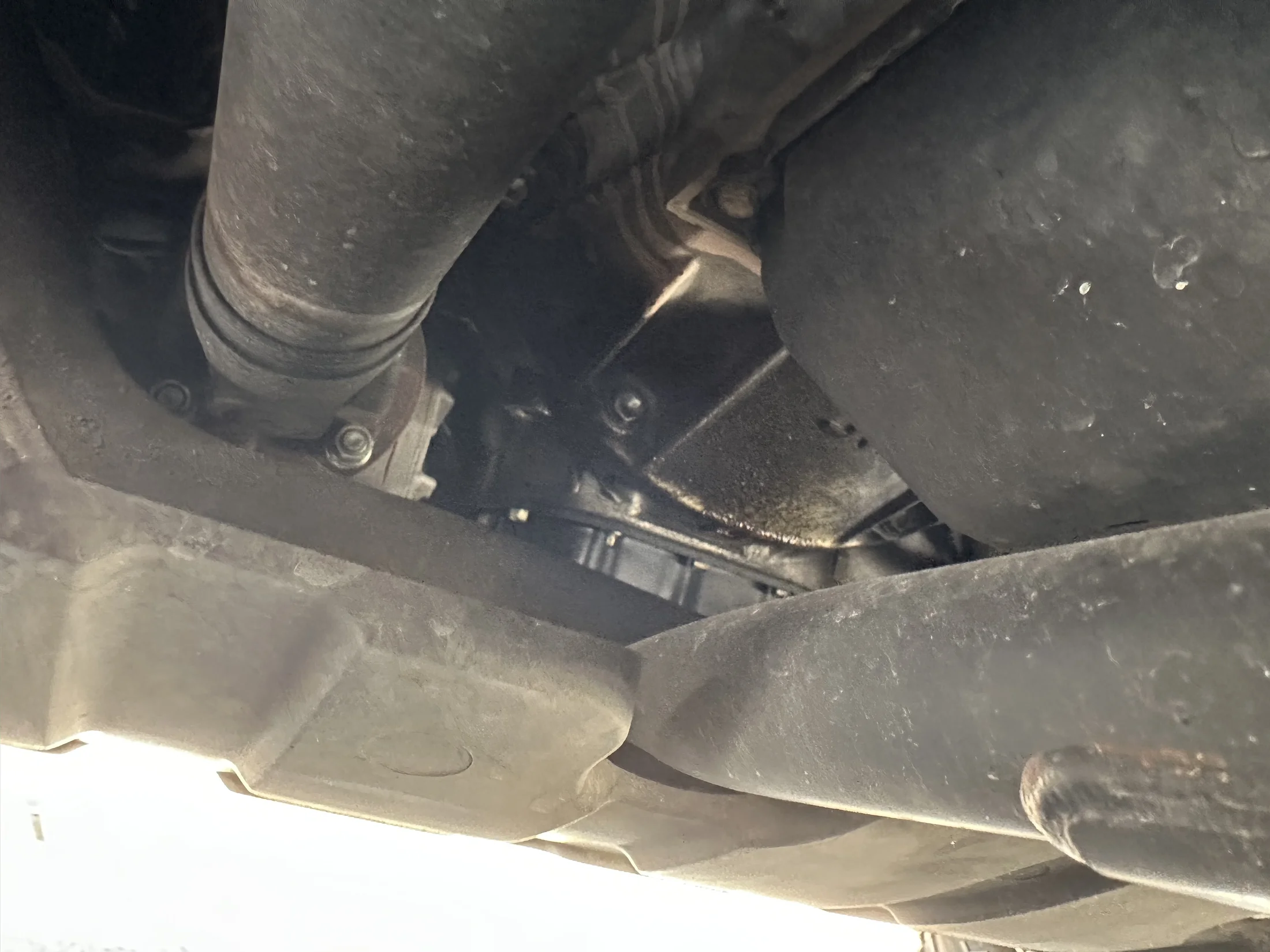

5. Looks like an oil leak from the rear main seal between the engine and transmission. (This was my main concern, though many here on the forum have said they have a slow leak and just keep an eye on it.)
6. Faded interior head unit
7. Seats in great condition
8. Has a variety of small things missing (Heated seat knobs, plastic cover for one of the roof rack posts, plastic cover for windshield wiper bolt, etc...)
9. Accident on Carfax from 2017 showing rear right damage. They must have done a great job repairing it as I saw no differences in gaps between panels or rust anywhere.
10. Left rear wheel has rust. (Mostly cosmetic)
11. Relatively new KO3 tires.
