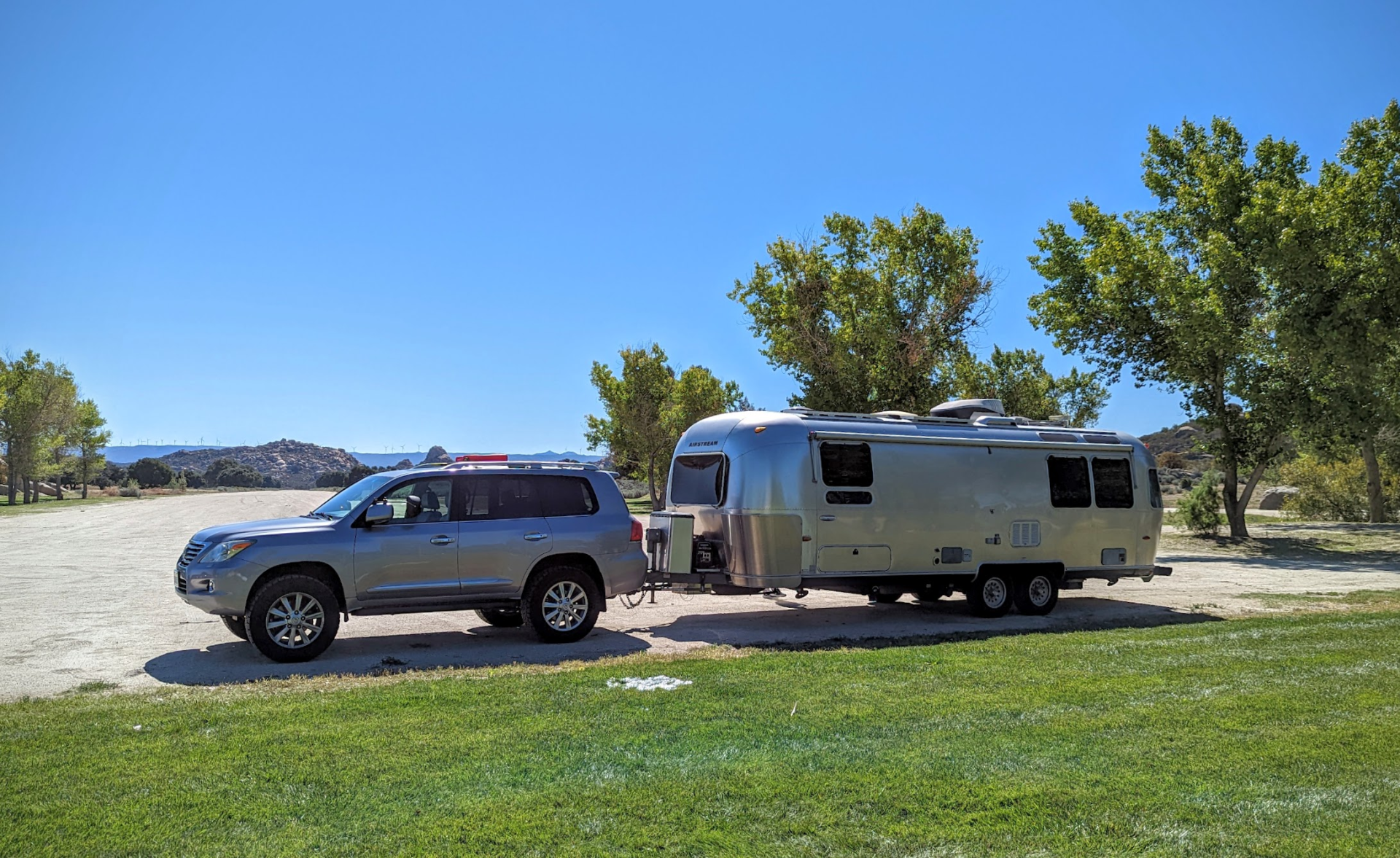

Wow, she's a beaut. Triple axle goodness.
What year is she? I'm guessing a late 90s excella, which makes it a 8.5' widebody?
I think you might know that formally, she's outside of the factory tow specs of the 200-series. The weight is marginal and the length is a larger concern against a relatively short wheelbase 200 series (which has the exact same wheelbase as an 80-series). It sounds to me like you're full timing which makes her on the high side of heavy?
In my experience towing on the higher end or just over capacity, towing a 27FB @8k lbs and 1200lb hitch, I think towing that 34 would be marginal. If it's only a handful of times a year, it might be worthwhile to rent a commercial 3/4-ton pickup when the need arises. If it's shorter trips on local roads, I might brave it. An LC is going to need some help particularly airbags to help with load.
Though every one of my mods isn't exactly conducive to towing and the 200-series tow with aplomb.

Never thought about it until you asked, but my 200-series and AS are pretty close in years too. 2009 LX570 and 2007 AS 27FB.
For towing a few miles if it's generally slower local roads, I would have no qualms. It's the freeway speeds into unknown grades and weather that I was more concerned about.

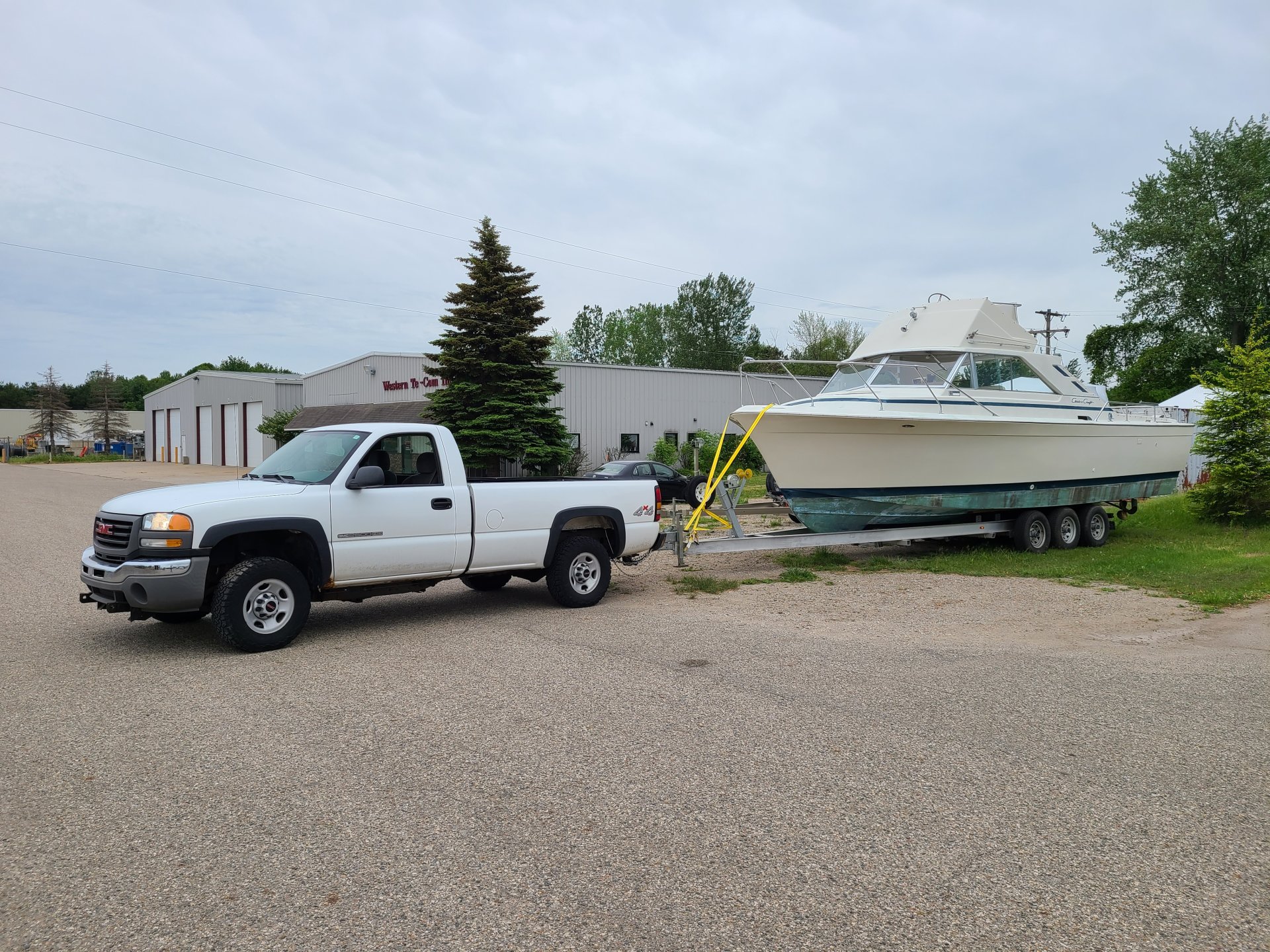

Moving around the yard or up the street is ok with a big trailer. I beg/borrow/rent a 3/4-ton or bigger for the 5-mile, 15mph tow to the ramp in the spring. I really think the 200 could do it just fine, but I'm not playing the odds. I think I could pull this 10,000-lb boat up the ramp with my 200, just to get it out for servicing if needed. I've pulled it around the industrial neighborhood here just to see how it pulled and braked. Kinda spooky, nope on road towing. No problem for pulling it through gravel and grass when putting it up for winter.
View attachment 3164262View attachment 3164263
If it’s just the ramp, put it in 4L. 10k lbs is a lot to pull in the street though
