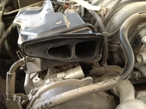

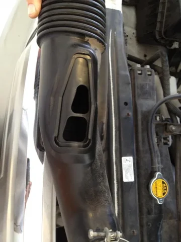

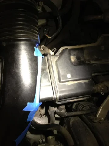

My wife's Cruiser has never been as smooth as mine in the engine. Replaced the fuel filter, cleaned the MAF, and the throttle body. When I removed the formed hose from the air cleaner it fell right off the plastic piece in the picture. It doesn't really appear to be correct....thinking of using RTV tomorrow....for tonight 3M painters tape.

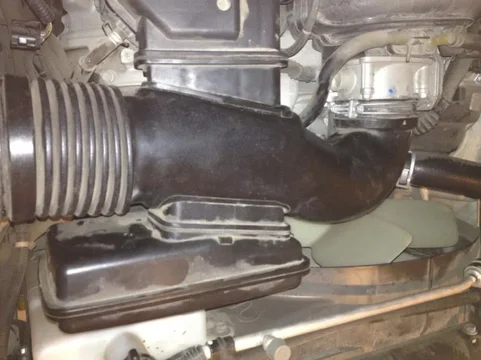

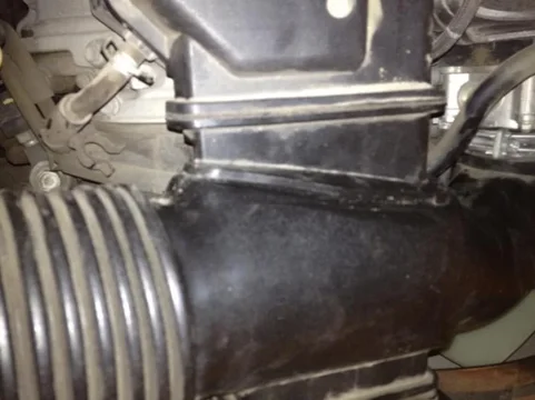

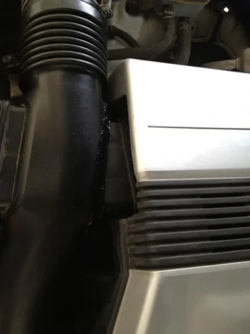

I put it back together with "MAF safe" RTV.
Sent from my phone
When you get on it now...post cleaning/RVT....much more exciting. Probably the first cleaning in 69,000 miles. Picked up 3 mpg in the city.....up to 12!
