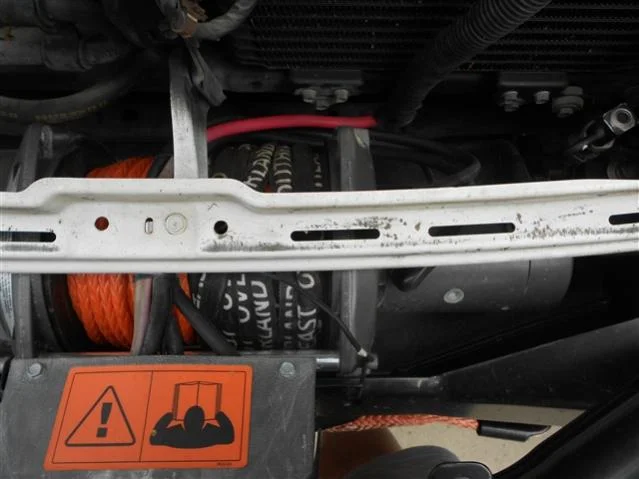

SkyHunter, looks like you have it all sorted out. I mentioned this before... that AT cooler hose in the upper left corner will eventually fail if it is touching the winch now. There is constant friction between the two as the body moves/flexes in relation to the frame.
You can't really shorten the hose since it has special end fittings. I'd wrap that portion with another hose (split) and double zip tie it away from the winch.

Excellent suggestion on the extra hose, Hoser. BTW, that's the before picture. Thank you again!
