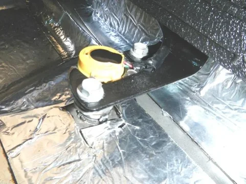

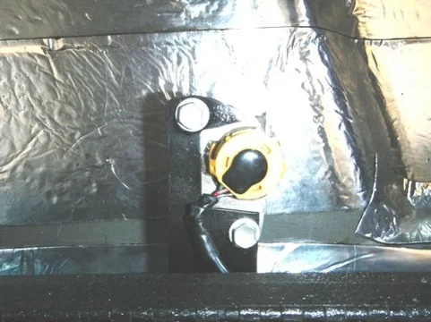

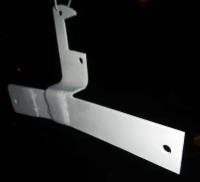

Hi Steve,
Just a month ago I encountered the exact same problem. I chose to make an adapter bracket instead of plugging the hole and using the remote key fob. The bracket attaches using the same hex head bolt holes as Keven's tailgate is held in place with (although you do need to get longer bolts.
Cheers
Graeme
