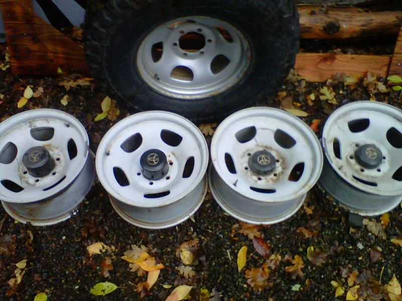

been running the 33x10.5 BFG ATs for about 15k now, then today I found some 16x8 FJ80 non-USA spec steelies on craigslist.
set of 5 with center caps, one with a brand new 305/70/16 BFG MT KM1 mounted on it and got it all for $200
woot! I love these wheels and this is the first set I'd ever seen on CL.

Issue is that those FJ80 steelies are rubbing a little on the caliper:
can I just shave about 1/16" off the inside corner, they look beefy enough.
grrrr...
I would hit them with the grinder instead of possibly wearing down the inside of the wheel
