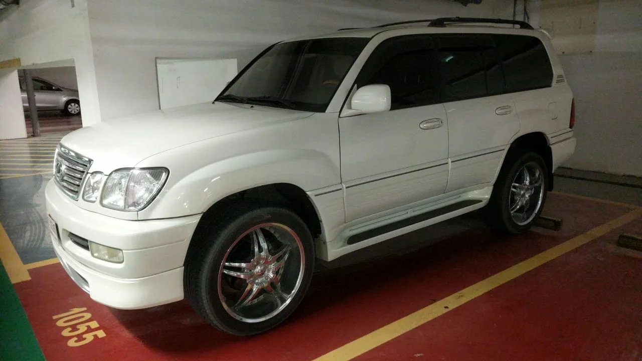

I'm shipping my '93 and '98 trucks back to the US for family use there so I decided I needed new wheels here in Dubai. I ended up buying a very nice, low mileage Japanese spec import that's been 'blinged' up, as you can see here:

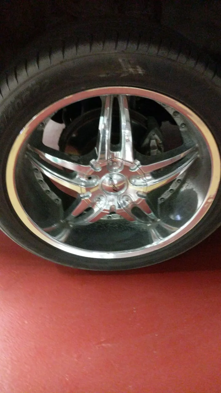

Yes, those are 22x10 inch rims on the truck.

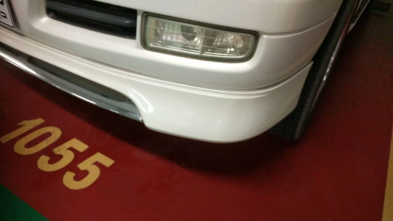

And she has an air dam of some sort on the front:

I drove the truck around 300km yesterday, down to the camel leather factory (not kidding) between Abu Dhabi and Al Ain, and the ride was terrible on washboard and over road bumps. Really bad.
AHC needs attention, which is another issue, but my question to the collective wisdom of this forum is whether there is any point to putting bigger rubber on these rims, or shall I just go and get some more conventionally sized rims and some 285/70 R17 rubber for example?
I'd really like to hear your thoughts.
I would guess that the horrible ride is partly due to the 22" wheels. Find some 16s or 17s and I bet the ride improves drastically.
buy 2003-07 stock 18in LC wheels, and new rubber.

No sidewall, of course the ride quality will suffer, my suggestion would be 16 inch on some method race wheels, 265 bf goodrich . That would look pretty good, good side wall, enough cushion between you and the road.

You guys are all confirming what I've been thinking. I played with the idea of getting bigger rubber on the existing 22 inch wheels, but there is not that much room in there. The good news is that stock rims are readily available from many scrap yards here.

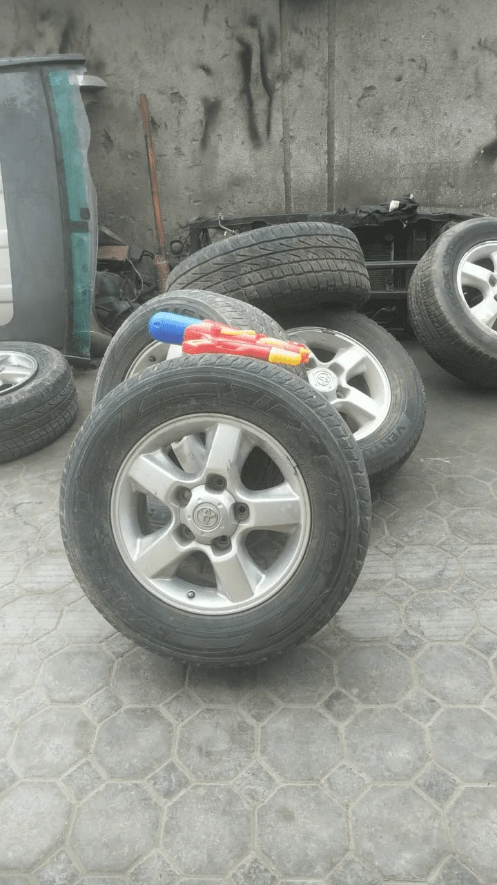

Well most of a year later, and a 93 Model 80 and a 92 Model 77 later, I finally got around to it. Bit of an ordeal. A couple of weeks ago I worked out a deal with a Model 100 wrecker up in Sharjah. He would take my 22" rims and the original 16 inch spare plus some cash in exchange for five 18 inch OEM rims in good condition. I went ahead and bought 285/65 R18 in a Korean brand I'd never heard of--Marshall.
I got up there on Saturday and the rims were not quite as nice as I had hoped, but the guy's laborer helped me sort through a bunch of tires to find 5 rims that are not too bad:
1952777
I asked for help swapping the rims but when we looked the 22" needed some awful thin socket. Really, really an awful rim and rim design. So the guy called his brother/partner and he came and lead me to a tire shop where they changed the four rims to the OEM rims with the old rubber on them.

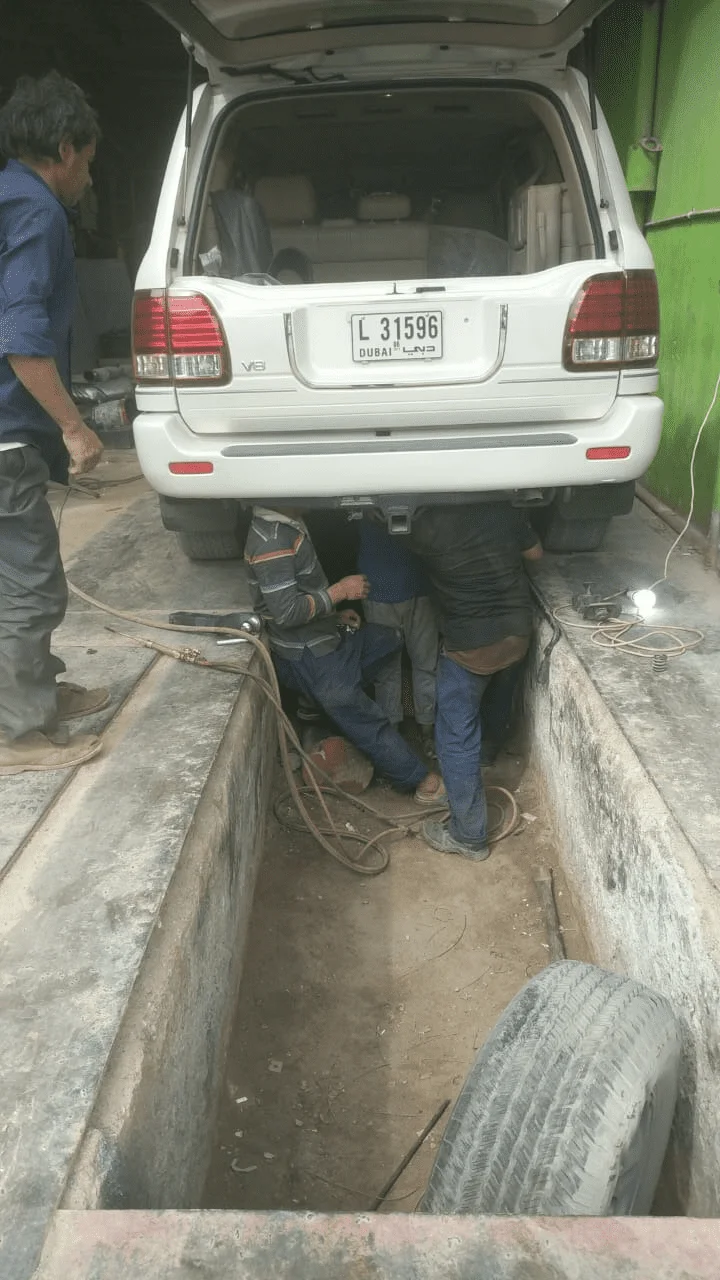

But when we tried to get the spare we found that it had one of those awful spare locks but no key in the toolkit. We drove back to the wrecker who had two or three keys but none of them worked. So then we drove to the brother's shop and he had an even dozen. Still no joy. He suggested that I find a repair shop and have them cut off the spare winch with a torch and then replaced it with one he sold me in the US Land Cruiser style that just operates with the normal tool kit parts.
So off I went..and found a muffler shop that was happy for the drop in business. Everyone was on break (in Sharjah nobody works between 2 and 4 pm), so I hung out with a cigar and enjoyed the fine weather:

They tried for a while to find a way to defeat the lock but ultimately just cut off the cable with a torch while another guy held the tire up. No drama and I could finally fulfill my deal with the scrapper and give the spare/rim (in like-new condition I might add) to him.
