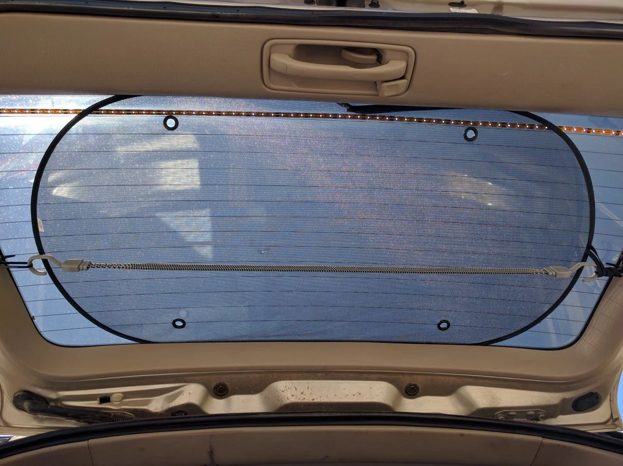

I re positioned some sun shades that kept falling down. I leave these shades up most of the time and now that I fit them between the window and the trim, they stay in place very well.

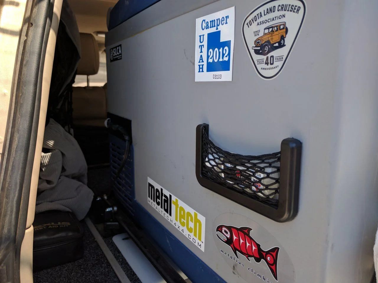

I also re positioned the cord to the fridge. I had previously used a couple shorter pieces of velcro that fell off in the heat. So I replaced them with one big strip that routes the wire exactly where I want it securely so the cord doesn't get caught. I leave this fridge in the truck running almost all the time. I keep it set in the middle voltage shut off setting to protect the battery. As long as its parked in decent sun or driven regularly, the solar panel and Aux battery system keep things cool.

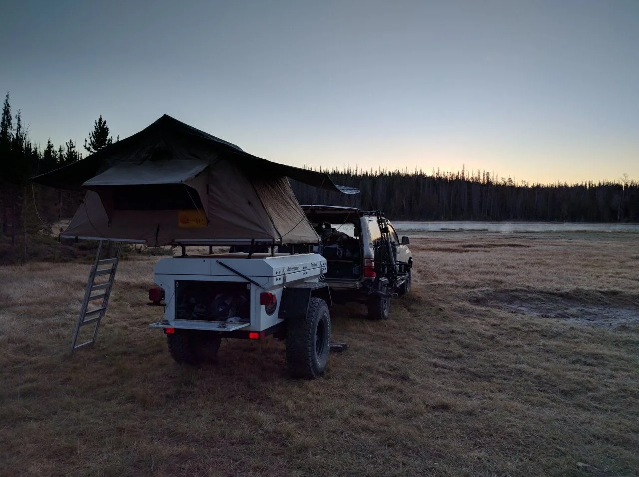

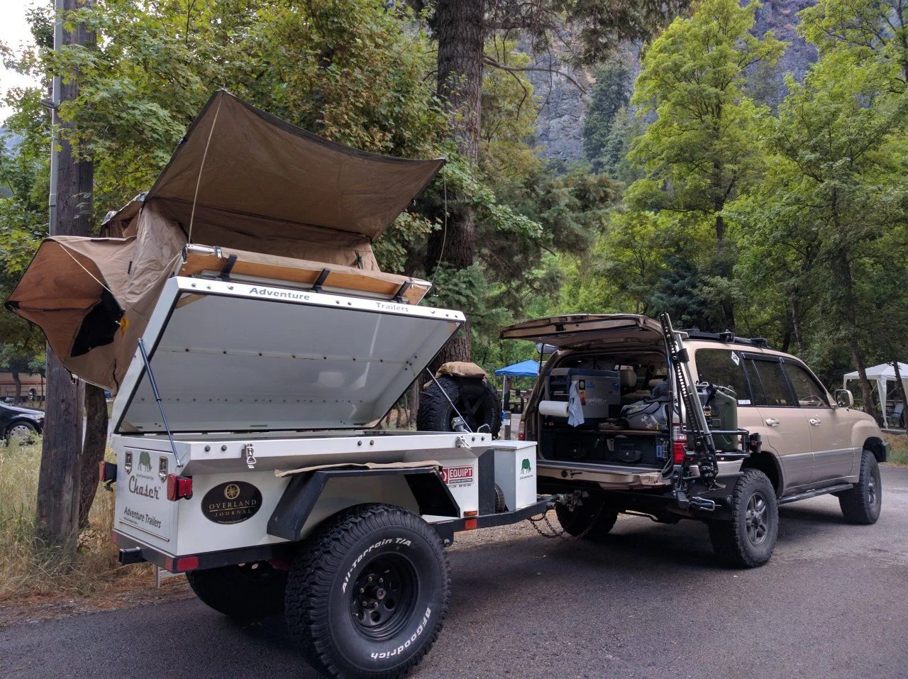

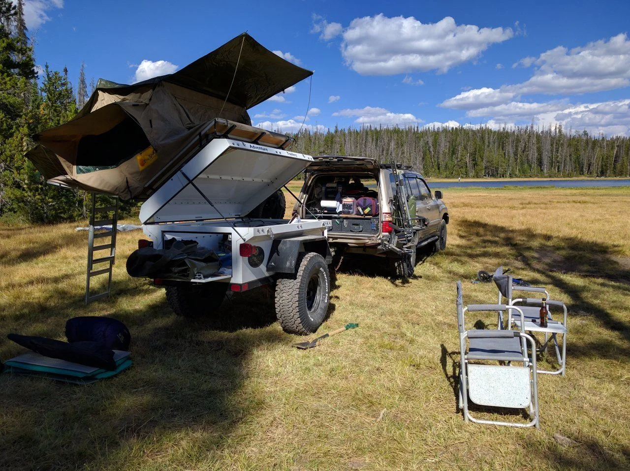

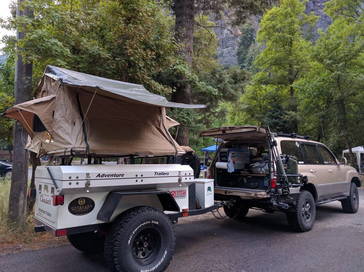

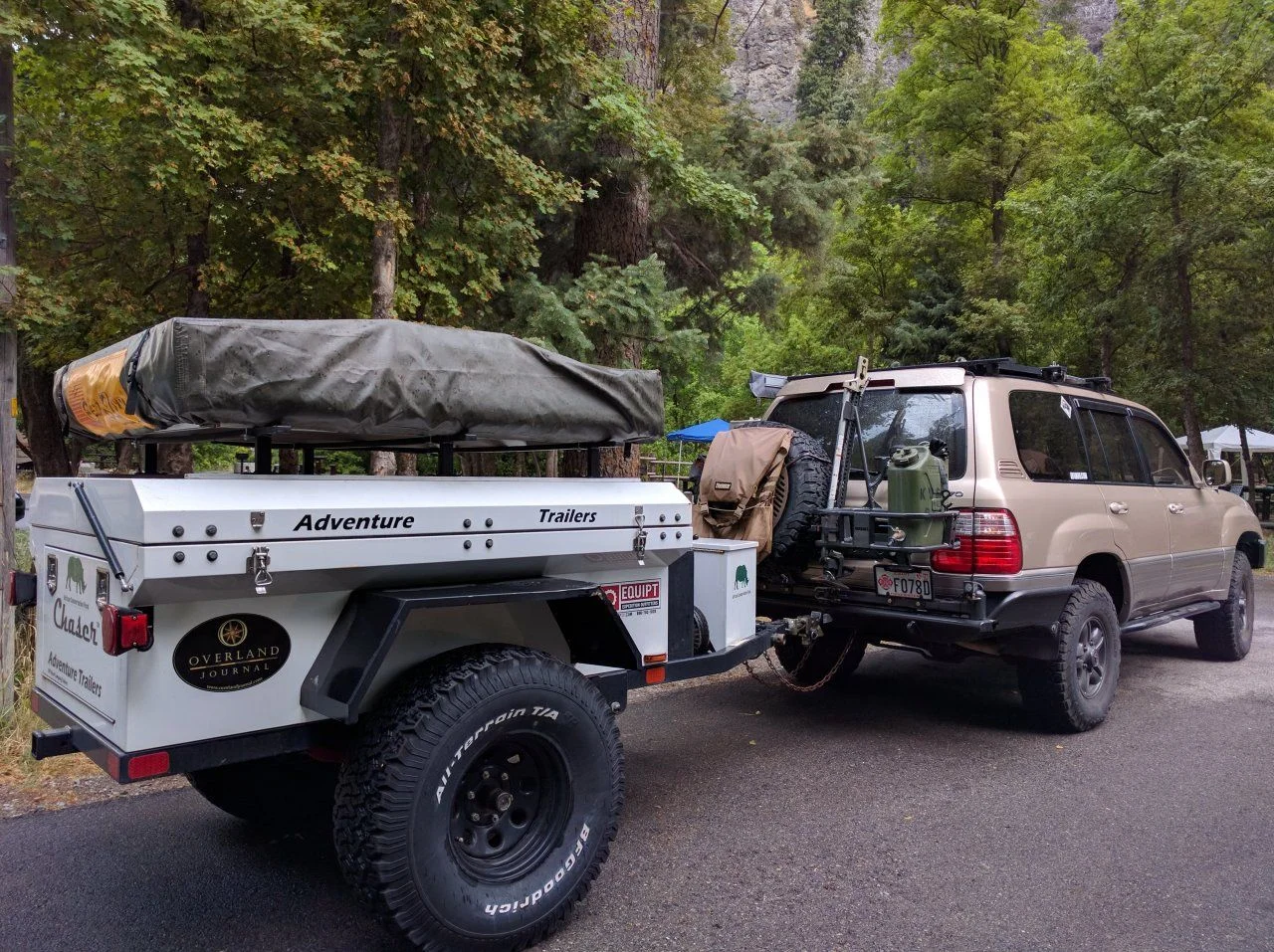

As I travel further along in search for the best of both worlds, I have been taking an off road trailer along on occasion. This particular model is an Adventure Trailers Chaser. Its a nice option to bring along some added storage space with a tent in a unit that can handle rough roads. As much as I don't like dragging around added weight when I don't need it, that argument can go either way with this tool. Its light and nimble enough that the LX can easily pull it up high places or through tight spaces. It allows me to carry things like a RTT separately that I don't want mounted to my vehicle most of the time. It can also be left behind at base camp when I don't want it to follow all over. They say that if you have space then you will use it and I find that to be pretty accurate as I will fill up extra space by bringing the kids bikes, extra chairs, firewood, and hauling trash. This only becomes an issue when I go back to thinking about how to leave so many things behind or fit them without a handy Chaser.
The clearances around the trailer allow access to the storage area with the tent deployed from the side or the rear. Both of the rear bumper swings clear the trailer easily. The nose box provides a nice platform in close proximity of the rear vehicle compartment. Even though the pivot wheel can be stowed horizontally, it can also be taken off and stored in a Jerry can slot to avoid some excess movement. Fortunately, this trailer moves easily enough that I can push it around when its not connected to a truck. Which is probably the easiest way to park it right now as I haven't completely adjusted to parking it in reverse.

Is that Chaser new to you Scott? Its pretty sweet, I've been thinking about adding some bars to my trailer before the club moab run. We'll see if it happens.
^ Nice! Is it a new AT Chaser or did you get used? Regardless, nice piece of kit. #jelly
Its fairly new to me. The tent would be nice on your trailer.
It is used, as it belongs to a good friend. Fortunately I get to use it as I'm invested in taking care of it.
Thanks for the interest, we have some ideas for it also.

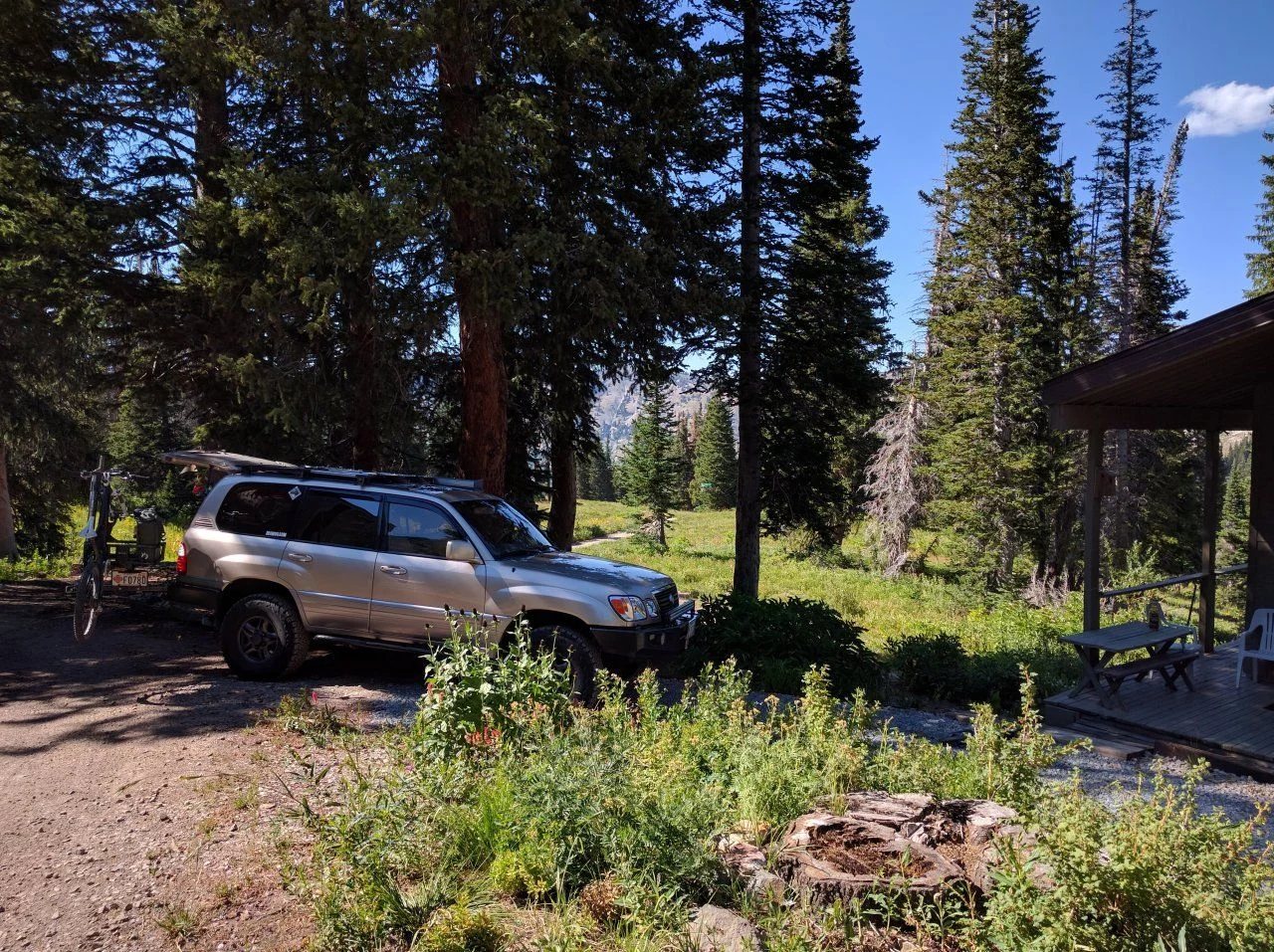

We have made several visits to a family cabin property over the past few months. So I'm going to hijack this build tread and continue to spam photos of Legusy out of the shop environment, in the preferred habitat.
The dvd player help to keep my son entertained while I enjoy the peaceful drive. Keeping his feet of my seat back is a whole other deal though.
