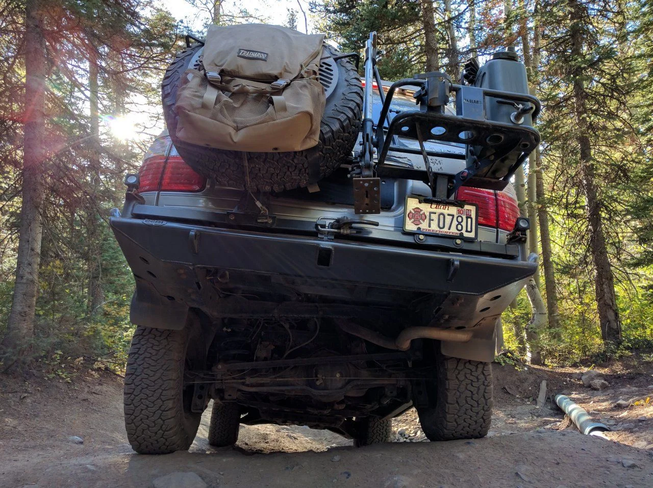

How secure is that rear fire extinguisher to the grab handle mount? You'd hate for that to come loose in an accident.
Thanks. The extinguisher is very secure(you can find more details earlier in this thread). The caveat is that it might take a few extra seconds to get it off. Rather that then any accidental movement.

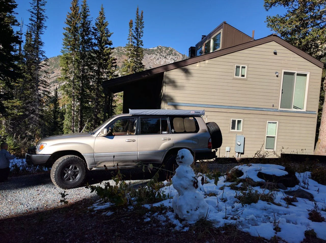

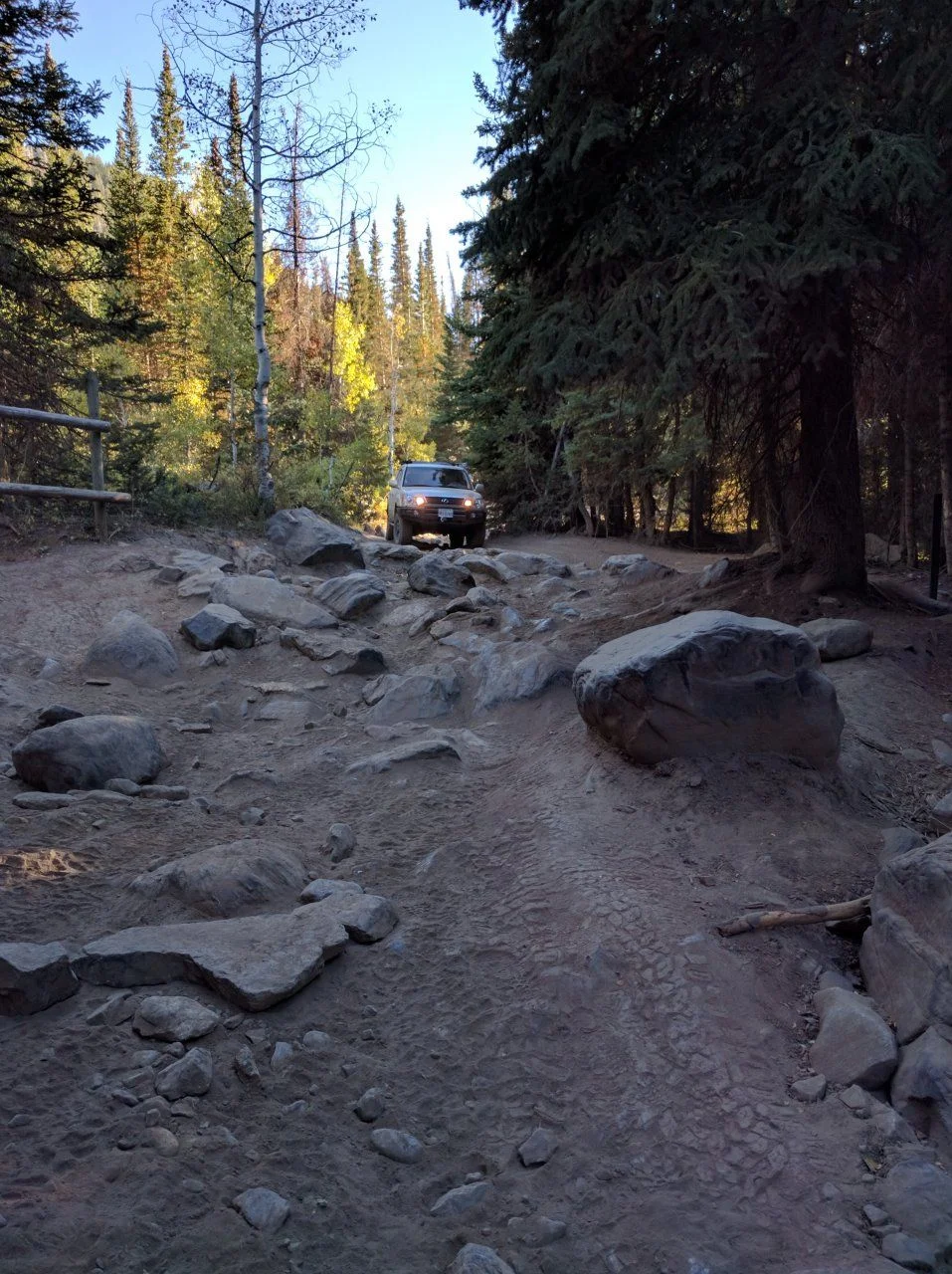

We made another recent visit and played in the snow. Eventually the access will be limited on cats, snowmobiles and chair lifts.

@S.CarolinaFZJ80 I copied the fire extinguisher location Scott used and will second that it is steady. Mine has seen lots of miles and bumps and its as secure now as it was when I mounted it up.
I was about to say the same thing about the fire extinguisher. I had one fly off a rollbar before and barely miss my dome.

Its important to make sure that the gear is secure. Whether bouncing around down the trails or engaging in sudden maneuvers on the road, I don't like things moving around unpredictably. That's another reason that I like to keep tools and spare parts organized in the drawers and behind the seats. For the extinguisher I favored accessibility. The metal mount that was made for it does fit pretty snug around the neck of the extinguisher, but I wouldn't trust it by itself. That's why I ran not 1 or 2 but 3 straps with velcro that actually thread through themselves and adhere back over the attachment. I ran them long to touch the headliner to assist with removal(of course I could always cut the straps and it might not be a bad idea to secure a strap cutter nearby for that reason). I considered going with a quick disconnect type of mount, but this seemed easier, much cheaper, and plenty secure.

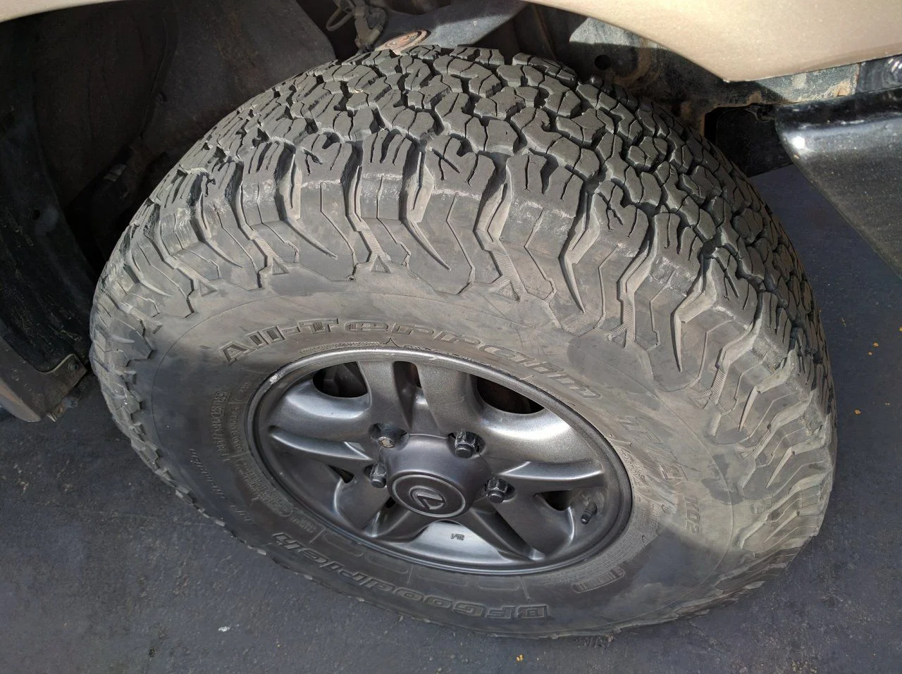

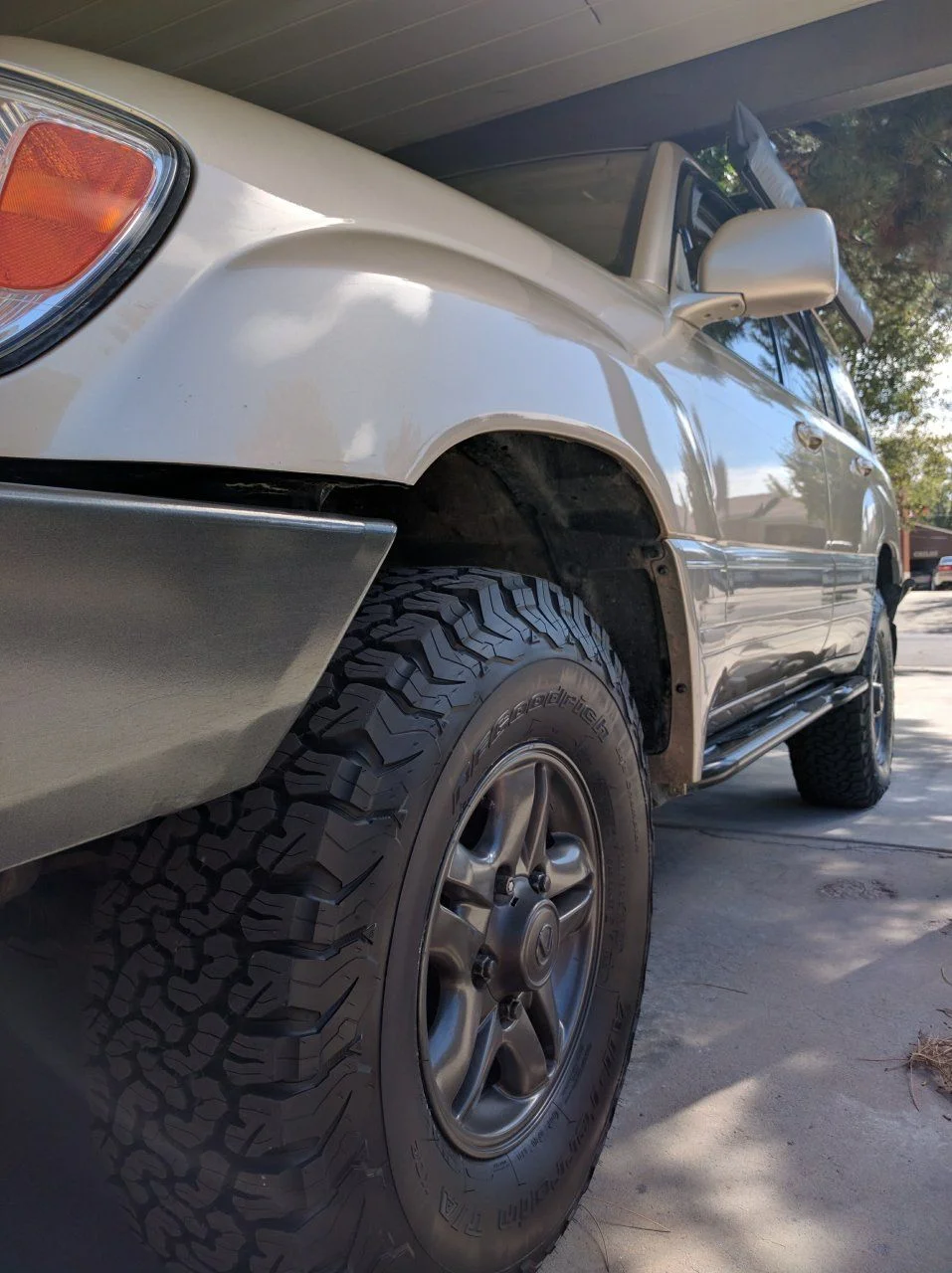

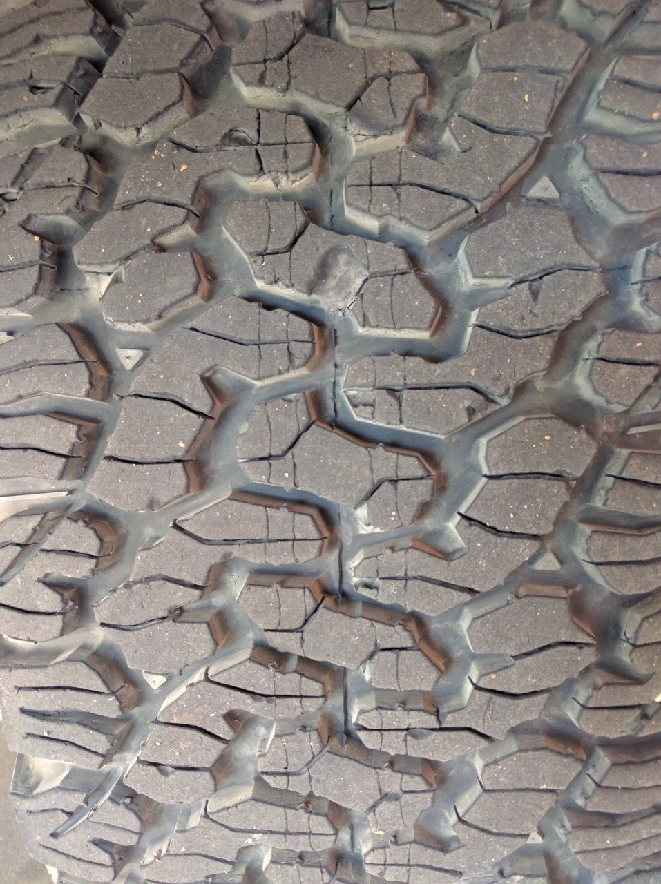

I had noticed some sets of cuts or cracks in the tread running around the tires and I originally misunderstood the cause or origin of them. A thread on MUD caught my attention and pointed out that other people had noticed these as well on their BF Goodrich All-terrain KO2 tires. I still don't know that the cause of these marks has been fully explained, but it appears to be a manufacturing related issue as BFG has stepped up to cover the condition with offers for replacement tires. So I went down to the retailer that I bought them from and asked an old coworker there to call BFG and check on the issue. I had about 10K miles on the tires with fairly hard use and good maintenance, I had already replaced one tire through a road hazard, so they were not all purchased at the same time. My friend said that it looked like a cosmetic issue only and made the call relaying that information. He told me that BFG offered to pay for a large portion of a set of 5 replacements. It is nice to see BFG stand behind their product and take care of the issue. I wasn't really worried about the condition, but I don't want to be running tires that might be defective either so I was happy to pay the difference and move on with a brand new set of rubber meats. Overall, I have been really happy with these tires and it will be nice to go into winter with a new set.
This is what the old tires looked like.
And here's the fresh new boots.

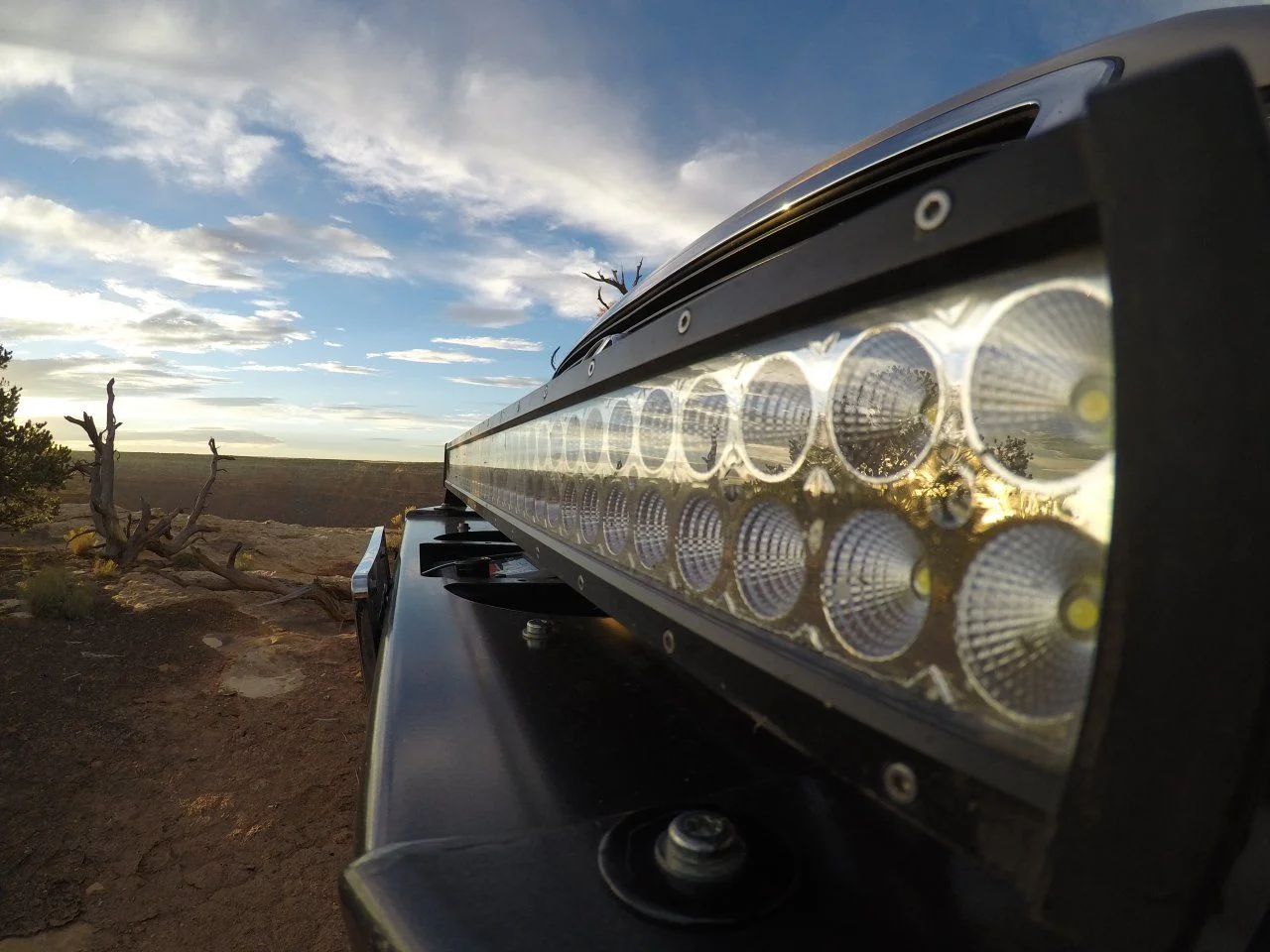

I noticed a bit of condensation in the led light bar so I resealed it.

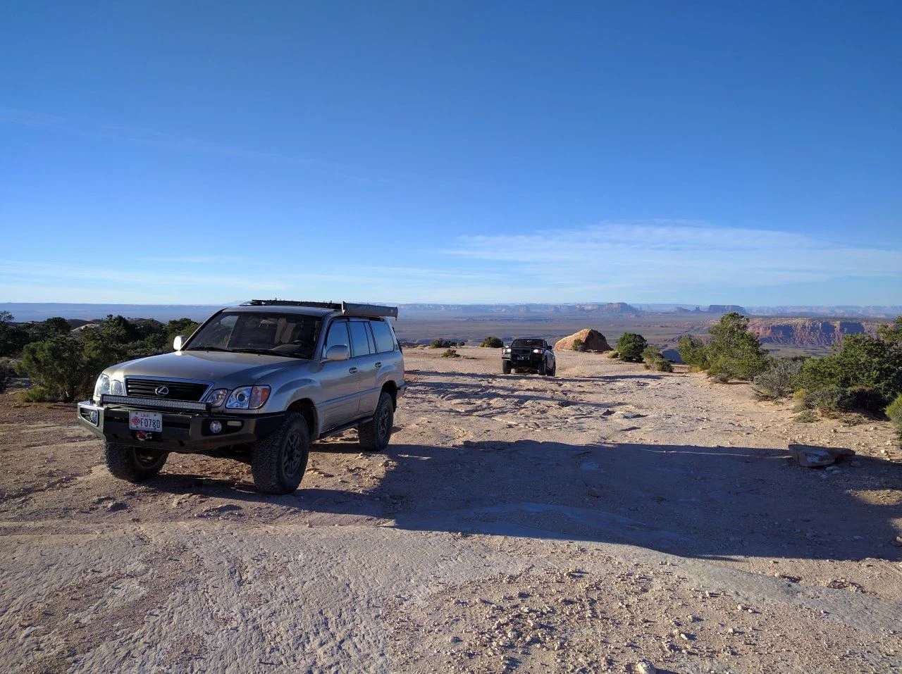

We went down to Moab with a group from Wasatch Cruisers. Its become a reoccurring trip over the years as it seems to be a great time again and again.

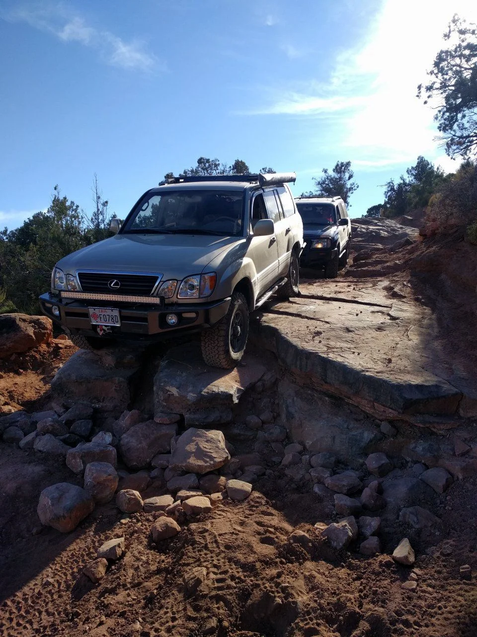

@nnnnnate led us out on Jax Trax and I tail gunned.

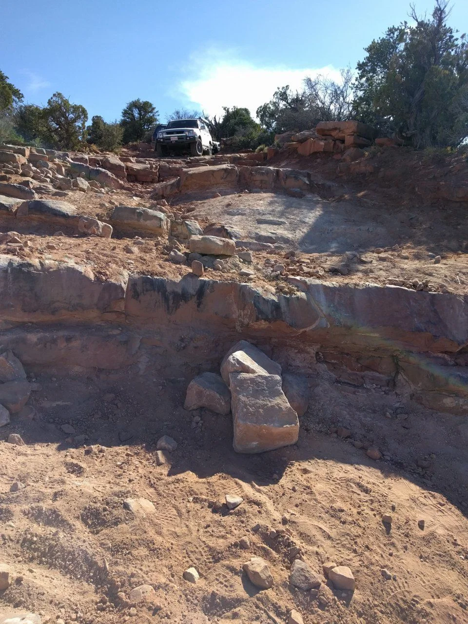

rock crawling

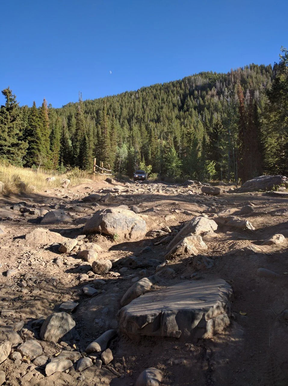

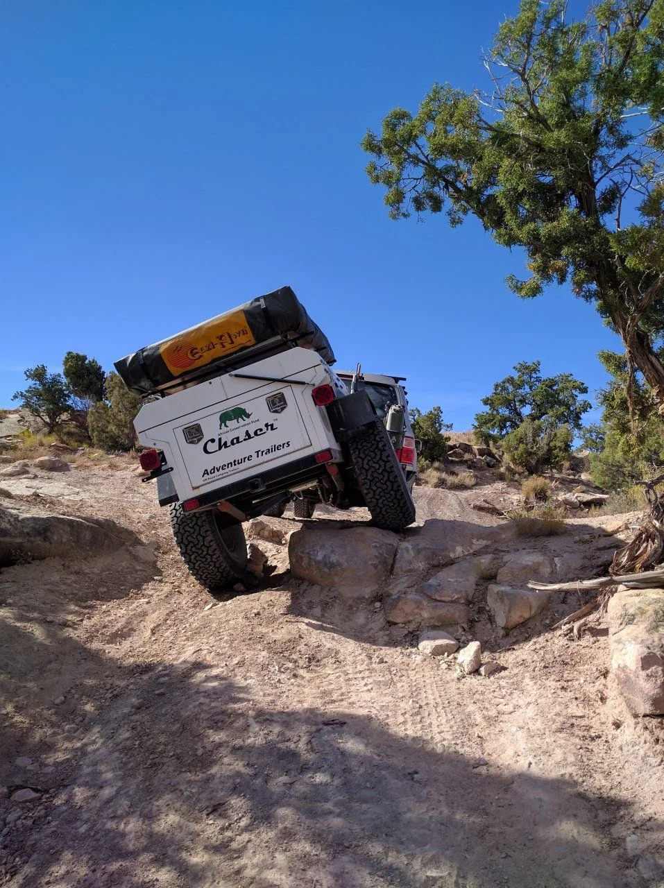

I spent some time testing out the trailer flex as their suspensions work much differently than on the tow vehicle.

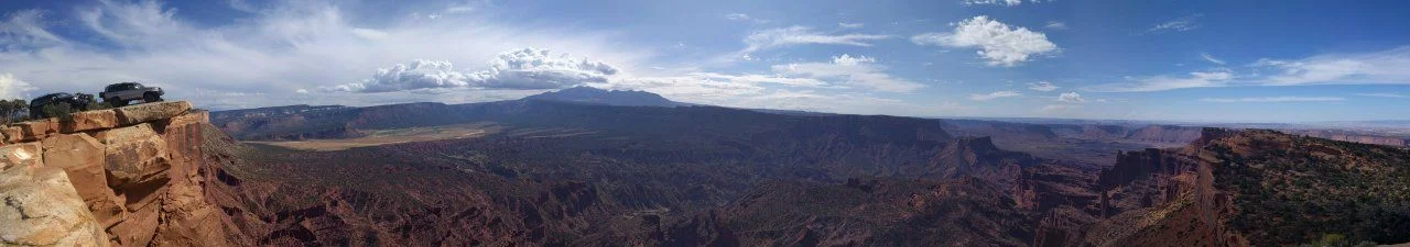

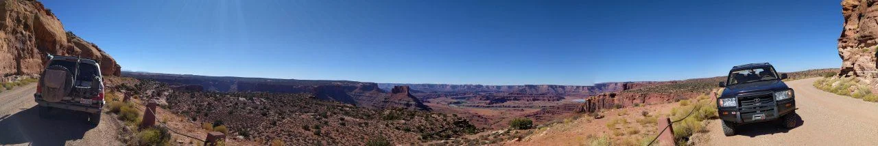

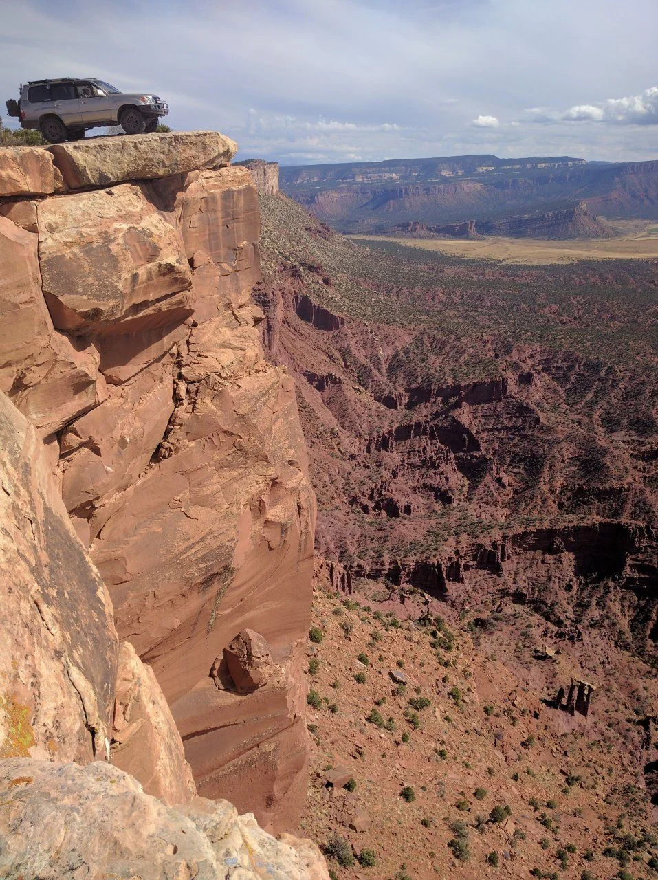

I recently spent some more time exploring south eastern Utah with another friend in our 100 series. It was incredible to cover so much ground and to see such amazing sights. Its awesome to have vehicles that can excel in so many areas allowing us to get out on the edge and behold adventure. I keep thinking of how much there is to see and do that I am constantly looking at more trails and areas to venture out to see first hand and share with others. So I'll continue with less talk and more pictures of the spectacular places that my 100 series reaches.
Those are great pictures Scott! They make me real excited for the upcoming trip and make me think I need to do a better job taking pictures while I'm out exploring.
Thanks @nnnnnate . I am very excited for the upcoming trip as well. I often forget to take photos at social events because I get distracted visiting. I keep thinking that I need to take more & better pictures but on this trip I could not resist and it was so spectacular that it was easier to get a good shot. No fancy equipment needed. These were all taken on either the GoPro Hero5 or my Nexus 6P phone.
