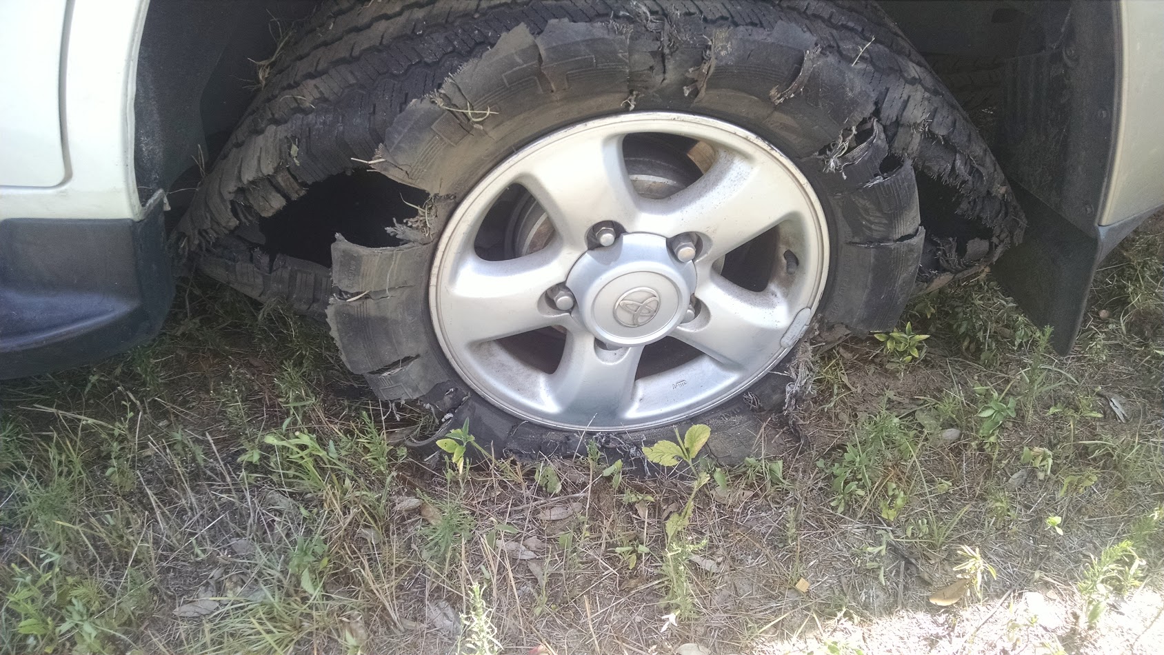

2001 LC100 shakes and Steering wobbles on hwy, resulting in a bizarre tire explosion

fyi - the toyota advisor and tech were suprised to see the state of the falken tire given fairly a new tire. The front blow-out took out the speed sensor and some wires. The shop is waiting for parts and will put the lc100 on the rack for a full alignment before test driving. I should get the lc100 back next week. I'm now shopping for new tires - looking at toyo at2.
The michelin 275/70/18 rear tire was at 40 PSI and the blow out/damage was contained at that section, probably given it is an E-load all terrain tire. The 2nd blow-out falken 275/70/16 front tire was at 35 PSI and the blow-out ripped bald the entire tire, probably given it is a passenger tire. Here are the pics of both tires.
