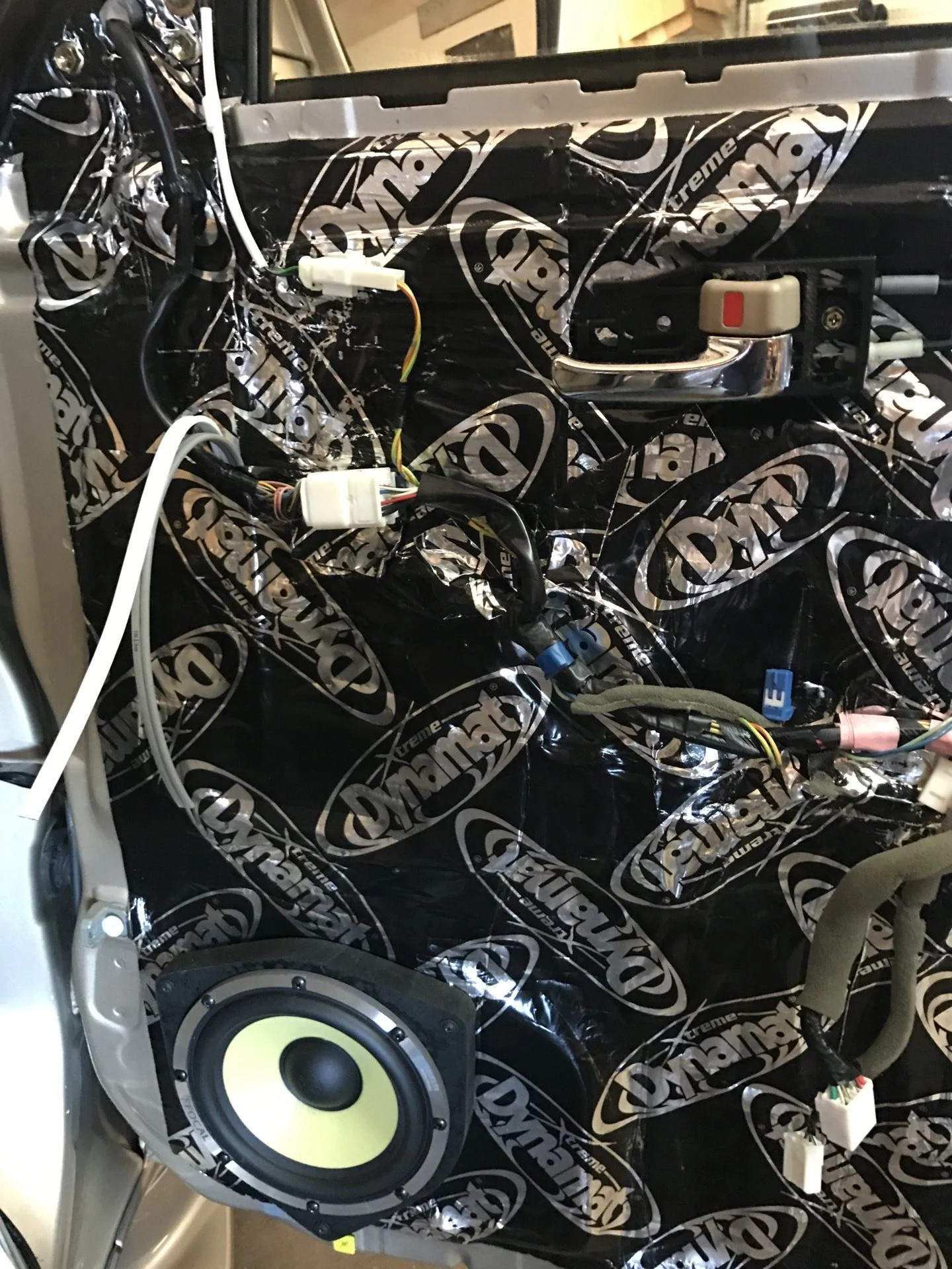

How about the front doors, did you need shallow mount speakers or did you just use standard speakers with spacers?
I used some real deep Focal K2 165KRX3 and custom sized spacers. They are as deep as you can physically fit in the front doors and keep the OEM grilles.
