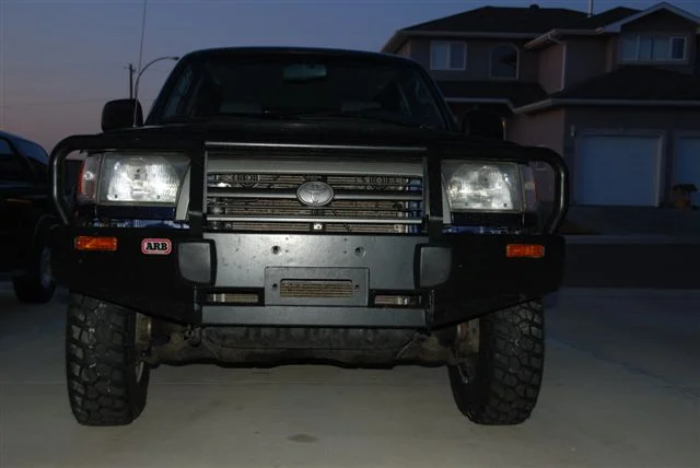

On my 96 I ran a set of LT235/85R16's Michelin LTX M/S for a long time..32 inch tire by 9.5 wide I think they are. Load Range E 10 ply.The extra height offers a bit more clearance on the trails..
.. but then I chose a set of BFGoodrich MudTerrain KM2's LT245/75R16 for better traction. I really considered a taller tire for clearance but chose the smaller tire because our 96 has the 2.7L engine and the mountains are a 3 hour trip down the highway from home here. I am really quite surprised at how quiet these are on pavement for the lugs that are on them and they bite in the dirt great. Obviously ice road traction will be compromised. That's why I bought an extra set of steel rims for the KM2's and put them on when we get away from the pavement :)
No 1 tire does it all....
