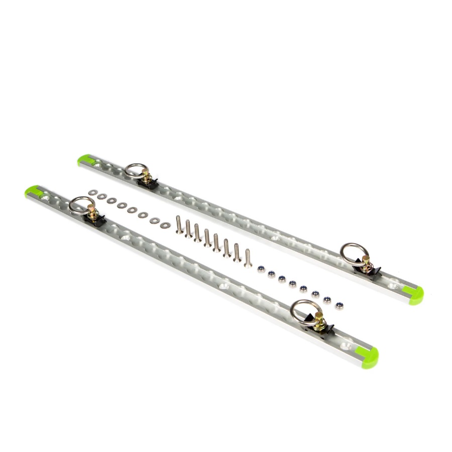

I'm looking to add more flexible tie rings to my 200 cargo (3rd row removed).
The idea is to have some kind of aluminium tracks with movable anchors so I can modify the exact loaction of each ring based on the items I need to secure.
My goal is not to drill in the car floor and use the original rings screws and 3rd row floor hooks to secure the tracks.
Would love to get some ideas, tips, pictures, and products if any.
To give an idea of this project i'm attaching a link for a tracks product:
many thanks,
Aifer.
Ideally you could bolt tracks to the seat bracket holes but as you know they aren’t parallel front to back.
If you pull up the plastic garnish around where the seats latch to the floor you can access the bolts there. This is where most third party drawer systems anchor to.
Otherwise pull back the carpet and drill though. If you drop your spare there is lots of room to bolt something down from the underside.
one idea might be to make a false floor made of plywood, bolt that in using the existing cargo tie downs (might need longer bolts); then bolt your l-track/airline track to that?
