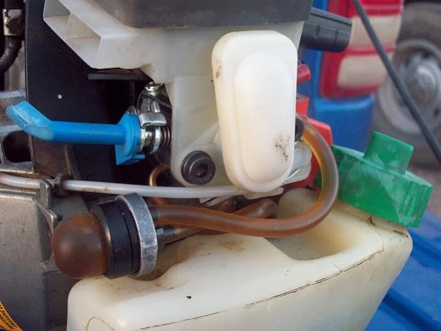

That's it.. I brought it to work with me, just went out to the truck..Guess what, it runs fine this morning, which is starting to make sense. If you notice in the pic, there is a fuel line that feeds the carb (LH side), and a return line that goes from the carb to the priming bubble. The return had air in the line yesterday afternoon when I pumped the bubble, this morning it does not.
I think my fuel line is getting old and allowing air to enter around the feed barb when it gets warm.
What do you think?
Your fuel lines look good. Inside of the primer there are two check valves. If debris gets caught in the check valve it will hold it open and the fuel will blead out.
If you problem was that is runs awhile and dies, I would say check the primer to see if there is fuel in it. If there is no fuel, then one of the check valves is stuck. That is not your problem.

Before the priming bubble ruptured, I guess there was a hairline crack in the base of this that was sucking air.
