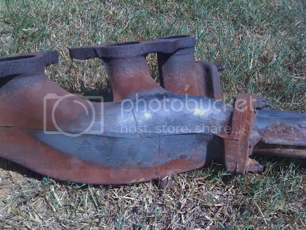

I ordered the Pacesetter plain paint vs. the thermocoat or whatever they offer for another $100. I stripped it with some Aircraft Stripper (had some on hand) and aircraft stripper is like none other. It boils in 95 degree weather and the burning sensation on the skin is like napalm. After I got it stripped I couldn't get the stripper off. So I then took it to the carwash in a plastic bag. Cleaned it up there and again at home. Then I hung it up and rattle canned it with some header paint, flat black. $205 for header to my doorstep and $8 for the paint. Not too bad as long as this thing holds together. All the welds looked good when it was stripped so it should.
I noticed no increase or decrease in performance, but it doesn't have that 'ticking' sound like the cracked manifold made that drove me crazy. It has a little grumble under the hood during hard 'acceleration' though. And the sound at the tailpipe is the same. The flange for the EGR was off slightly, but I was able to pull the EGR pipe over with my floor jack hande and get the bolts started. Also, I couldn't remove to reuse the bolts for the EGR and precat O2 sensor. I just so happened to have 4 bolts in my toolbox that were 8mm that I had jacked off of my drilling rig. I had to cut them down to make them short enough to work. It's good to be a random bolt klepto.
I did the install at night, finished around 10:30. I took it for a test spin and got a CEL before I left the driveway. I figured it was from the paint getting heated for the first time so I gave it a real good 'spirited' drive for about 15 minutes to burn off whatever and make sure that whatever it was didn't imbed in the cat without getting incinerated before returning home. I disconnected the battery and when I hooked it up in the morning and fired her up, no CEL.
So here it is. All the tubes are different lengths.
Next to the cast one, it does look more efficient.
It's kinda hard to see in the iPhone pic, but there's 2 hair line cracks, and a 3rd larger one that you could actually see open up when you work the throttle.
and the underside of it
It looks like it's real close to the fire wall, but it's just as close as the OEM manifold was.
I kind of like the way that looks. Do you have before fuel numbers to see if you manage better mpgs with it?
I have 33s and a fiberglass camper. I'm hoping that the poor mileage I was getting with the cracked manifold was due mainly to the cracks. And not so much tires and camper.
My before mileage is terrible. I'd average 14-16 interstate driving. I'm still on my first tank of gas since putting this header on. Two of the three gaskets that Pacesetter sent with it have already blown out. The one against the engine is still intact. I've replaced one with the OEM one and had to make the other.
