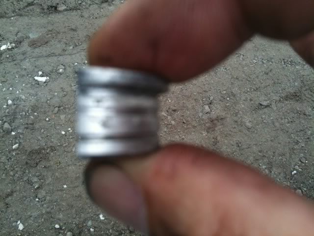

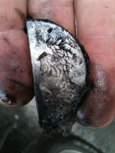

At the back of the head is a semi-circular hole - there is then an insert which sits in it. This insert is about 1mm too shallow, hence the 1mm depression.
Photo here - you can see the lip of the head, and the semi-circular cut-out:
Here is the insert:
Another shot:

The semi-circle cutout will likely be for line-boring the bearing seats. Standard practice is to use sealant around the insert although 1mm seems a bit deep. Maybe a new insert is a good idea.
Just clean it up and float it in with a bead of sealant.
Keep the top edge flat with the top of the sealing area for the tappet cover.
Allow to cure then install tappet cover and new seal.
Other manufactures incorporate that cutout seal into the gasket.
Some use rubber 1/2 moons and in this case its an alloy one.
