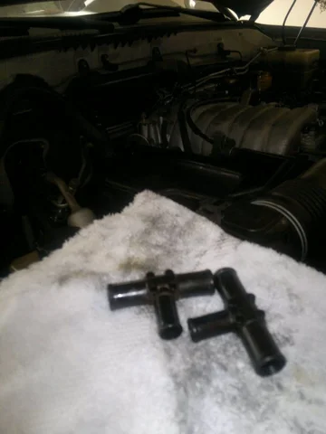

Changed the Ts and hoses for peace of mind. Old ones are still in good condition at 174,000 miles. Must have been the coolant changes over the years. Ya never know. 2015-02-25-1440.webp
Replace tees, clamps and all heater hoses at the same time. Cut off the old hoses carefully rather than trying to pull them off and damaging the brass connections. PITA but will be good for a long time with no more concerns. It would be nice if you had a third arm about 18" long to help out.
^^That is what I did on mine. Slice the hoses and peel them off the connections with a screwdriver.
