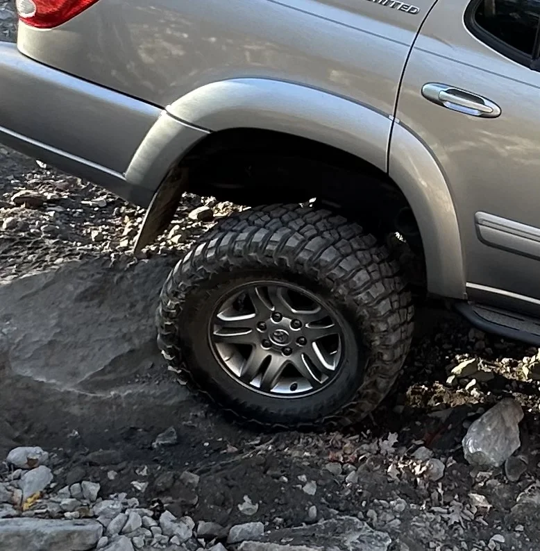

Hi all,
Searched a bit but struggling to find information regarding rear sway bar delete. I have a 2005 Sequoia with a 3” lift and 33” KM3s that is not my daily driver. I’m contemplating removing the rear sway bar and would appreciate anyone’s experience in having done so.
From the info I have found, it does appear removing the rear sway bar significantly increases articulation although would love if anyone has any numbers on connected vs. disconnected.
Also, is anyone aware of a quick connect/disconnect for the 1st gen rear sway bar? From looking under the Sequoia, it looks like they the links would be tough to get for a connect/disconnect feature. I had quick links on the front of my Bronco and that was a pretty easy process to disconnect/connect at the trailhead.

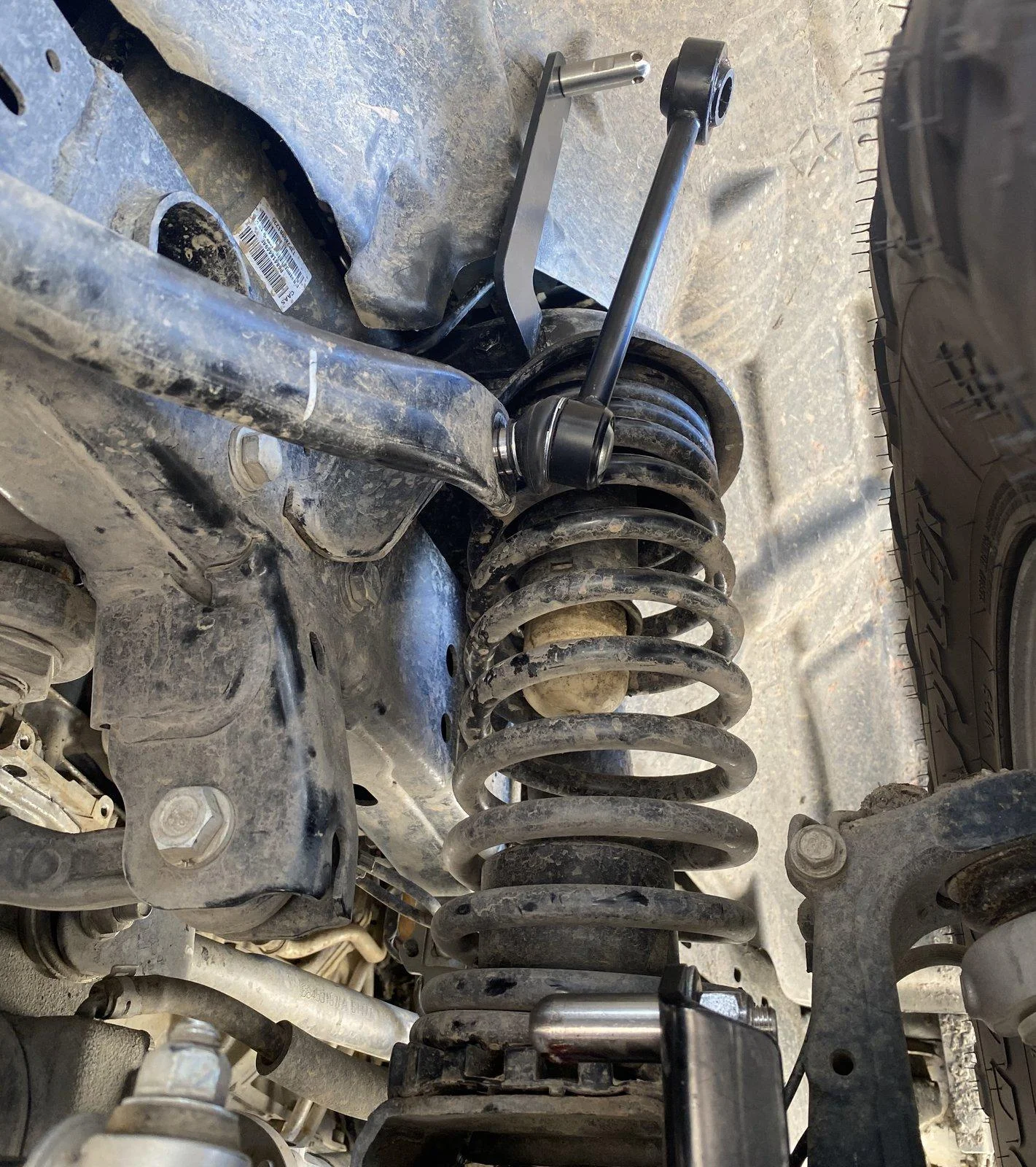

Hi all. Thanks for the responses. Back with follow-up questions. Today I removed 1 sway bar link.
Is there any added benefit of moving both links? If I’m thinking about this correctly, it seems like removing one side would provide the same flex as disconnecting both sides?
Am I correct in assuming that removing 1 link would provide the same flex as removing the entire sway bar?
Reason for the questions is I had new sway links installed yesterday, so taking them on/off is now pretty easy and I’m thinking I can disconnect/connect for on road vs off if Im getting the full flex with the bar in place and just disconnected.
Thanks,
1 is fine as long as it won't hit any other suspension components. The bar will move up and down with the side its connected to and you could end up in a situation where the connected side is at the bottom of its travel and the opposite side is heading towards the top. If there's clearance, then should be ok. Otherwise, people will disconnect both sides and set up a mechanism to rotate the bar out of the way and pin it in place to hold it.
This is the image of a Jeep setup:
Grabbed the image from the following link: School me on sway bar disconnects. - https://www.jeepgladiatorforum.com/forum/threads/school-me-on-sway-bar-disconnects.30126/
