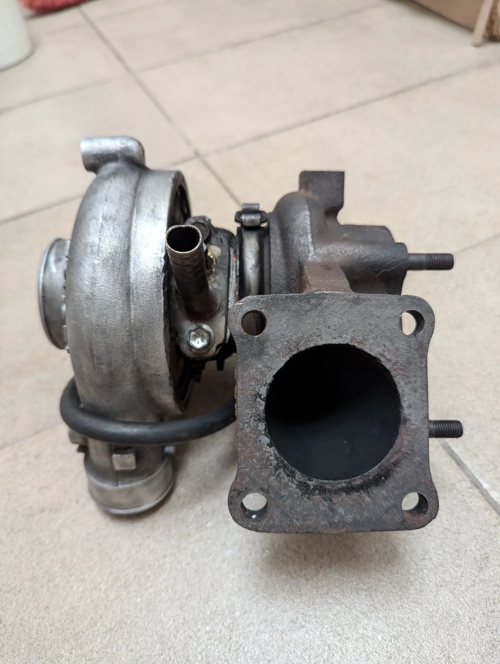

Recently acquired a 60 series that had a swap to a 1HZ. The PO also gave me a turbo that I think came off the original 2H but that could be used with the 1HZ. Would you do it? Pros/cons?
Based of 1 pic, turbo looks like it is an original turbo from a 1HD-T 80 series.

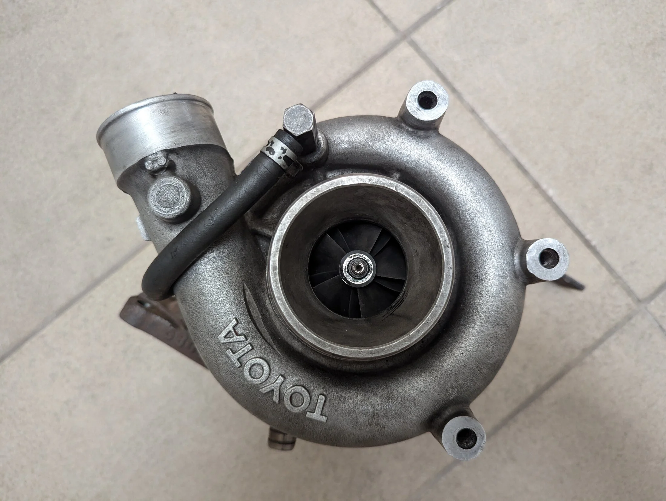

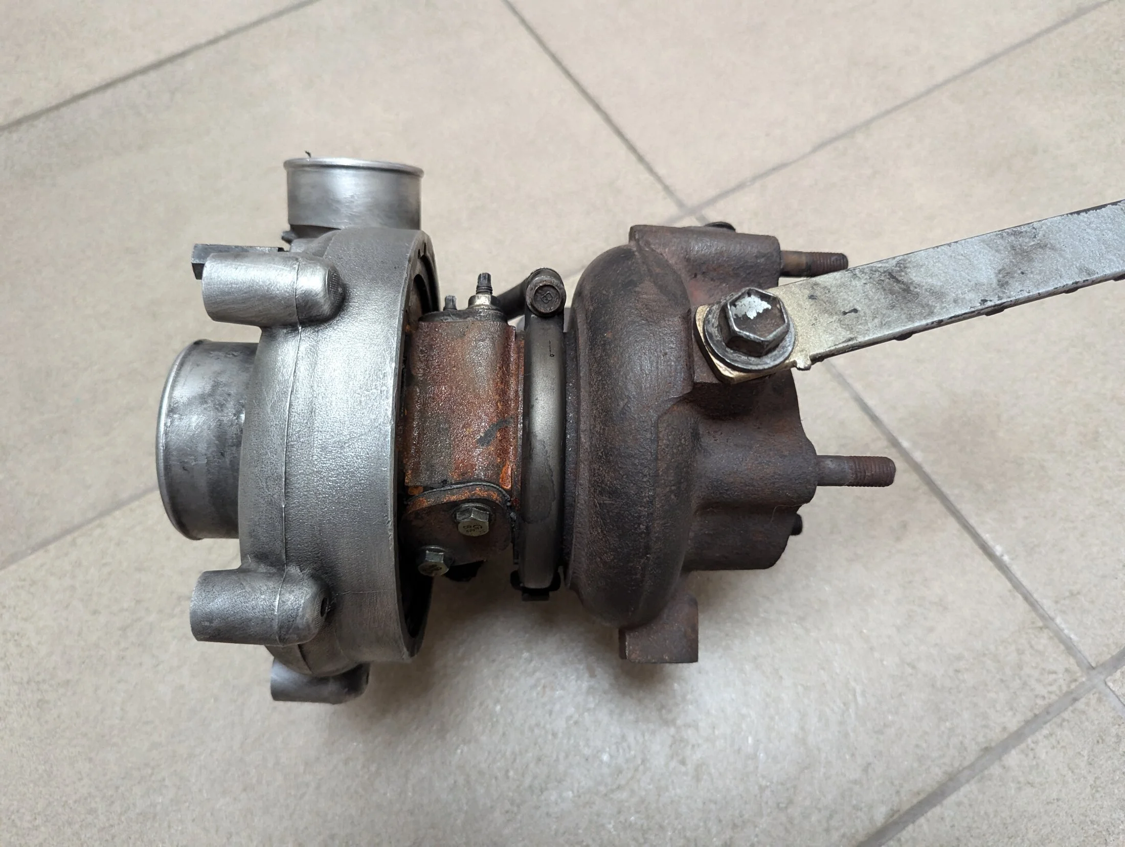

Post more pics.
I don't think a 2h ever had a turbo fitted by Toyota.
If it is a CT26 for a 1HD-T, it will work pretty well on a 1HZ. There's better options, but it would certainly wake up the 1HZ

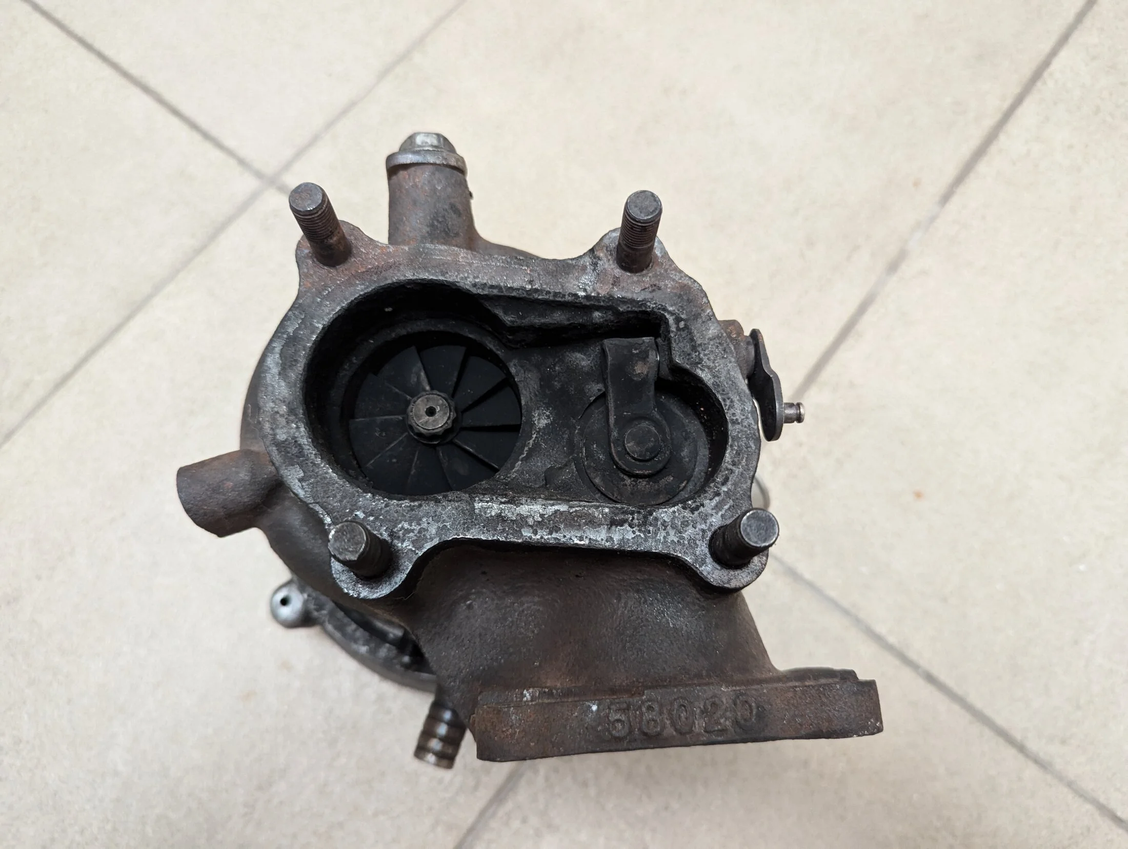

Based on the casting number on the exhaust housing, it's a turbo for a 1HD-T.
I think these are also used on 1HZ powered Coaster buses in South America (not certain of that)
I agree. It's a CT26 likely from a 1HD-T
