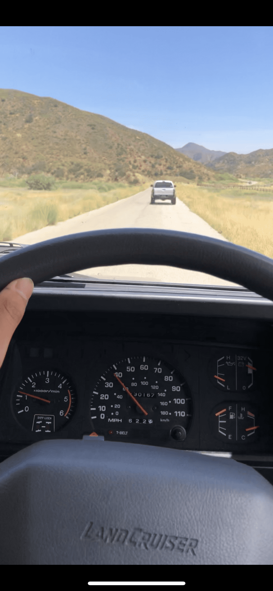

my thermostat reading stays below the half line after warming up and reaches half or higher when going up steep inclines but I’ve observed another HZJ73 and it stays at the half line after warming up, does my thermostat need replacing or which one is reading correctly?

1/3 is the sweet spot for 1HZ and most old 70s. This is about 175F which is probably what your thermostat is at, that other truck may have had a hotter thermostat.
It will get to 1/2 when going uphill, try not to go past that. 1HZ lug up hills and heat up fast.
1/2 on the gauge is about 190F
Valuable info and I was hoping for that answer, saves me time haha, but was willing to replace thermostat, fairly inexpensive.
In my previous post i mentioned how 1HZ was extremely slow up steep inclines and thats really the only time i manage to go up the half mark, think i should be ok in cases as such?
Thats not the "thermostat" reading. The thermostat is a device in the lower coolant inlet that opens or closes to let coolant flow.
You are looking at the temperature gauge.
Its ok to let it go to half or even if higher if you keep it out of the red. In good order, they can handle 120c for long periods.
Steep inclines need a lower gear and rpms around 2500-3000. It maybe slow but it will not overheat.
