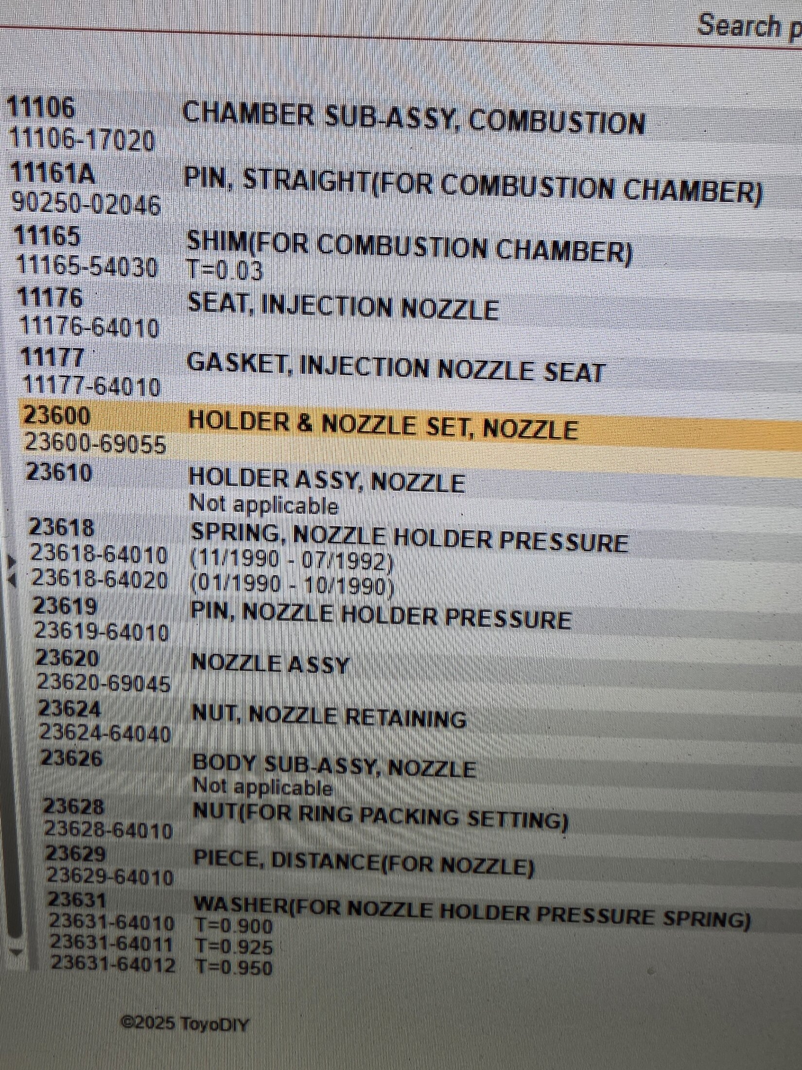

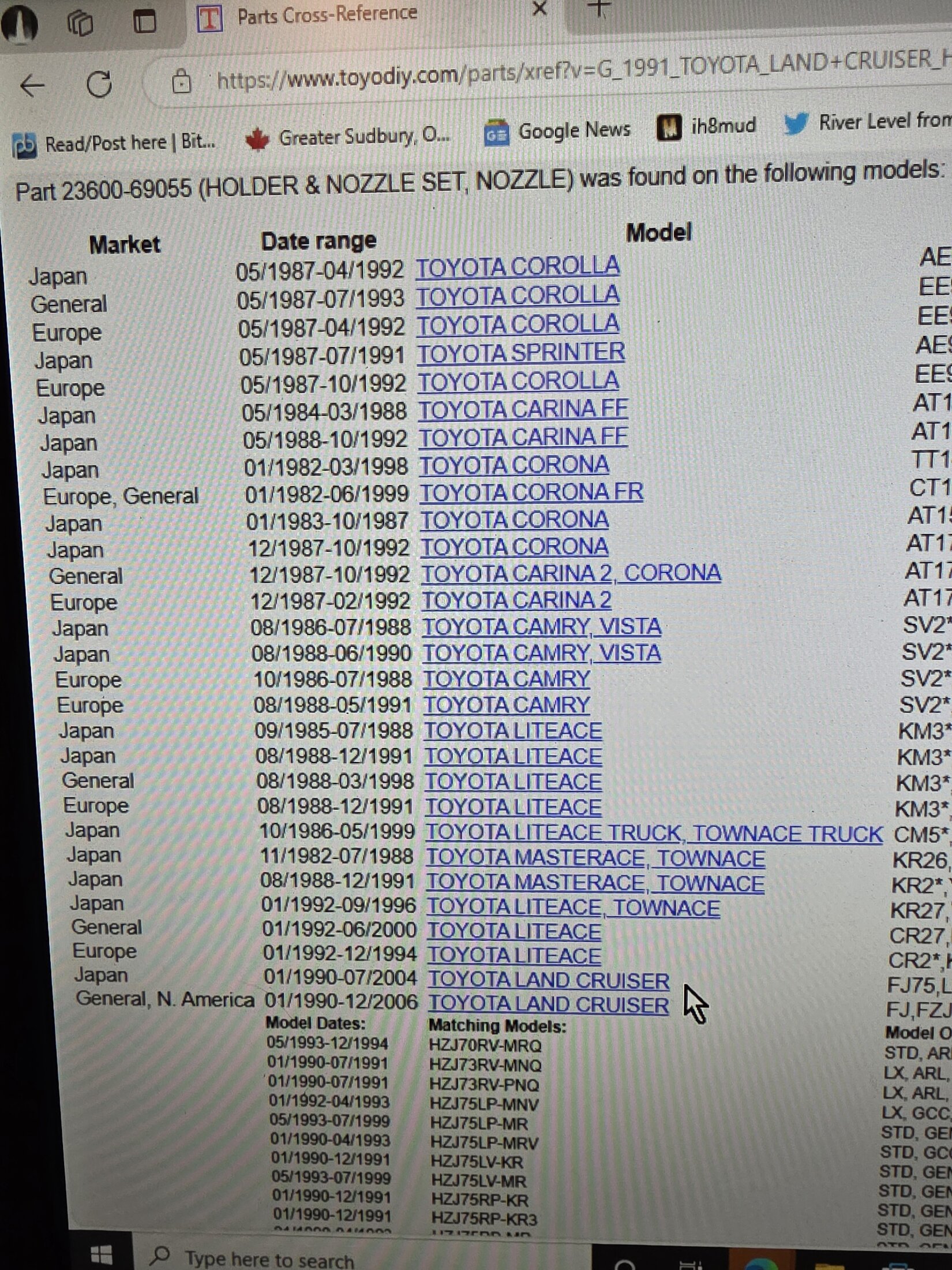

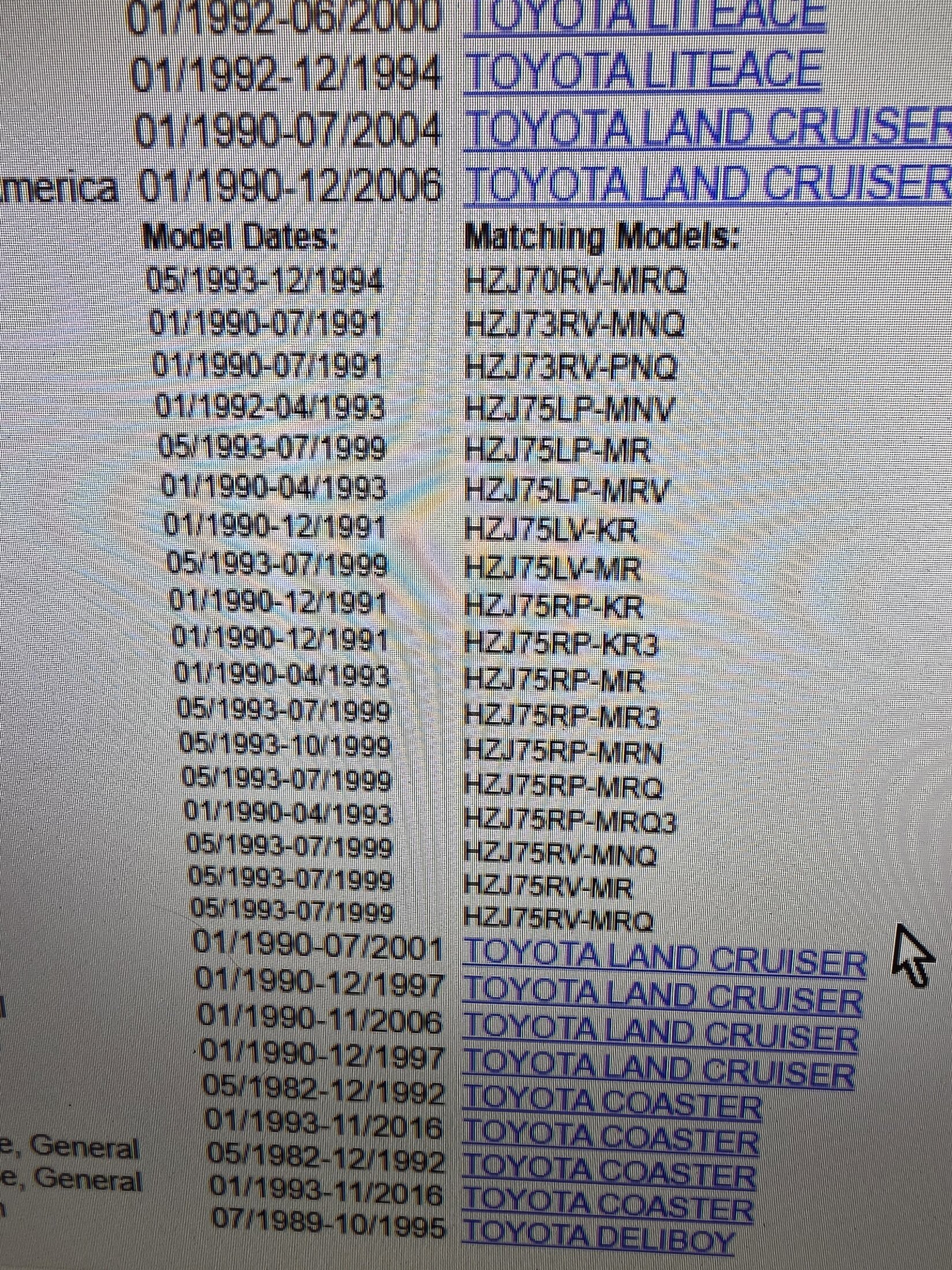

I found a PDF with injectors/nozzle for various Toyota models as reference.
