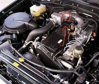

Blue oil is burning engine oil.
Check the hoses going to the map filter and map sensor at the back of the manifold
