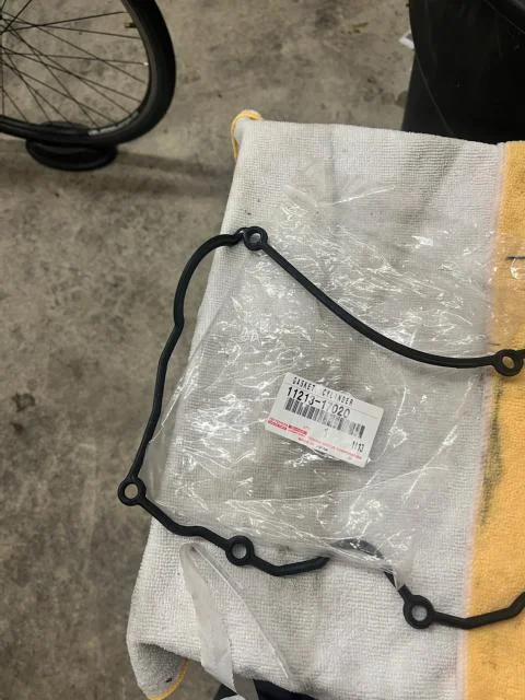

Hi All,
Ordered a new valve cover gasket for a 1995 Non-EGR 1HD-FT 80 series. I am thinking there must be a couple of variations in how the cylinder head cover / valve train cover was drilled by Toyota, as the gasket supplied for the chassis number via PartSouq does not match the cover on the 80. Does anyone know what I should be looking for in terms of a part number, or perhaps it is discontinued and I need to buy aftermarket from Aus (located in US).
First, the gasket and p/n ordered from PartSouq. This number seems to pop up wherever I put in the year/make/model or the chassis number as correct, but clearly it is not. Notice the two holes, one by the cam journal corner and the other only on the far injector side corner.
Here is the actual hole pattern on the 80 series- it has 3 holes in the same location:
Other difference was the number of hole on the exhaust manifold side of the gasket; there were two missing on the gasket supplied. All of the injector side holes matched.
The gasket did fit in the groove, but it was a funky fit particularly on the rear exhaust side holes by the firewall. I didn't trust it enough to run it as it would be putting bolts past gasket that did not have holes cut for around the groove.
Maybe it's supposed to be this way as a redesign? Doesn't seem like it, and the gasket current on it did have all the holes for it. It has a slow leak, but nothing concerning. I was in there to tap a hole for the EGT so I figured I'd replace it at the same time, along with crossover tube gaskets.
Online I did find some aftermarket gaskets that appear to be correct, but the Toyota OEM ones I've found look the same.

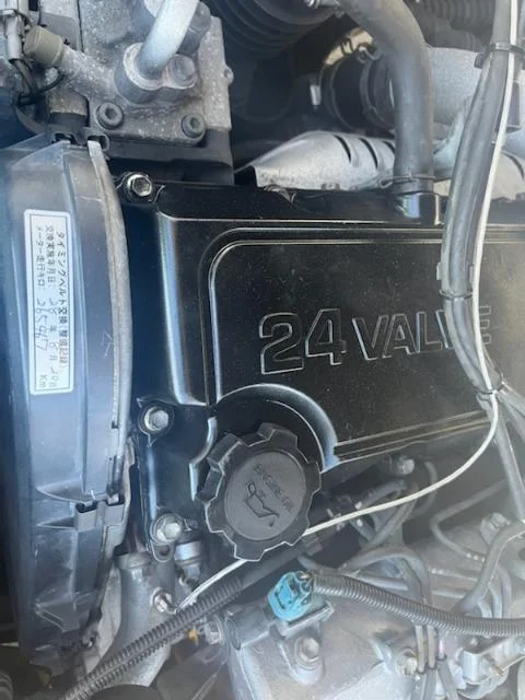

I have a 97 HDJ81V w/ 1HD-FT engine with EGR. Ordered the same gasket and it fit my valve cover perfectly. By the Japanese writing on the timing belt cover I assume that you have an HDJ81, but could it be an HDJ80?
I also noticed that you don't seem to have an intake heater... is it just not in the photos?
Yes, it is an hdj81. Also, it does have the glow screen; just not pictured I suppose.
Seems to me you may have a Yanmar VC gasket. The Yanmar is the FTE configuration but with the FT VC. The FTE has more mounting holes vs the FT for the VC.
Cheers
Cheers
How totally odd! Thanks for the reply Ian. Would you happen to know a P/N? Or can I just use any FTE gasket- non-marine or otherwise?
Any FTE should work. It was an update Toyota did from FT to FTE.
Cheers
Also, what it says to me is your head has been replaced at some point. FTE head is still available while the FT is not. As a bonus whomever did it got the Yanmar VC. The Yanmar VC is not cheap at all too.
Cheers
Hey Ian. Do you have the P/N for the Yanmar valve cover by any chance?
Cheers
I never updated here, but this is certainly the case. An FTE gasket is great.
