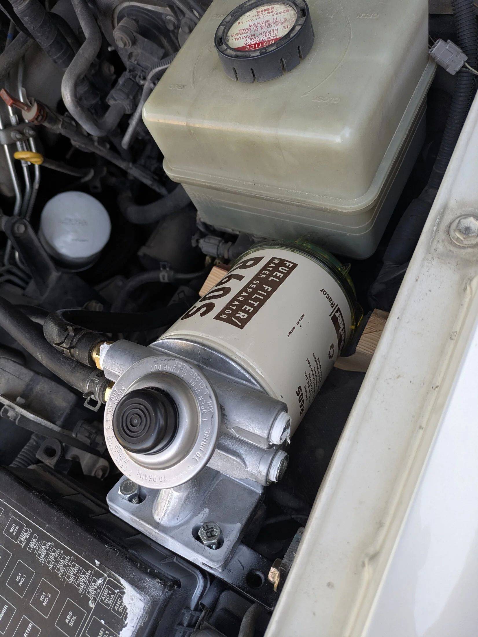

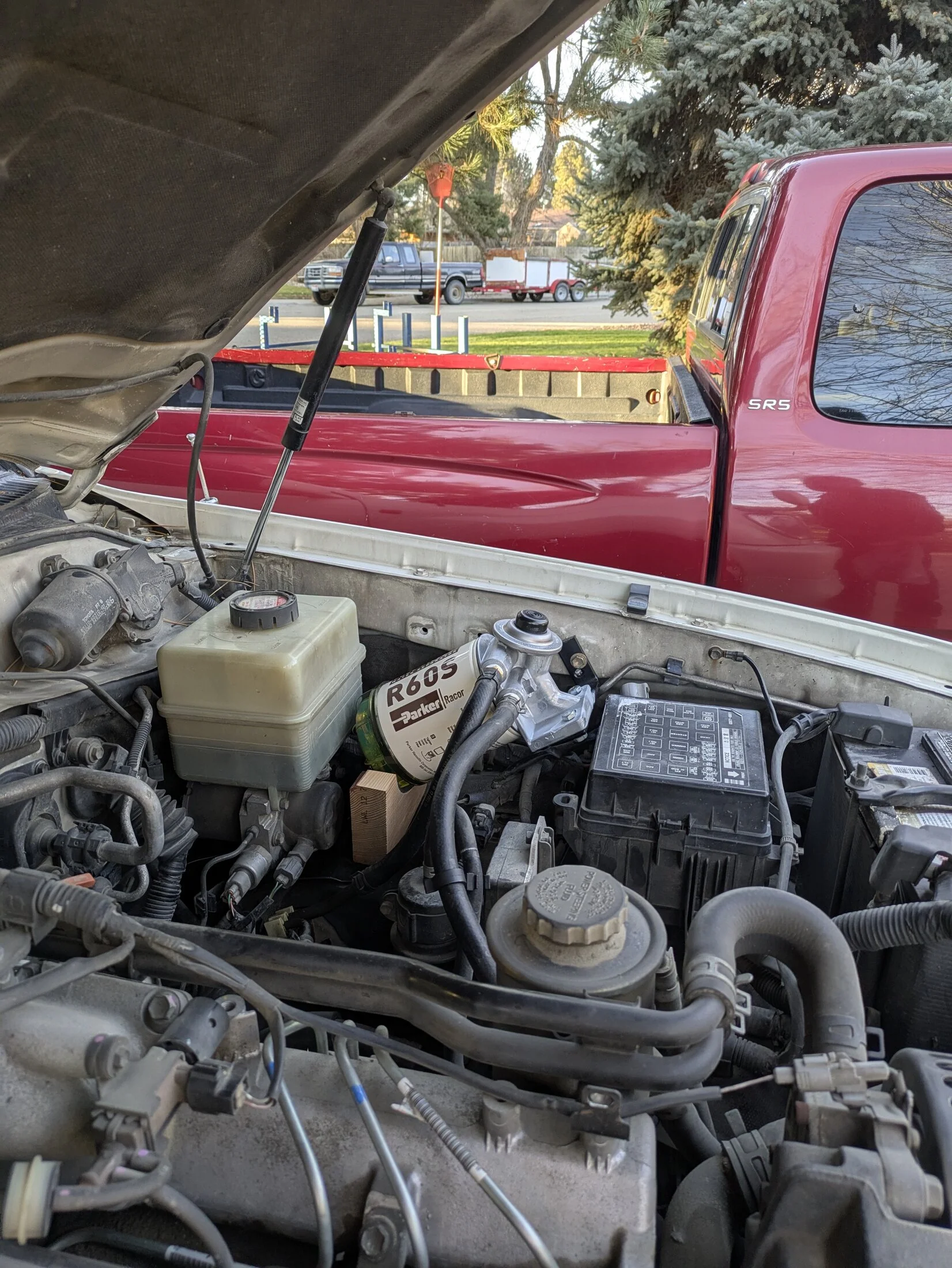

Answer: yes. Racor. Bit of a hack job but it works
