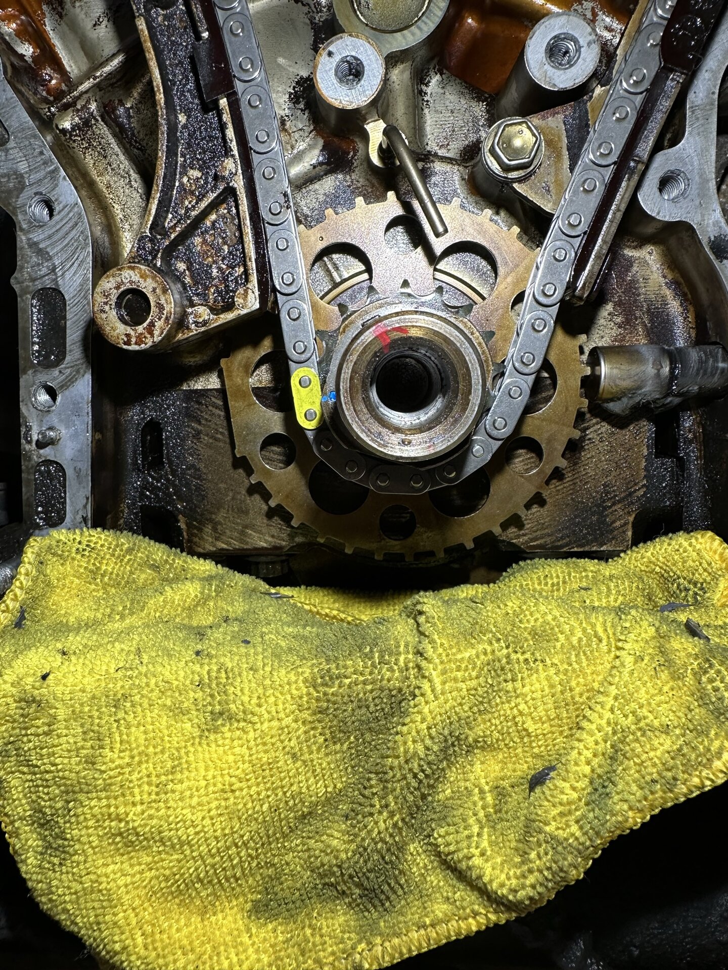

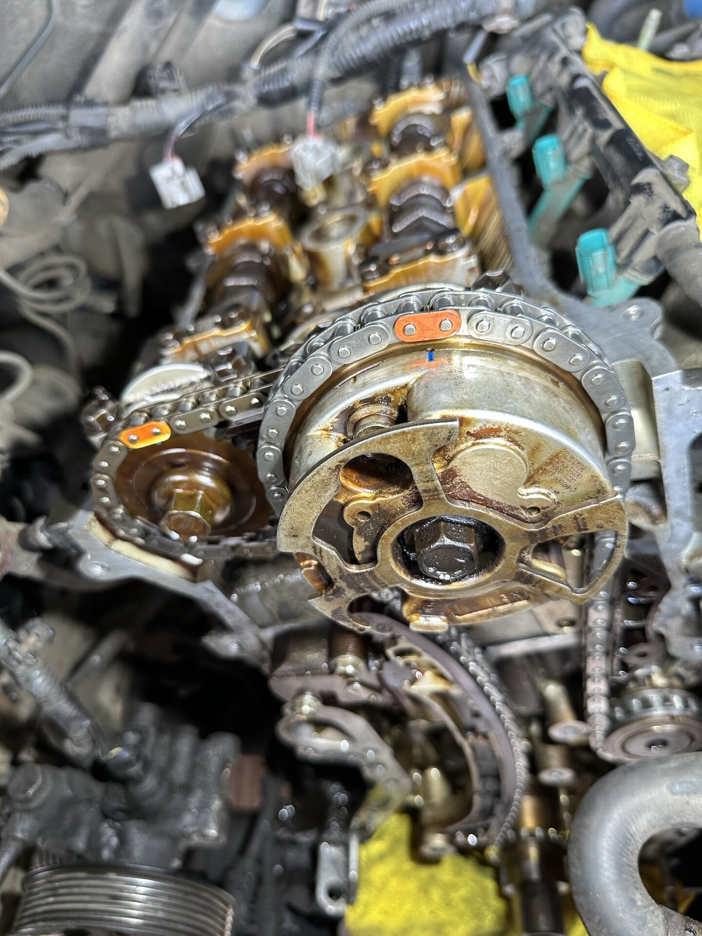

I recently did the head gasket on my 2007 FJ Cruiser (1GR-FE). The engine starts really rough and doesn't sound good while running.
The vehicle gave these four codes:
P0011 - Camshaft Position, intake/left/front, bank 1 - timing over advanced/system performance
P0335 - Crankshaft Position Sensor - Circuit Malfunction
P0016 - Crankshaft position/camshaft position, bank 1 Sensor A
P0340 - Camshaft Position Sensor A, bank 1 - Circuit Malfunction
Could I get some eyes on my timing. I checked everything and was super careful when putting the camshafts and the new chain back on. Here are some photos.
