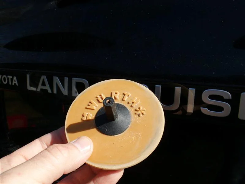

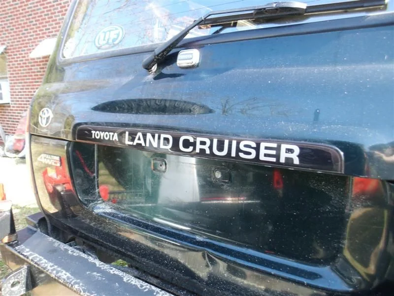

First off, not really motor related, but my rear emblem was broken in half and the half remaining was just dangling. So, i replaced it with a new one. The only issue with replacing this emblem is the leftover goop from the old adhesive. Luckily i have a friend that owns a body shop, so he dropped off this neat little "eraser" that mounts onto a drill. It will take the sticky crap off without removing the paint.
The new emblem sure is pretty! :grinpimp:

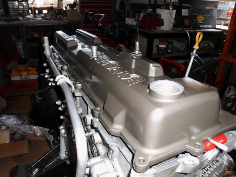

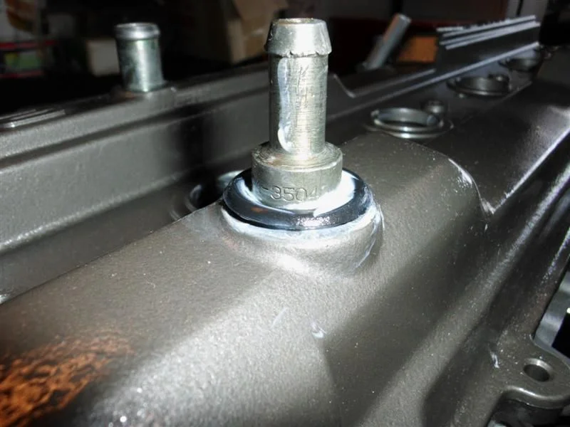

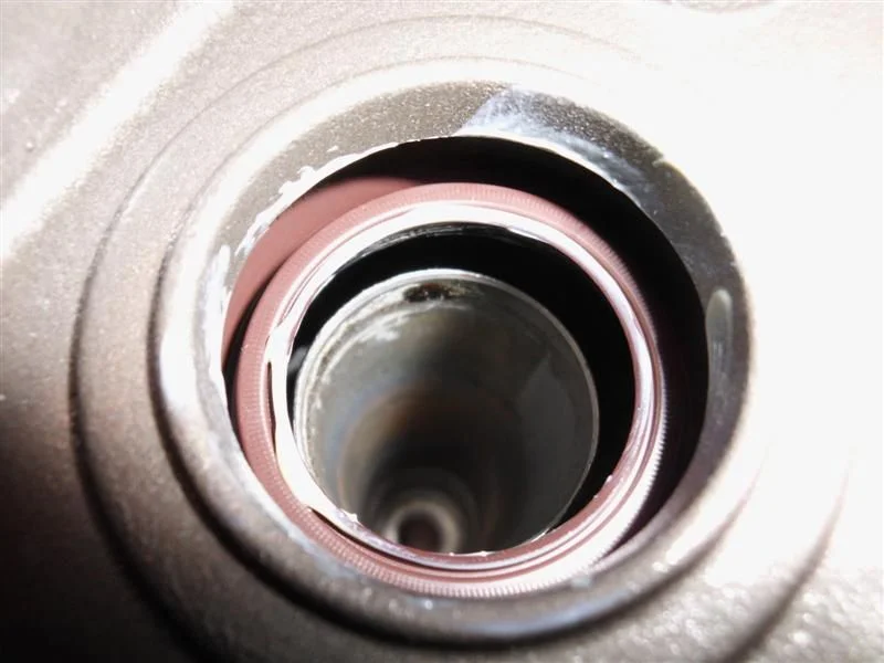

then, i spent a little time on the valve cover. Took all the old spark plug tube seals out and the PCV valve/grommet out and soaked the thing in a parts washer for a week! Took it out and blew/sprayed everything out until it was really clean, then painted it. Then, i installed new valve tube seals and a new PCV grommet.

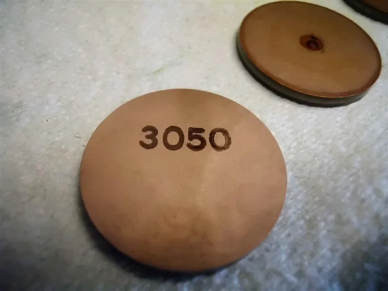

Here is where the real technical problem lies. I measured my valve clearances as the FSM details. I found a few that were out of spec. So, i decided instead of taking it back to the machine shop to "tip the valves" i decided to learn more and adjust the valves using the shims.
Once i realized which valves were out, we removed the cams and pulled the subject shims. Then, i used a friend's micrometer to measure them (you have to know the thickness to adjust). He told me it was a cheap micrometer, so thinking i may need one again some day, i purchased one to double check the measurements. Making sure both micrometers were "zeroed" out, i compared. They were both the same. So i felt pretty good about my measurements. I decided to work the math and then back up my findings using the valve shim chart in the FSM. Everything worked out so i was happy!
More sunny, nice golf days arrived so it took me a while to finally order up what i needed.
Got the parts in and was ready to get the motor finished up. Not so!

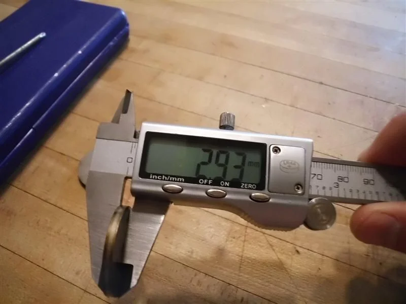

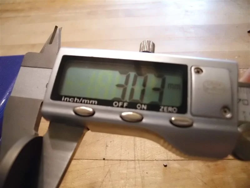

Here is the problem. You can see the stamp on this brand new valve shim. It's the thickness in MM. Here you can see the problem. My micrometer is not showing the same measurement! Not only that, now my micrometer is not showing the same measurement as my friend's micrometer. So then i took a old shim that i had measured before and now i'm not getting the same measurment on it as before!!! WTF!! :bang::mad:
the very last one pictured should measure out to 3.5 mm and look at what i'm getting!
