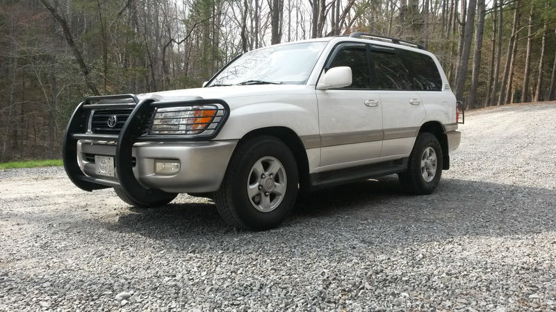

I'm looking at maybe buying another 100 and I found this one with 198,000 miles. The front looks a little low to me, maybe needs a set of new coilovers on the front or does it look normal? My 2000 was a little low in the front but not as much as this one. Just curious what you think?

Measure from the fender lip to the hub center and compare to the many data points posted around here. It should be lower in front than back by about an inch... Shocks won't change it but T-bar pre-load will.

my hundy handles a little better with a slight rake in the front... drop the running boards and the brush guard and it will look like you lifted it... to the avg joe
