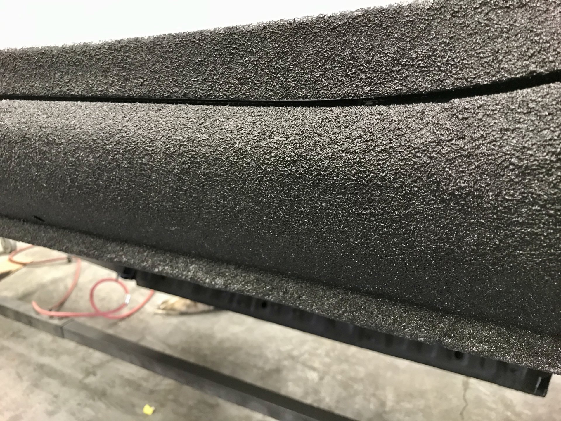

Spray on seam sealer on the rockers, this is how Toyota did their “chip guard”.
We didn’t strip the old sprayed on seam sealer from the wheel wells so we just put a light coat on top of it.

What product do you use and how is it applied? Some of the stock coating has been worn away on my 200 series rear wheel wells and I want to reapply something similar to stock.
this. i have an area where it has worn away (on an 80). also, is the wheel well supposed to be black or body colored....you know, for the concours
Toyota used a tan seam sealer. SEM sells a tan but not in sprayable form. Toyota also painted over it which we will be doing as well.

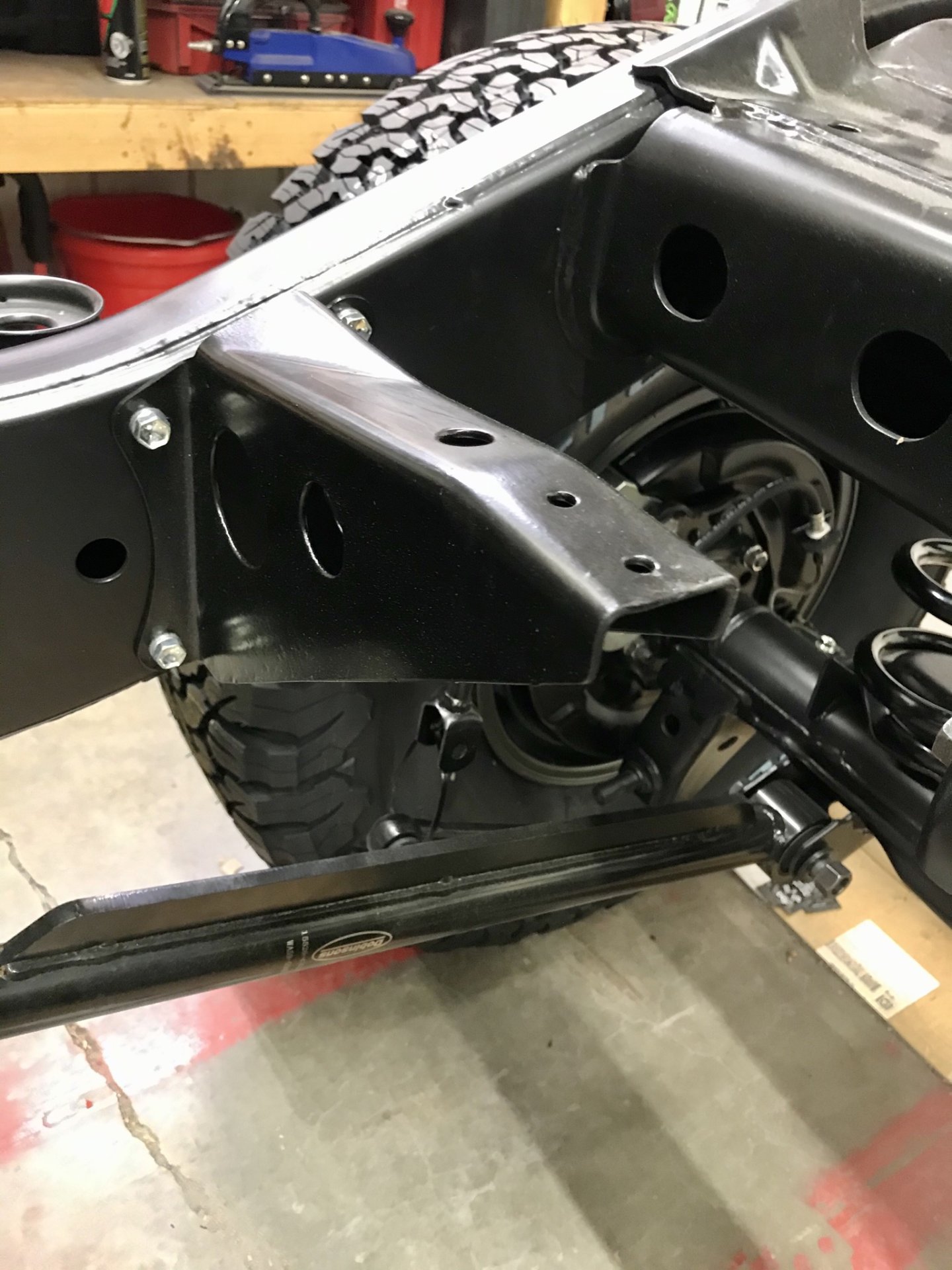

Lots o’ parts being installed.
Brake lines
A new LSPV
Dobinsons LSPV elevation bracket, chopped down to suit 2” lift.
Cheers

Bracket needed for 2” lift?
If you are doing it right, no expense spared, anytime you change the height at all you would change the bracket.
