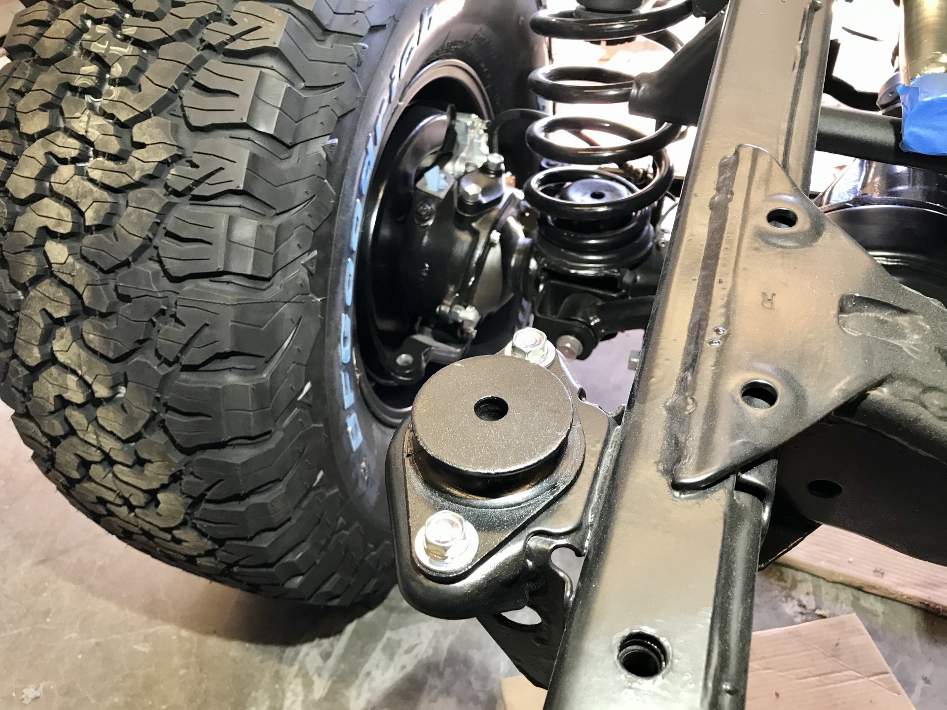

Did you buy a new factory front axle that comes with the iirc additional gusset plate for greater strength per the 105?
Stating obvious, but there is no rebuild I’ve seen here as thorough as this. 💪🏼
No, just running 105 spindles otherwise all 80-series on housing, shafts, birfs, hubs, brakes, ect. Even retained the stock gears.

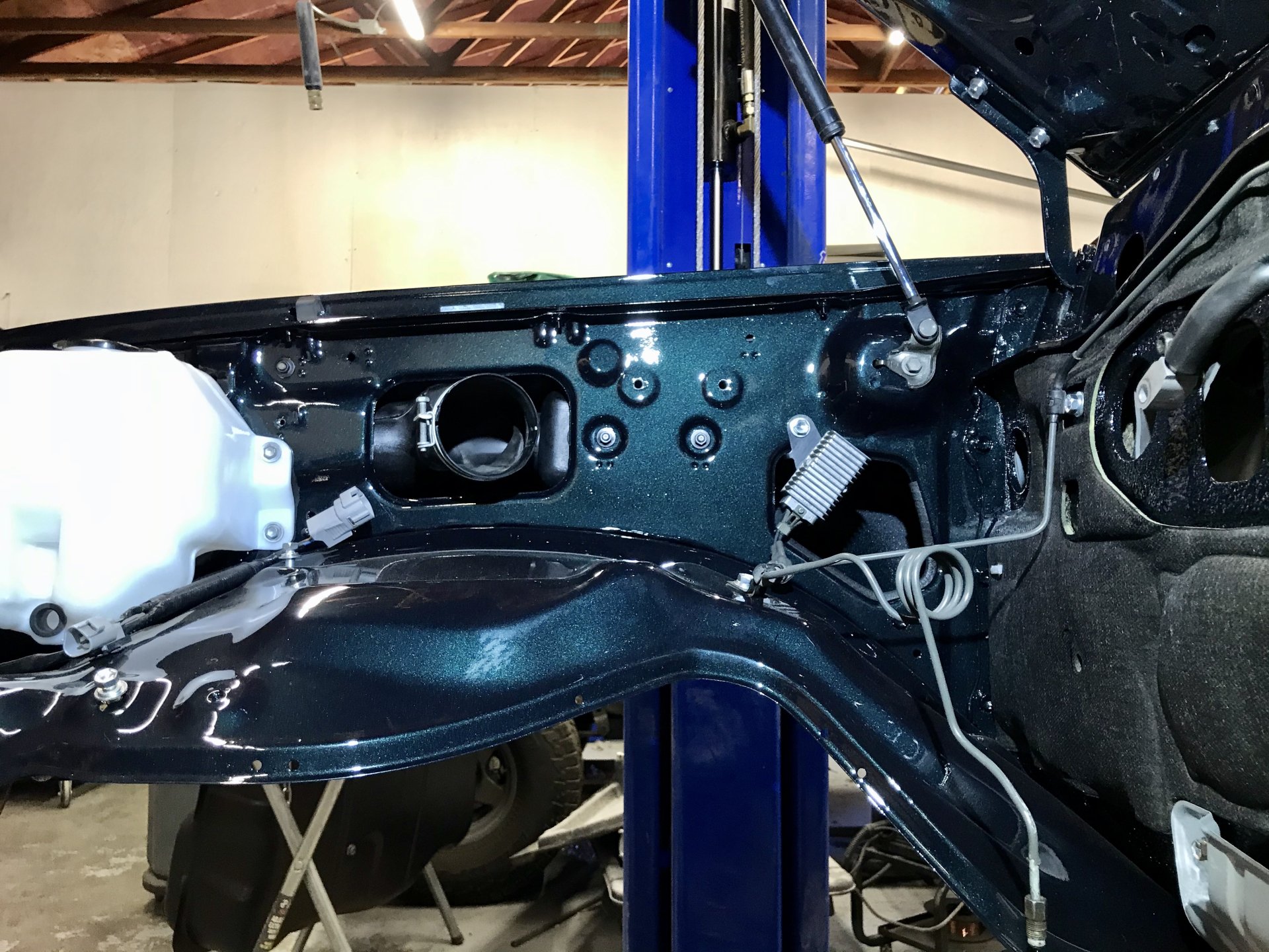

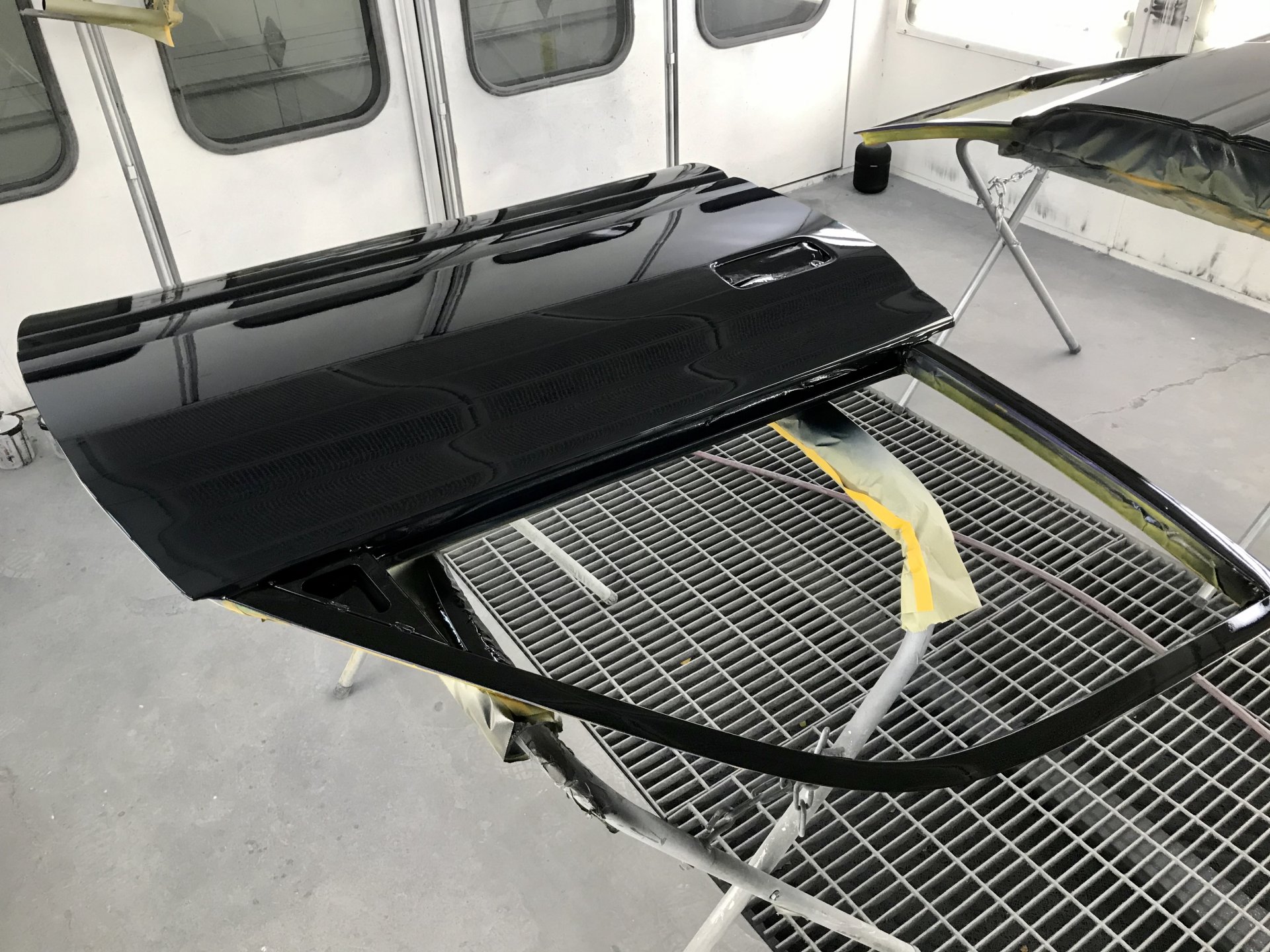

One, maybe two more rounds of body parts left for paint. The doors and hood got done over the weekend, let them cure all day today.
Starting to bolt a few things on the body.

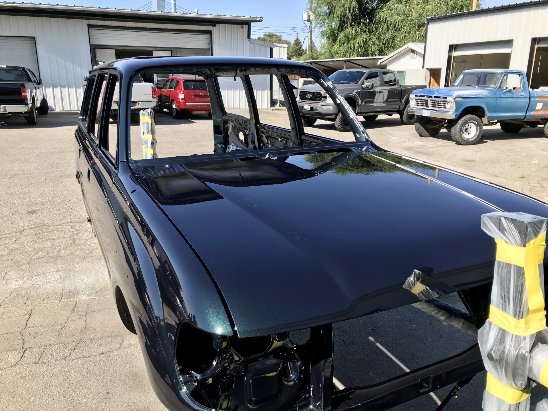

Another round of photo dump. 🤷🏼‍♂️
Bit different in the shop under florescence light. That is how 6M1 is though. Some people hate it and some people love it. I am a fan of 6M1, my 95’ is 6M1. 😆
Really happy with the hood.

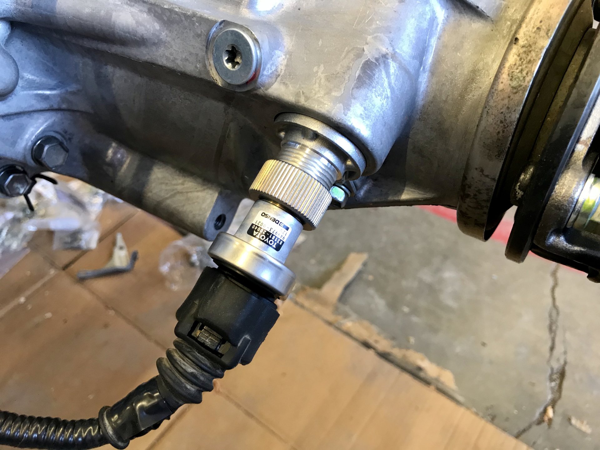

We got front driveline hardware in, something we were waiting on. Drivelines all done now.
I changed out the steering stops with fresh hardware as well.

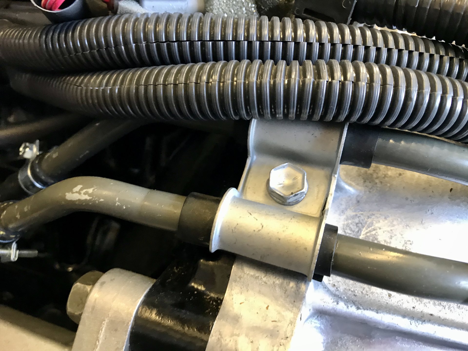

It is going to be one super sexy engine bay. 😆🤣
OEM y-pipe and #1 cat, we are going custom in house polished SS from there back.

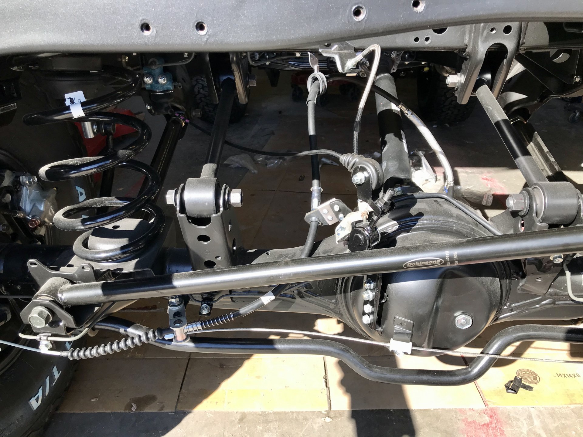

E-brake cable about sorted, just need another part or two to finish it off. SLEE SS extended brake line frame to axle.

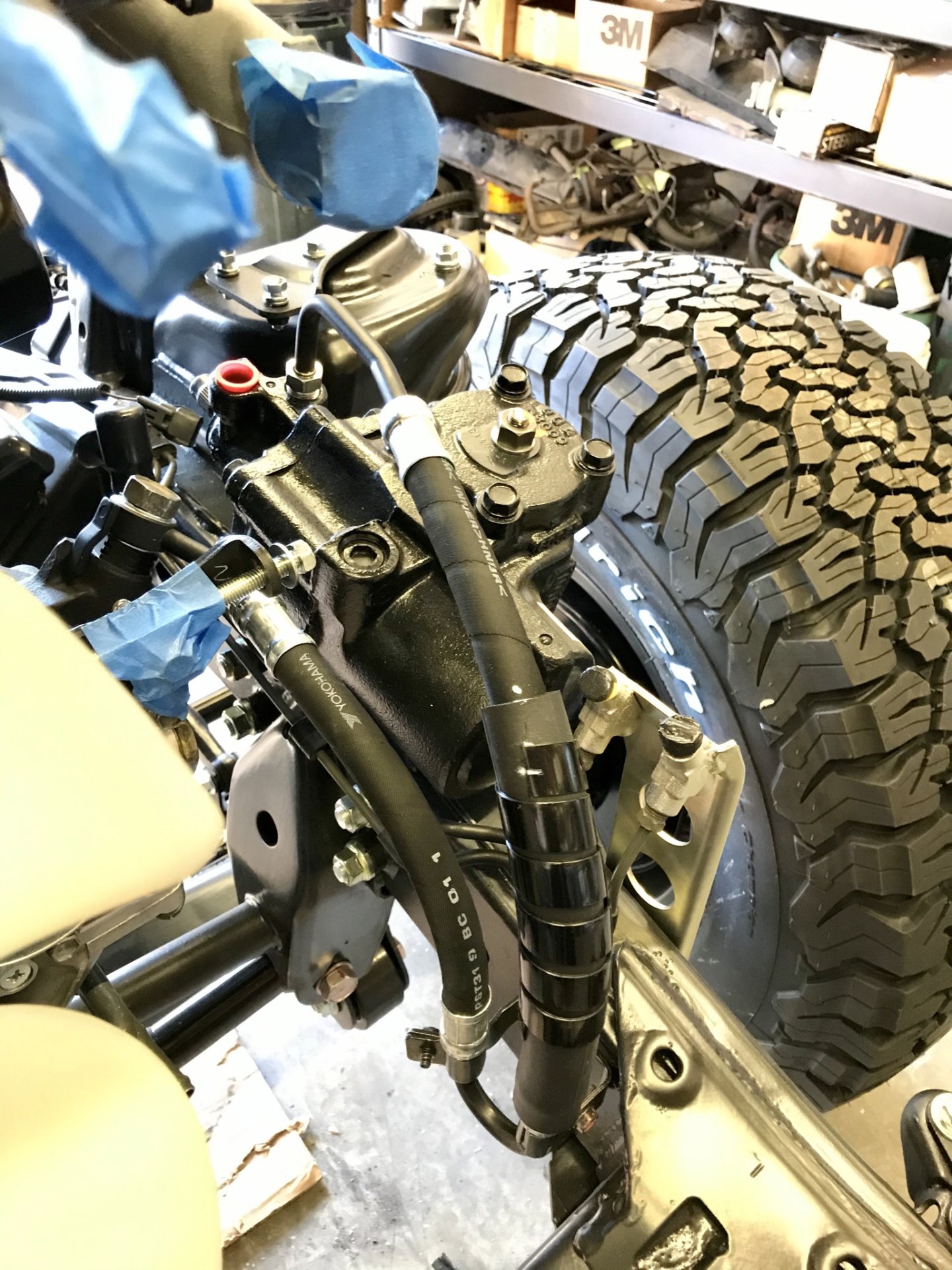

New OEM high pressure p/s line. Not running the “paperclip” for a cooler.
