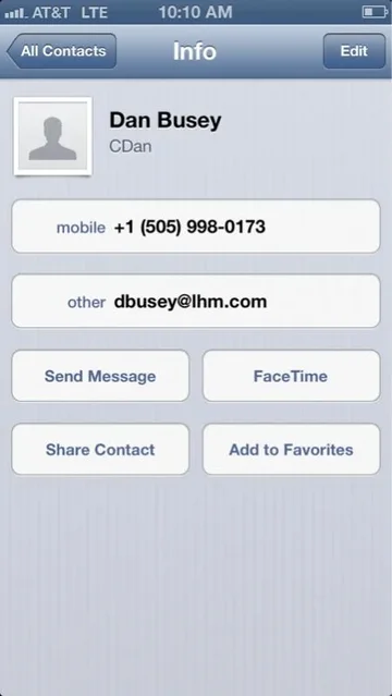

CDan's your man for correct part number and ordering OE Birf's.
Can't find my invoice with part numbers.
