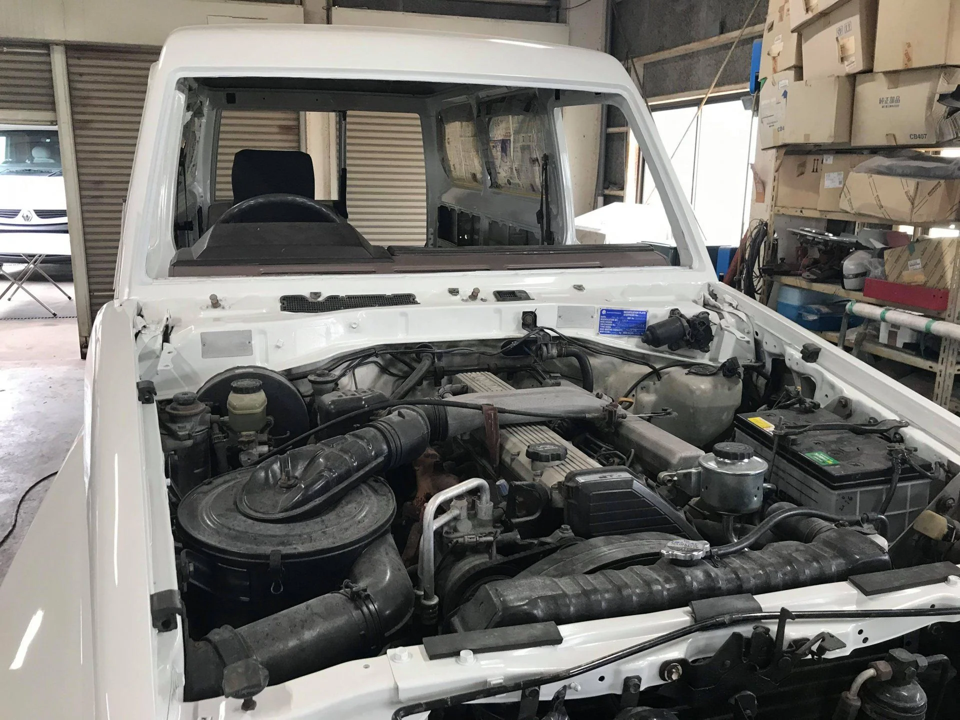

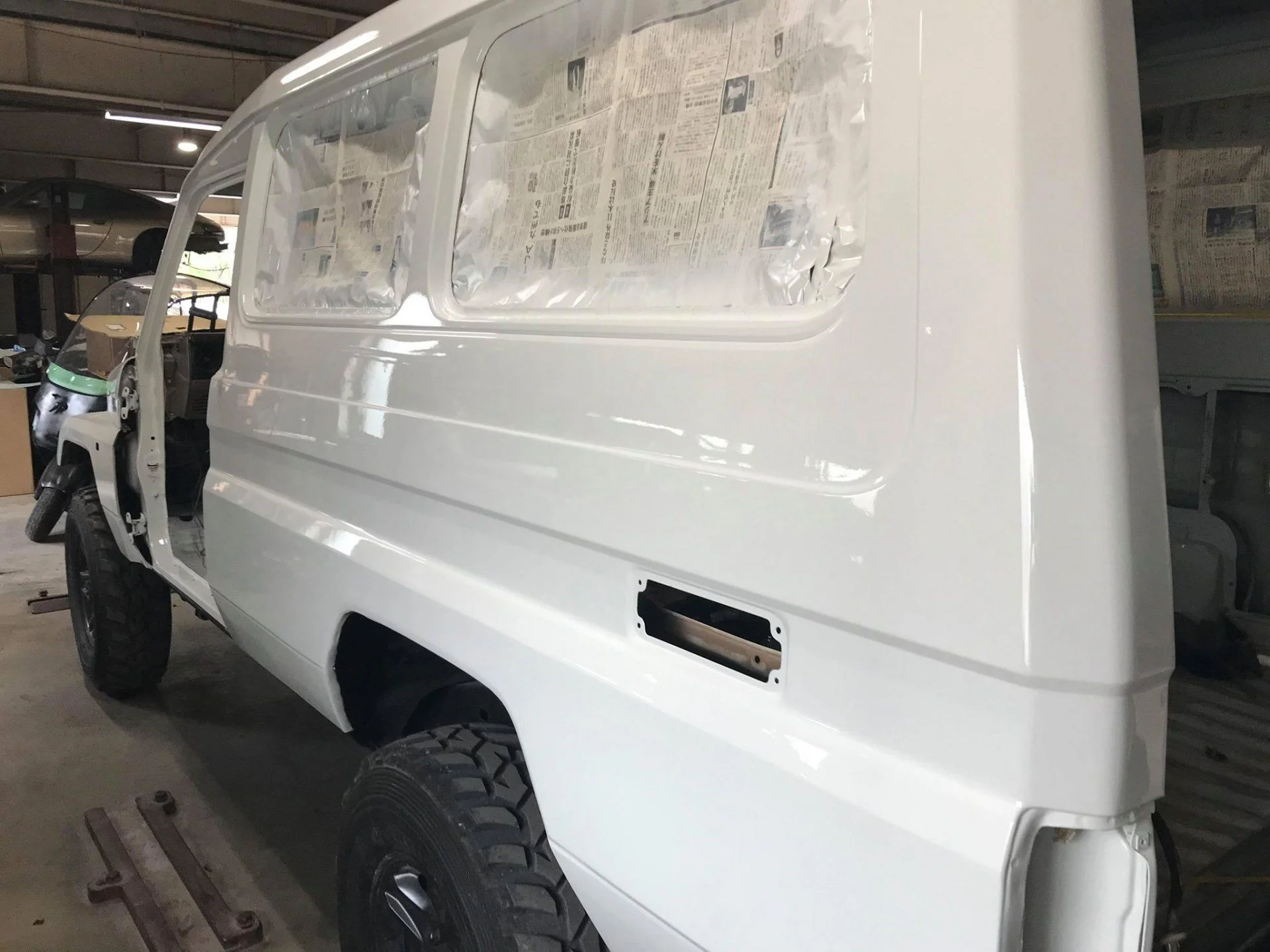

A couple of pictures before it was sent to the body shop. Having them go over it to ensure there isn't any rust hiding than painting it to look all pretty again...

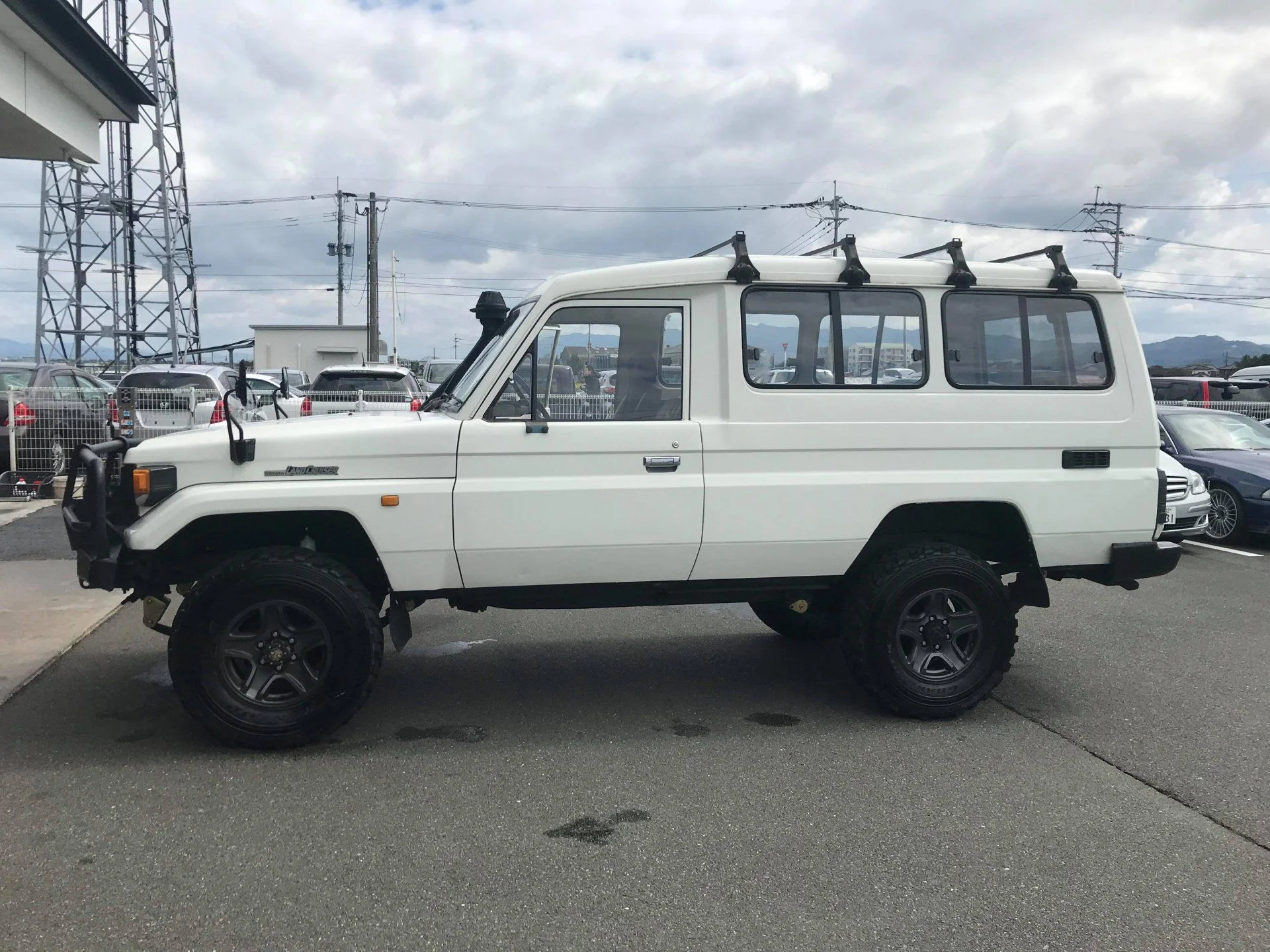

Congrats on a nice find - looks in good condition with nice upgrades already !
And in case you did not know: 75 Series Troopys Rule !

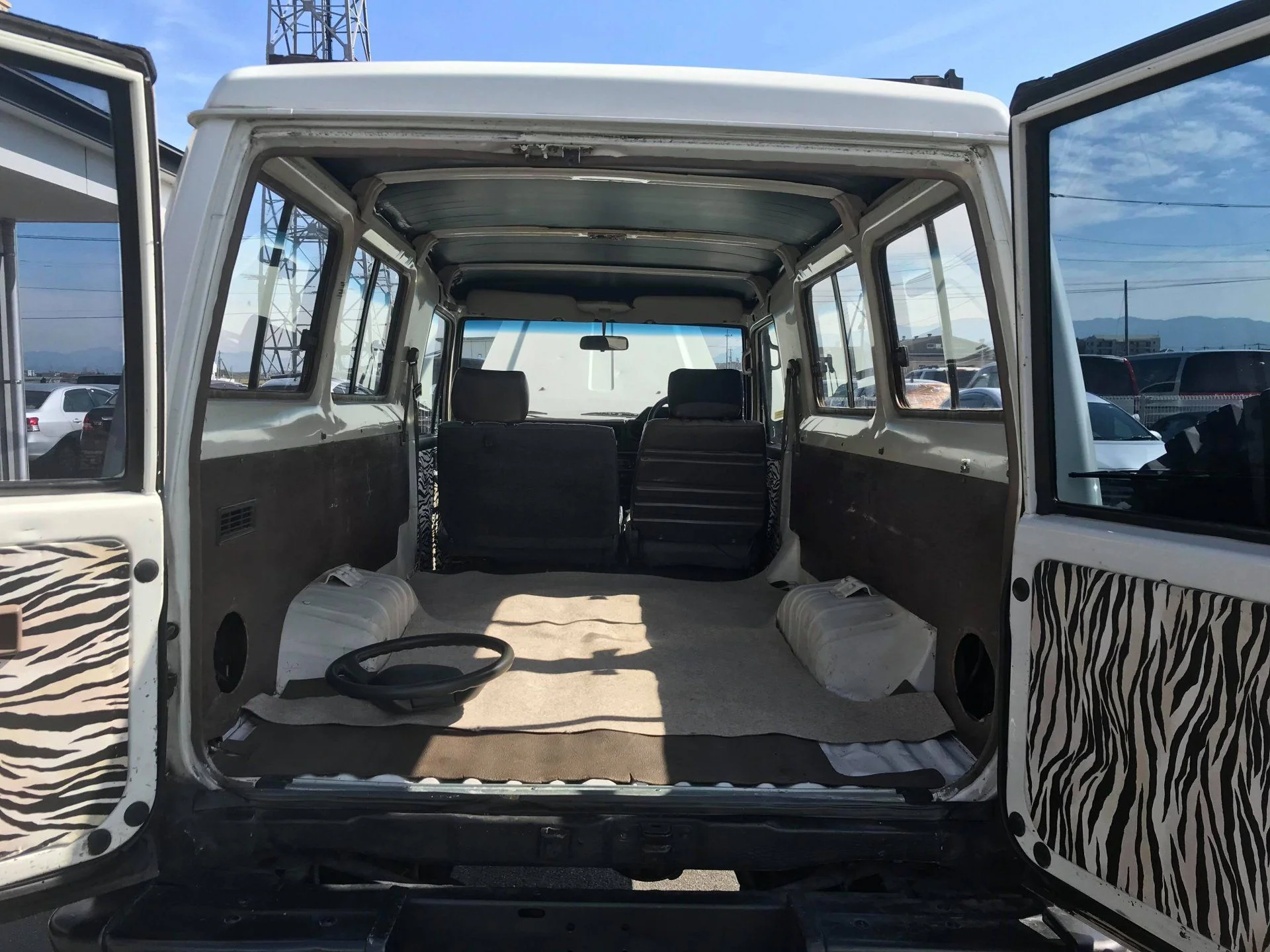

A couple pics of the money pit :cool: It came with pretty fancy door cards. I ripped out the entire interior already minus the dash but the plan is to replace all the old brown stuff with new grey parts. Seems easier to acquire and honestly outside of weird pieces here and there the parts are rather cheap.
I’d recommend getting all bodywork done in japan (looks like you’re in Okinawa?); rust repair and paint is so much cheaper. I’d also recommend all your soft parts like weather stripping and window gaskets, replaced concurrently.
Also interior work is cheap done in Japan too.
View attachment 2344652View attachment 2344653View attachment 2344654

That troopy looks really nice, it always cracks me up to find out what previous owners do. Just the strangest things. I've been EXTREMELY lucky with my BJ74 and previous owner mods.
Seems as though you actually have a Toyota steering wheel which is a rare occurrence. :)

Nice truck! 250,000 kms is nothing. It’s more a matter of how it was used. Yours looks to be in fine shape if perhaps questionably decorated.
