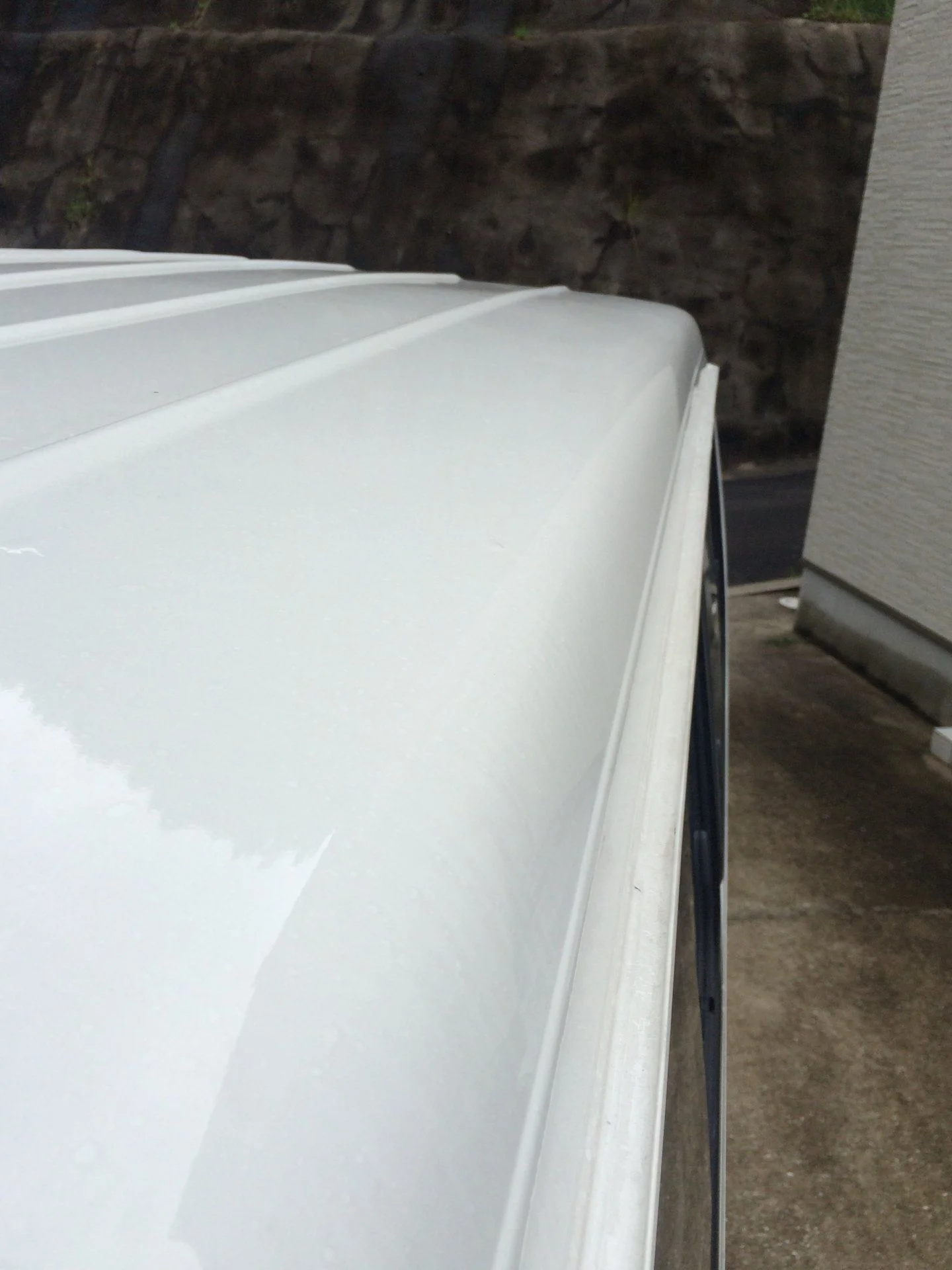

I know these things are not the most watertight of vehicles but I have some water in above in the channel above the rear barn doors and the rear pillars next to it. I circled the areas with moisture in the pics. Is it normal? Gutters look good, no exterior rust up top, nothing mounted or bolted in. The front is bone dry, so it has to be something midtruck or back.
I see water all over your windows... could it be coming in the edges of the slider window?
Perhaps look for hairline cracks in the paint/sealer of your rain gutter... any spots where water sits and slowly seeps in?
I changed all the seals, and the water starts above the area of the window seals. Do the gutters have drainage holes in them? Mine don't and I am not sure if they are meant to have something that allows the water to drain in certain areas.
The side windows have a drainage small window at the bottom .
If they have been taken out and not properly refitted , it might be the reason of your problem.
Would suggest to take them out , get rid of the rust that certainly you will find between window frame and body .
And reassemble all in correct way .
Hop in the truck while someone sprays water at various points....you'll find it pretty quick.
