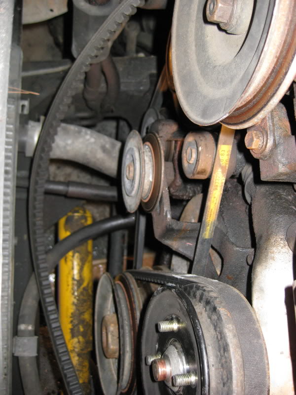

Alright all - Got started on the water pump replacement tonight.
Took about 2 hours to get the pump off (not a mechanic :))
Here are a couple of pics, lots of oil from about midway down the front and passenger side front of the motor, I will worry about that later, getting the water pump done and then I will get the oil cleaned up.
Finally off

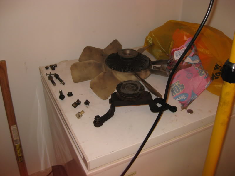

How did you remove that lower left pulley bracket? The one you have sitting on your freezer in the pic with the fan. I have removed the two bolts on the water pump side but I cant see the other end of it. I removed two bolts from that area and nothing. Just by touch it seems it goes underneath some other bracket.
Nevermind. The bolt for it was underneath the bracket for that bottom tensioner. Remembered I had an endoscope for my cell phone. Handy to look at hard to reach spots.
