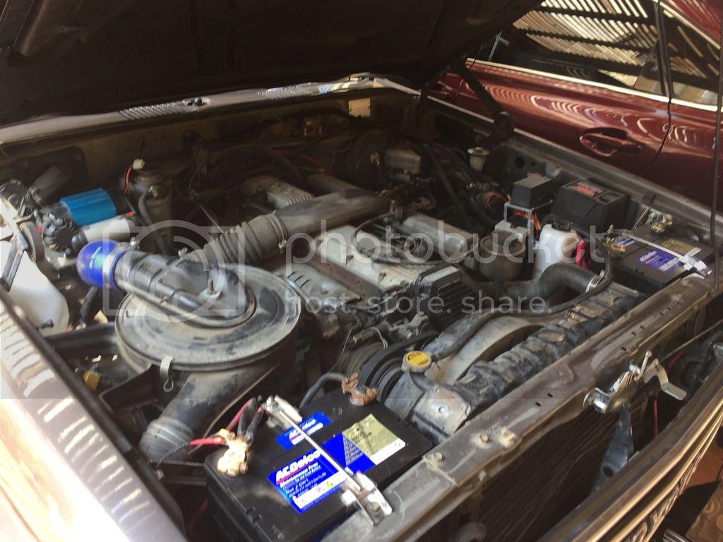

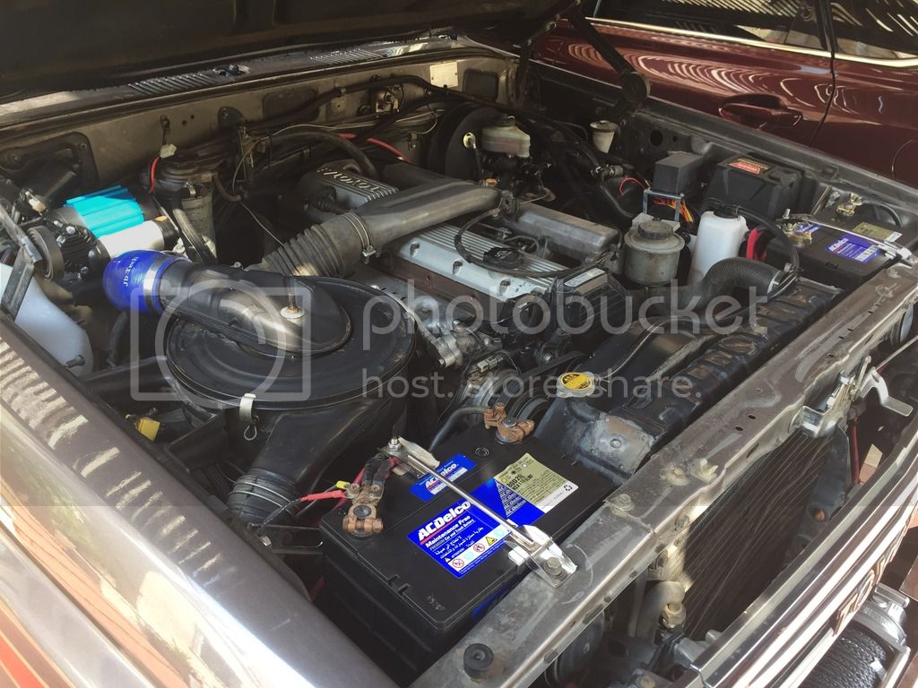

Got the engine bay finally cleaned up as best as possible.
Before
After

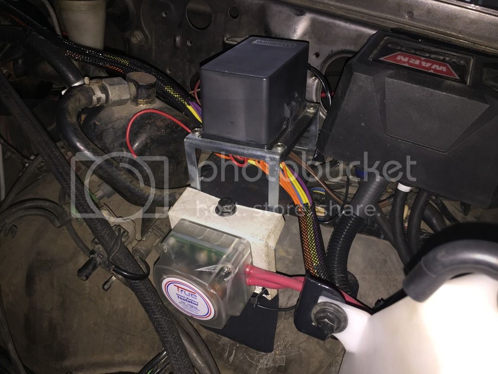

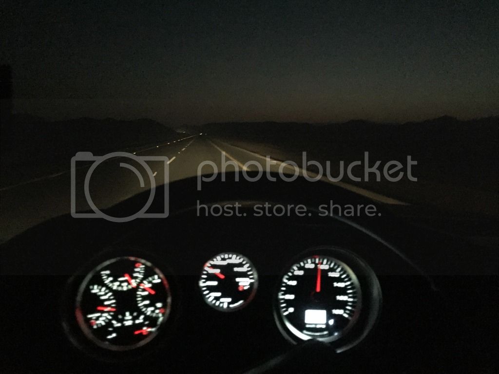

@slcfj62 harness installed. Such an easy plug and play, and the difference in brightness is literally night and day. Under that is an intelligent solenoid for the dual battery system

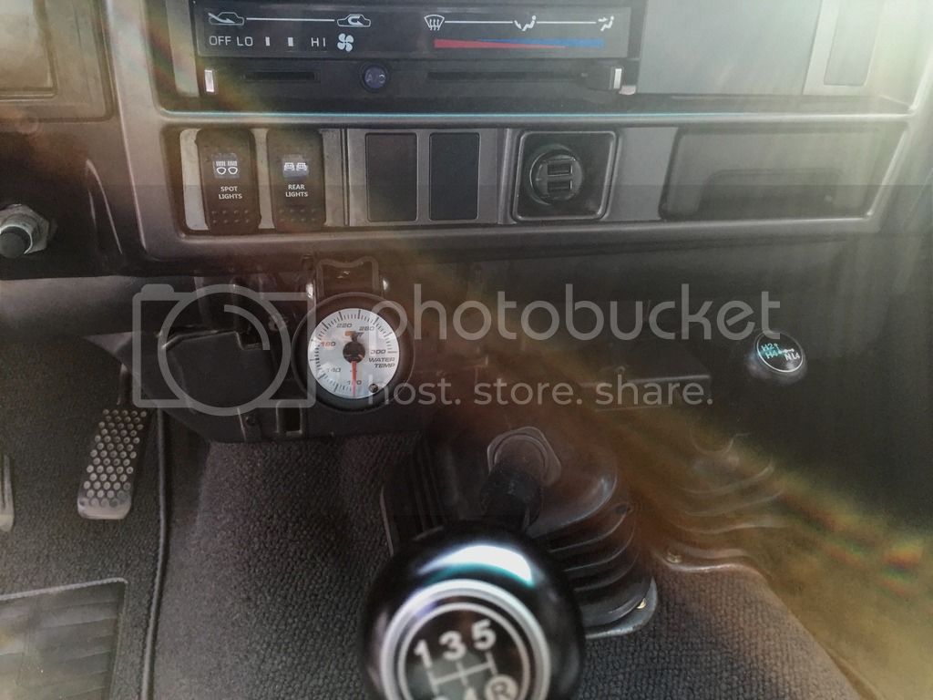

Wired up both the front and rear Rigid Dually's.

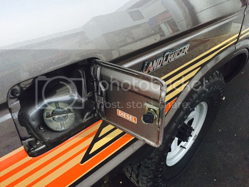

Installed a rather important sticker, in case anyone forgets! This is OEM from the Toyota dealer.

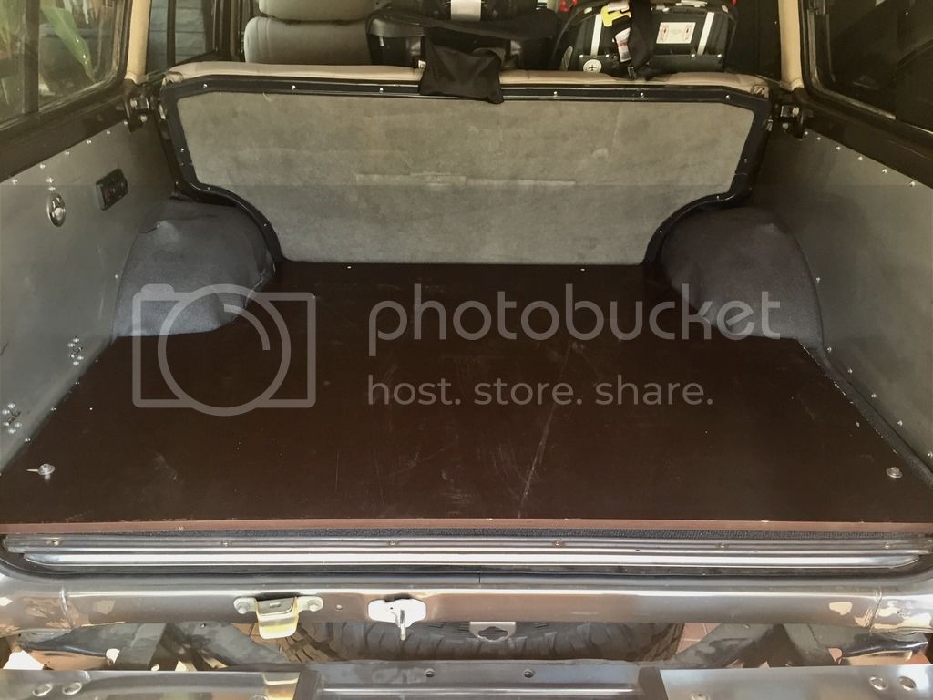

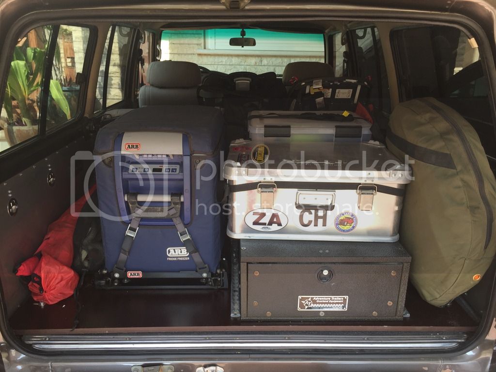

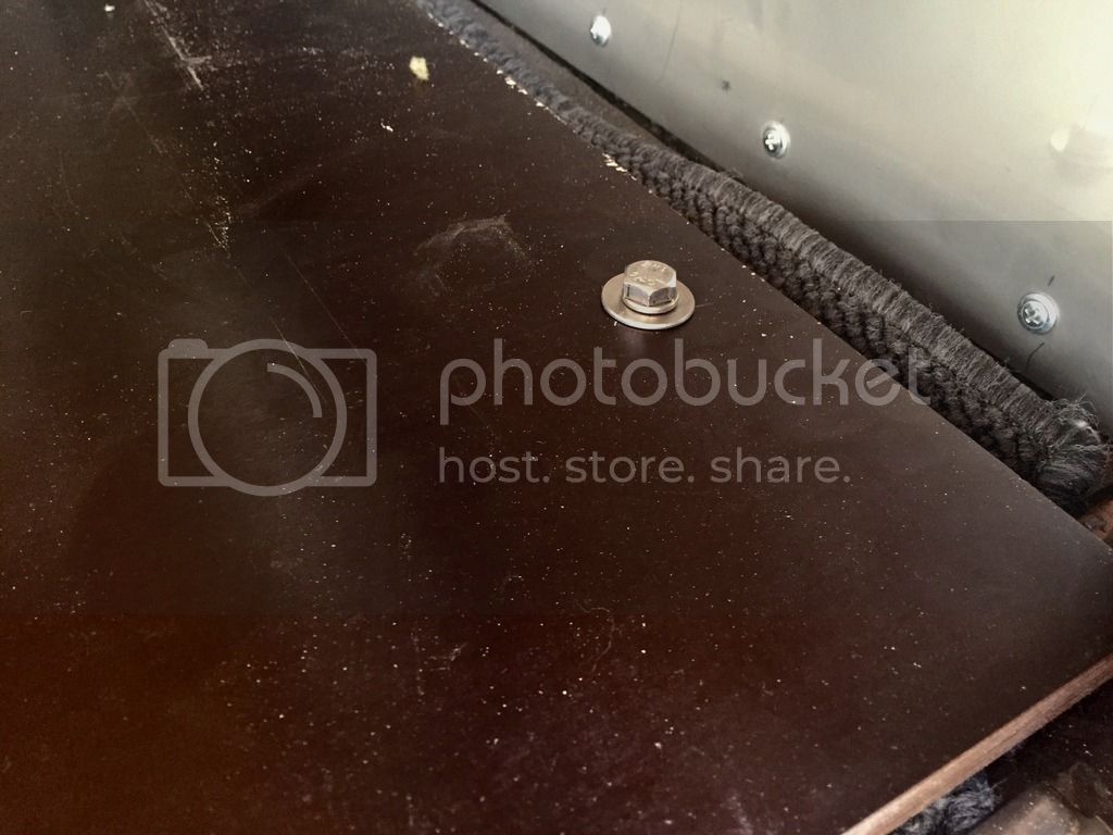

This morning I got cracking on installing a plywood base for my storage set up. It is secured with 4 bolts that are in place of the original tie down hooks.
I have an old set of Adventure Trailer drawers (I think I purchased them in 2008/9). Solid work they do.
All squared away.

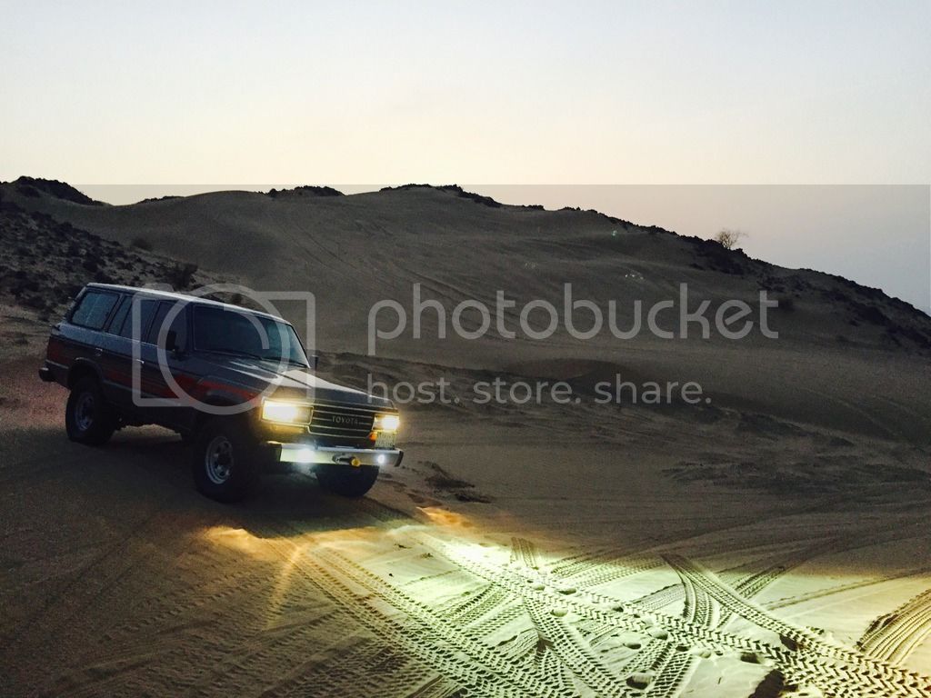

Went out on a shakedown run last weekend. It was nice to finally get out after nearly several months of avoiding the heat.
A few issues we ran into:
- Exhaust pipe bolts snapped from the bracket under the PS side and was banging on the underside of the body
- Transfer case would pop out of 4H into 2H under hard acceleration up a dune. No issues with 4L. Searching around here shows that its an easy fix with a few washers in the transfer case bracketery, which can be accessed from the tunnel in the cab
- Transfer case has been leaking small drops overnight. It does not seem to be coming from the output shaft seal, but will take a closer look
- Lastly, AC idle kick up is not working. Need to get the vacuum lines and solenoid looked at. The wagon feels like its going to stall whenever I am idling with the AC on.

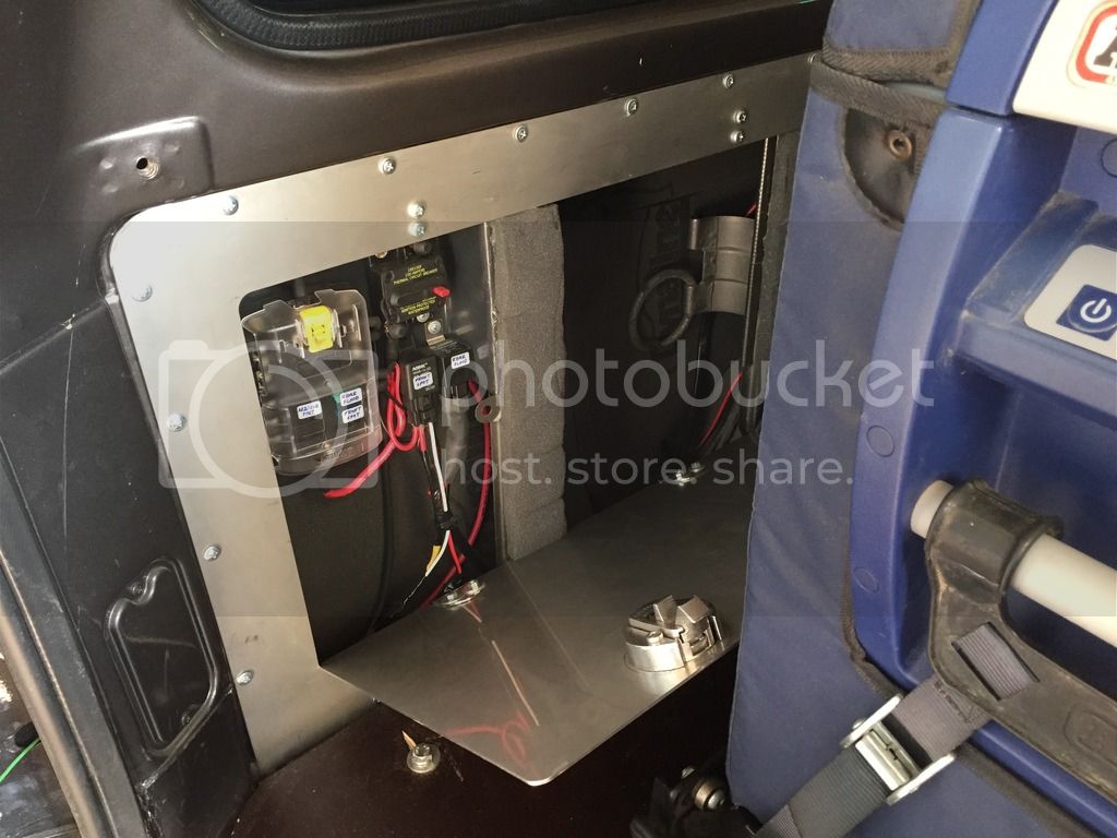

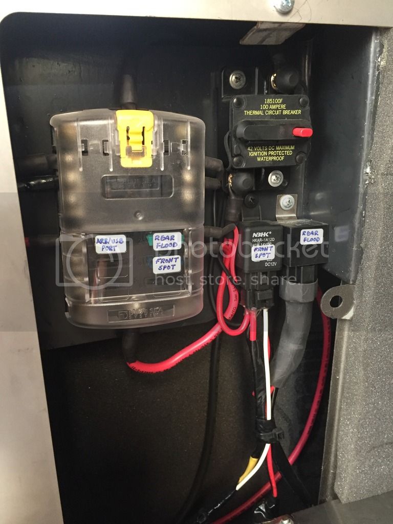

I thought I posted this earlier but here's the storage panel with the fuse box and 100A circuit breaker.

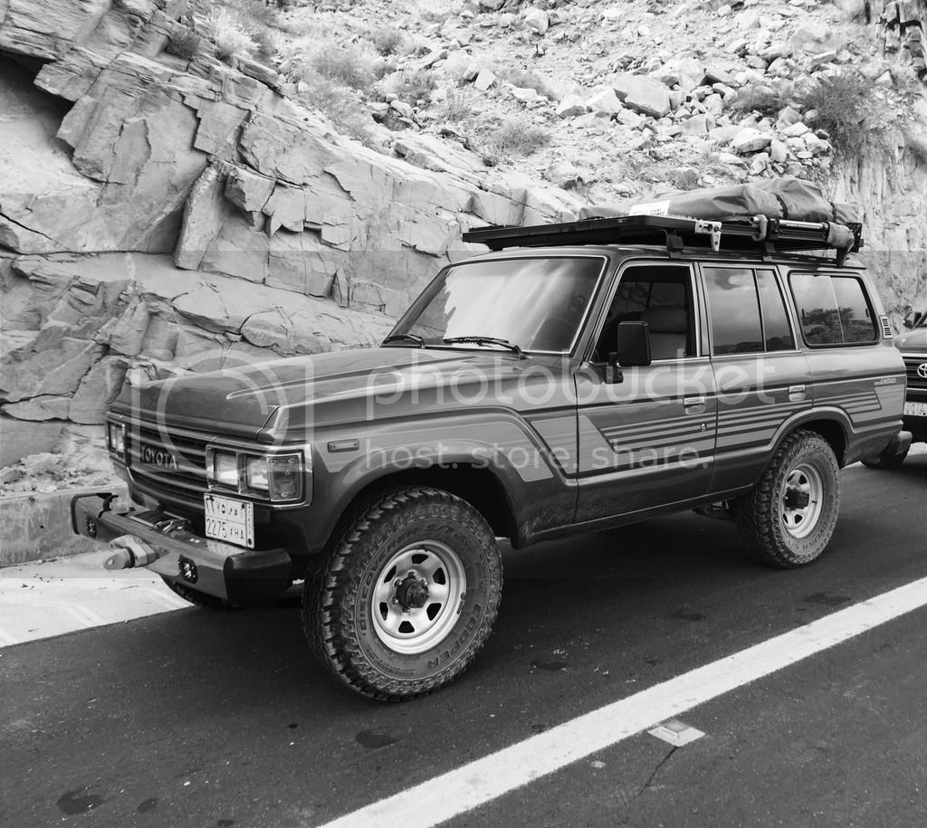

Yesterday we snuck in a quick day trip to go hiking. The Mule did well, except it struggled up the mountain passes steep grades. A couple of times we were in 2nd gear going 40km/h. The clutch seemed to slipp a couple of times on the outbound leg up some of the passes, but thankfully nothing on the return leg. Will keep an eye on that. Getting the transfer case to shift from 4H to 2H was a proper b*tch at the end of the trail. Took several attempts, including driving for a bit and trying again before it worked. I thought I was going to snap the lever! Last but not least, and thankfully only happened a few blocks from home in a residential neighbourhood, making a right turn, the truck went straight onwards! Crawled under and discovered the nut for the PS tie rod end was missing. Thankfully it happened there and not on the highway! Tried as best to secure it with some ratchet straps and limped home.
Enough of that, here are some pics.

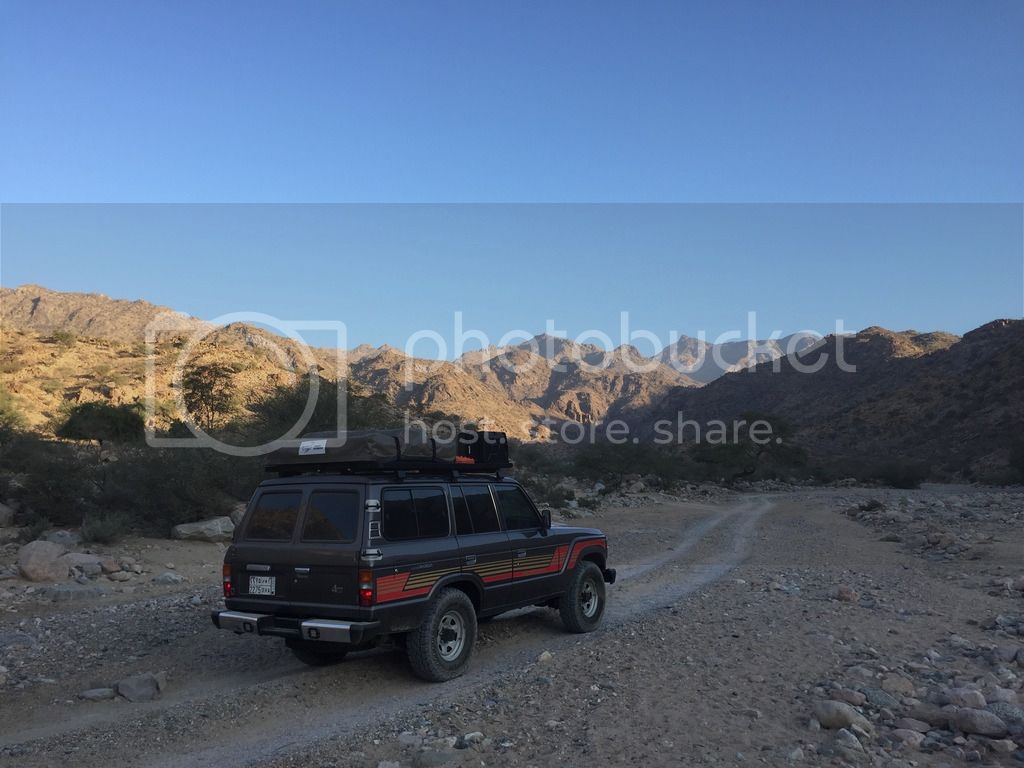

Nothing beats a 5am start.
The mountains are calling
Some perspective on size
Back where we parked up. Prepping for some breakfast
Heading back
Saw the Mule's older brother parked on the side of the road feeling lonely.

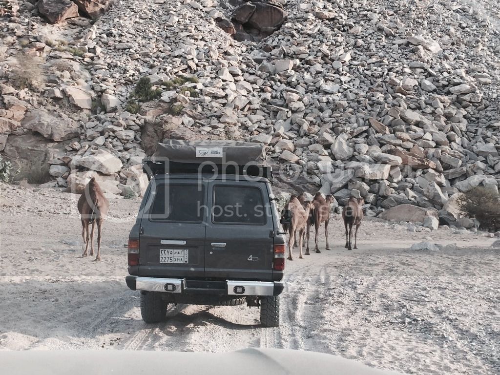

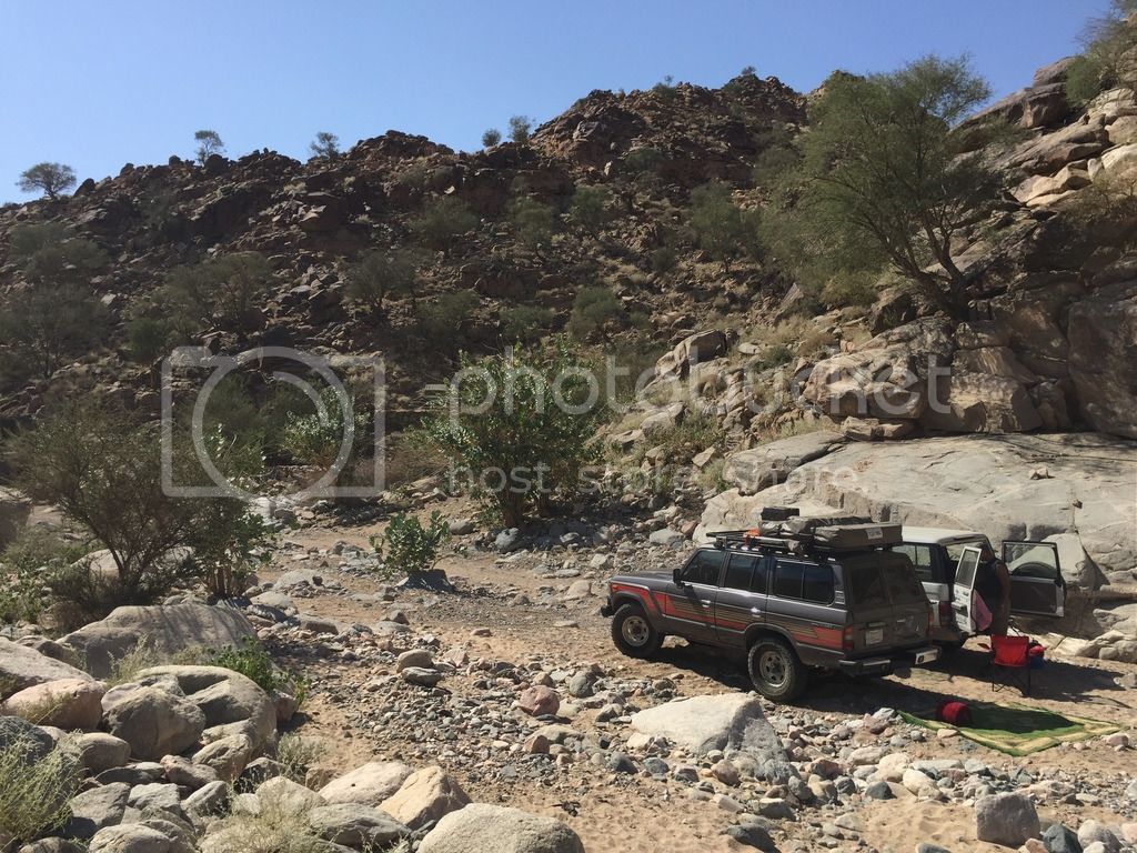

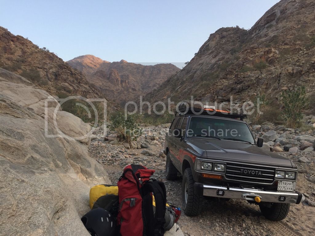

Did another trip last weekend. Found a nice secluded spot to camp, and next morning we had an early start on a 10hr hike.

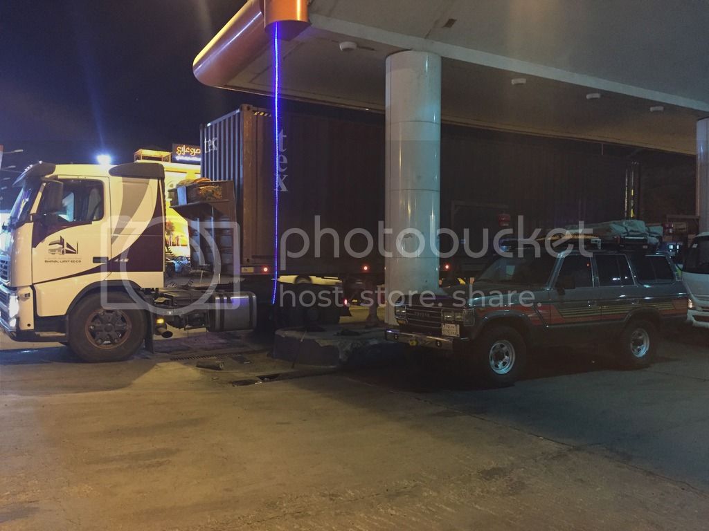

Filling up with the big boys on the way out of town
It was 11pm by the time we got to the area and set up camp.
We drove to the trail head and hiked out from here
The big drop on the way back
