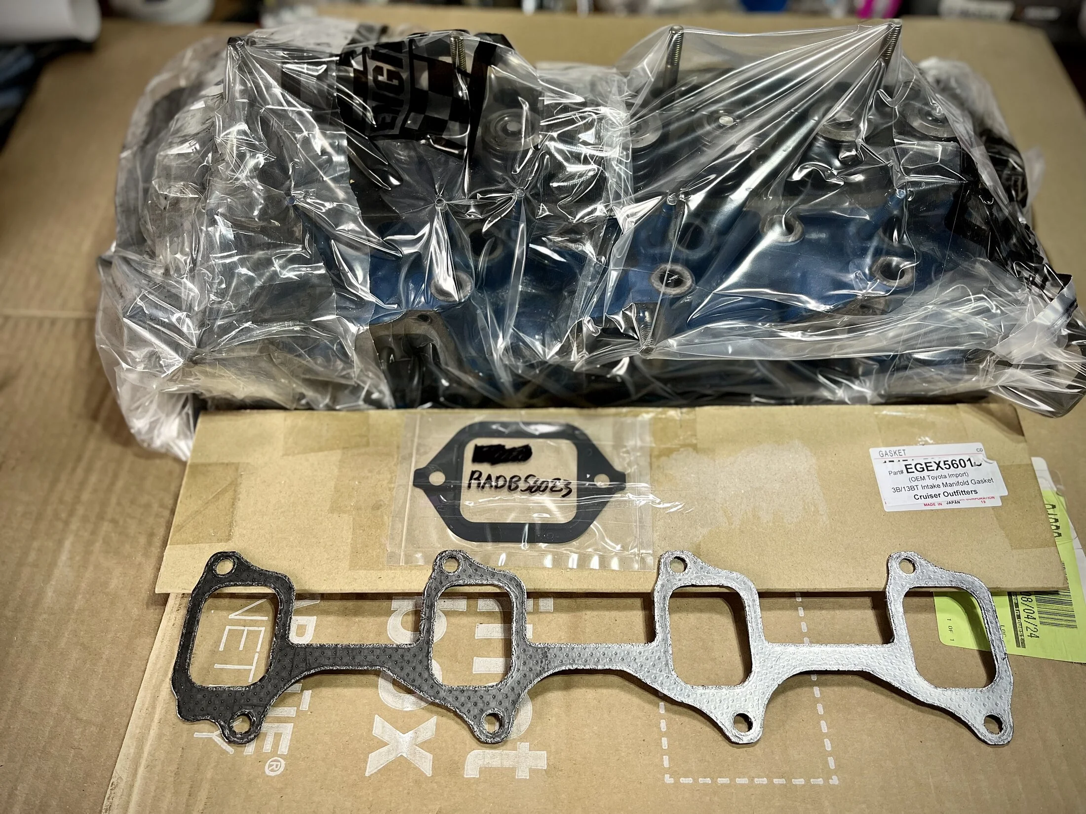

So it’s part order time. Started with one of my first shops cruiser outfitters. I was told they didn’t have the headgasket, or the intake or thermostat housing to block. That’s weird, I’ve never fully struck out with them…
Googled online and found a US online dealer and placed an order for the headgasket and I take gasket. 10 mins later I get a call…
Um, there are none of those in the US and backlog so none available. Now 2 thoughts enter my mind, f@ck…I could be waiting a while, and then 2, the ghost of @OGBeno yelling “parts monkeys don’t know jack…”
So partsouq for the win on the headgasket, will be here in a week.
Strangely I was able to order the intake gasket and thermostat/block gasket on cruiser outfitters online and it shipped…not sure what got crossed but I believe all parts on the way

Oh I’m just looking for the gaskets, maybe that’s where things got messed up but apparently I’ve been shipped the parts 😂

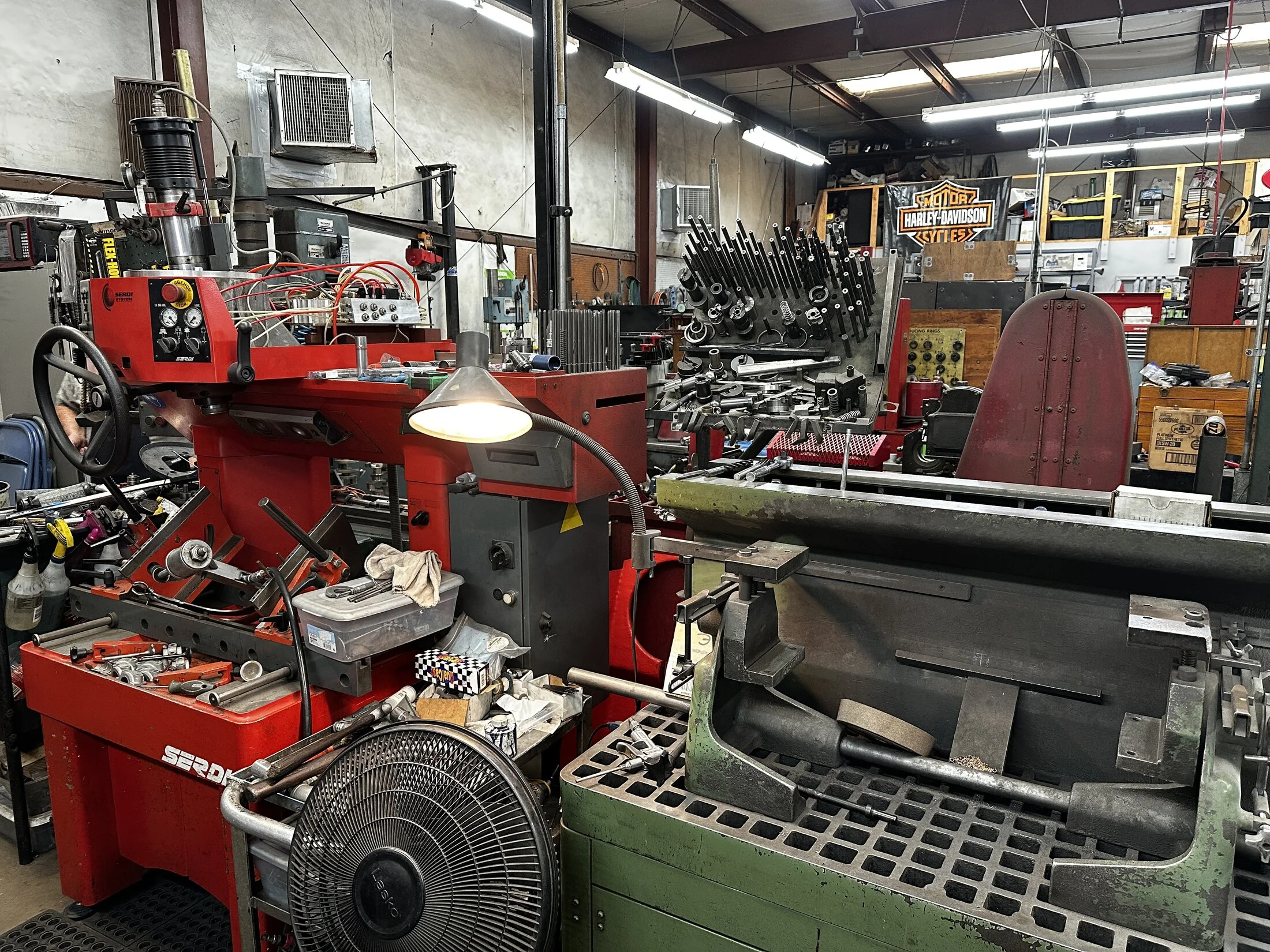

Hit the machine shop this morning. Got my daily dose of grumpy old man politics and world problems 😂
Looking at it we couldn’t find any failure or issues. MLS headgaskets generally won’t blow out.
We looked at the records and saw that he just fixed some freeze plugs in the head and fixed a valve depth and new seals. It was resurfaced by the old shop, but it’s possible they didn’t do it straight…maybe…

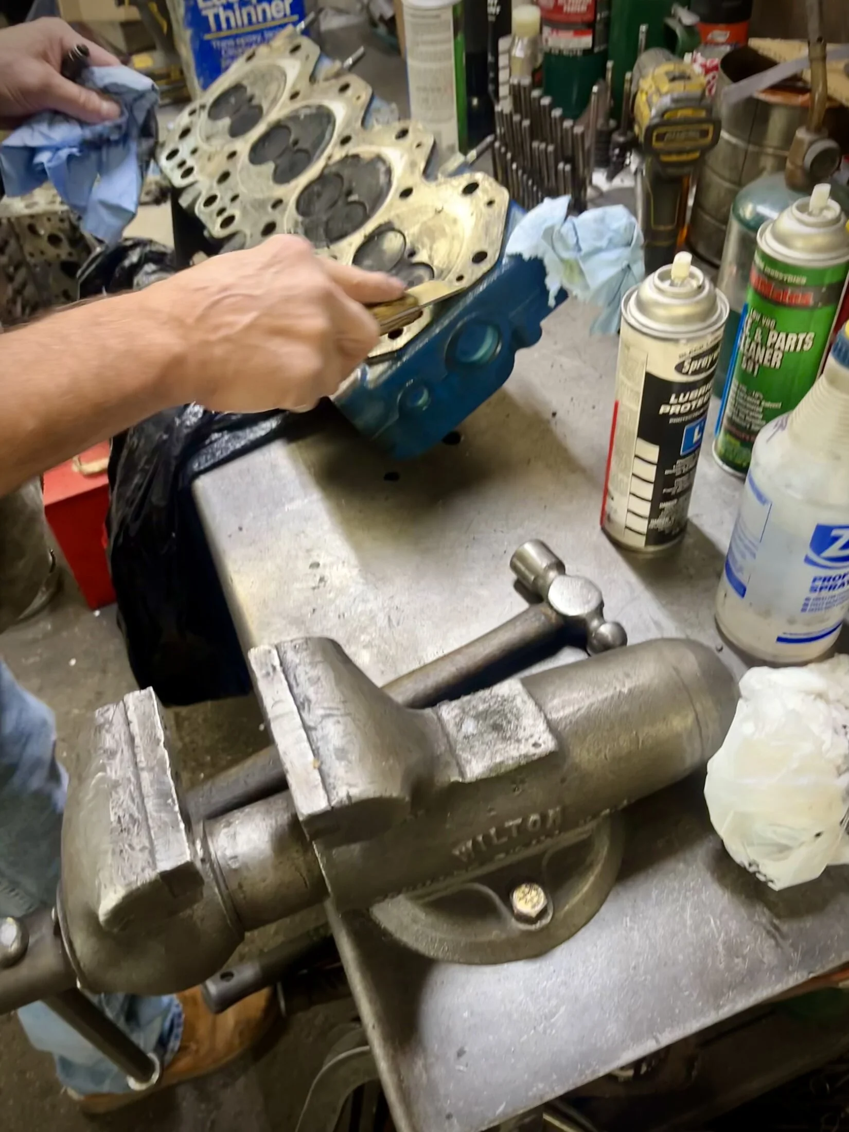

Scraping off the old junk.
His preferred method, nothing abrasive. Good gasket scraper and some penetrating oil. A razor blade works good as well.
No sanding with power tools or rolocs. You can mess things up.
Use a soft scotch brite pad with you hand and some lacquer thinner or brake cleaner to clean it off.
Looking for imperfections.
We did find some corrosion pitting from coolant so decided best to resurface it.
Interesting, thanks for the nice pictures :) One of my favourite home-made tools is a piece of copper (household) radiator pipe hammered flat, with an edge put on it from an oil stone. It works wonders removing old gasket from steel, cast iron and aluminium, though it might leave some copper particles on the head deck. No way I would ever put anything on a power tool near that surface.
Has the head been checked with a straight edge?
Checking level
Using thin pieces of brass and copper to level it to thousandths
Run it over it to take 2thousanths off.
According to him, it’s really hard to check all straightness with a straight edge. There can be little spots you can’t see or measure with the straight edge.
Resurface is the best way to get it level.
After this it was over to get cleaned off and ready to put back in.
Ah, you are way ahead of me. Looks great now - did you see any high spots as he was making passes with the cutter?
I think im just going to use a razor and penetrating oil. We know for sure the block was right, it’s just a question if there is any corrosion…I really hope not.
No high spots, just some pitting around where it was leaking so we took it down to get rid of that but enough to not have to mess with valve depths.
after the scraper treatment a
VERY light EVEN touch with some scotchbrite and 2000 grit paper on a small brass sanding block, just to expose the surface a slight bit, helps imho
just cant be a neanderthal about it, if youre a tradesman you get it.....
this is how i got my mls gasket to seal up without machining the block deck at all, (knocks on wood)
Yep, nothing power or get too crazy about it. I need to check the block today for pitting, that would be the only issue I could have…

thermostat/block gasket came in along with intake gasket. Thanks @cruiseroutfit
