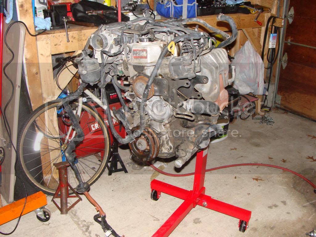

My name's Jim. My money pit is an '87 Pickup 4x4 carb:
It belonged to a colleague of mine, he bought it used and it was his DD for several years until the engine blew up back in 2010. Freak accident; he had just replaced the timing chain, guides, water pump, etc, and he managed to break one of the steel guides and wrap it around the crank gear, which locked up the motor. Engnbldr said he's only seen it happen once or twice, it's caused by over-torquing the tensioner to the point of seizing it, and driving the engine with the chain rattle until it breaks the guide:
