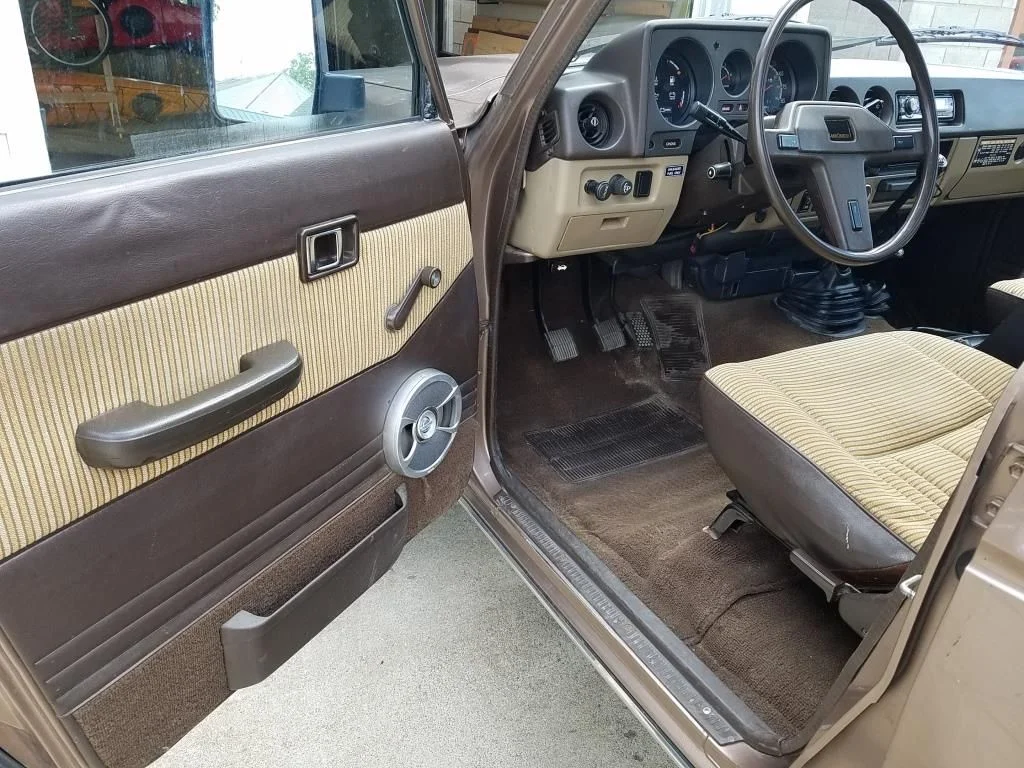

Greetings fellow mudders, this is a thread about a 60 affectionately referred to as Bernie.
Pics from PO.
This 60 is currently my wife's DD and worked on by me. Our ownership has been a positive one (since 08/17) in large part thanks to the contributing members on Mud who share their knowledge and experiences, so in effort to pay back, I got a star and started a thread. Hope you enjoy.

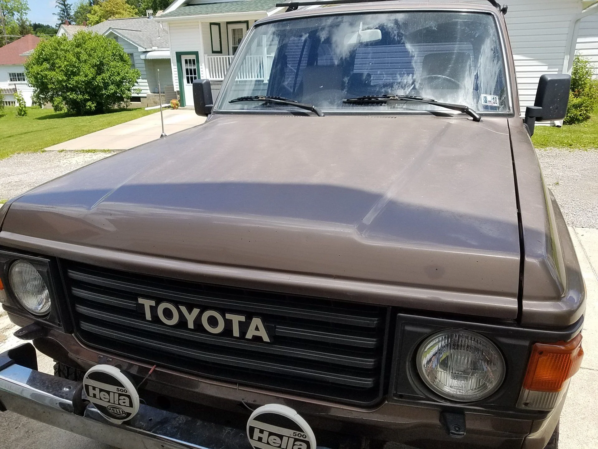

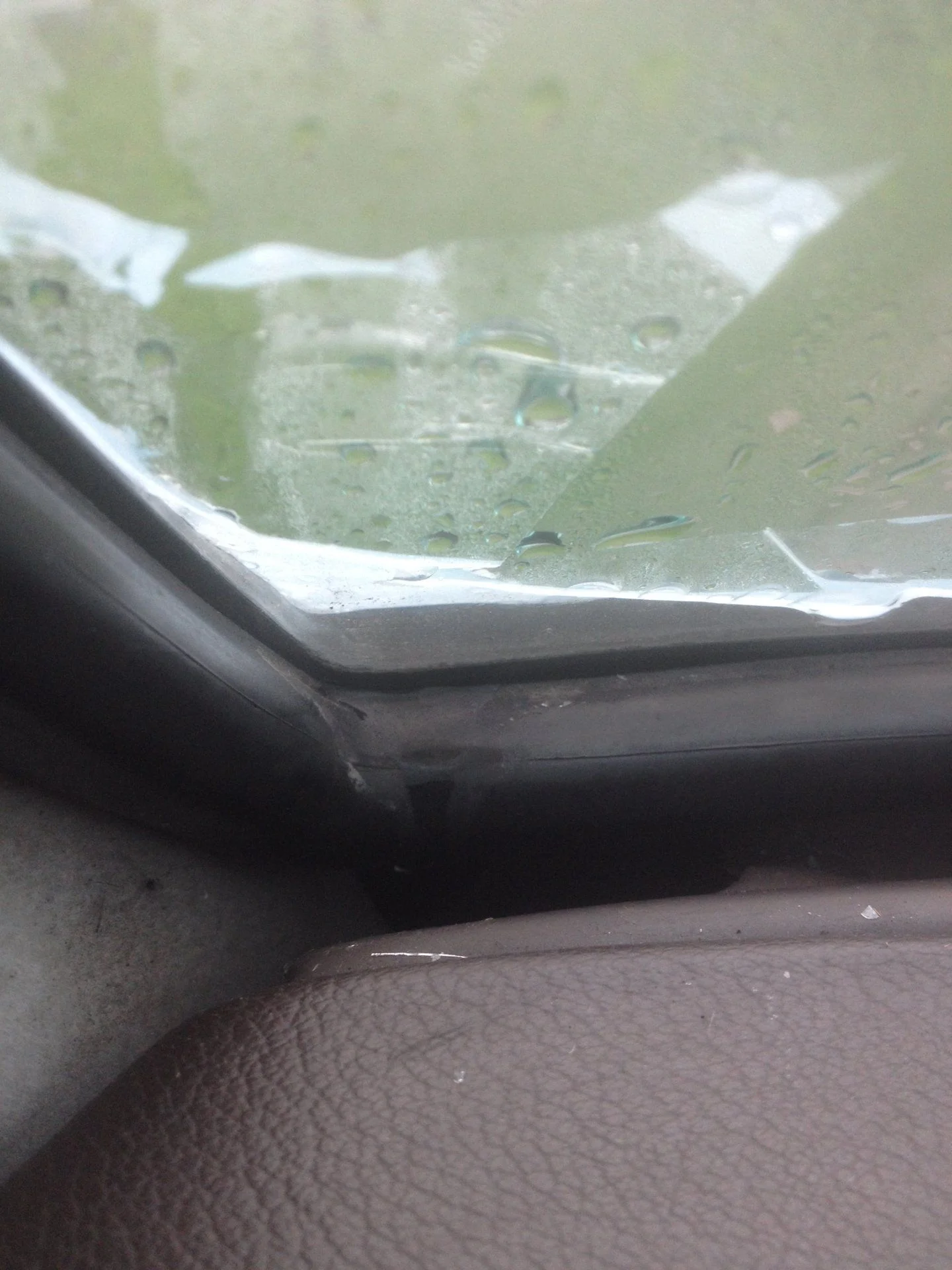

In order to pass MD inspection, I was asked to replace the windshield, fix the leaking PS pump and address the fuel smell coming from the back compartment.
I lucked out with the fuel smell and was able to correct with an OEM gas cap.
PS pump was also easy, I called Matt Hodges at West Texas Off Road and got a rebuilt unit from him.
The windshield was not as easy, I knew from reading here on Mud that getting it right can be difficult, so I sent an image of the FSM where it describes the proper procedure and we still got this:
which led to this
The tech returned and used sealant this time.

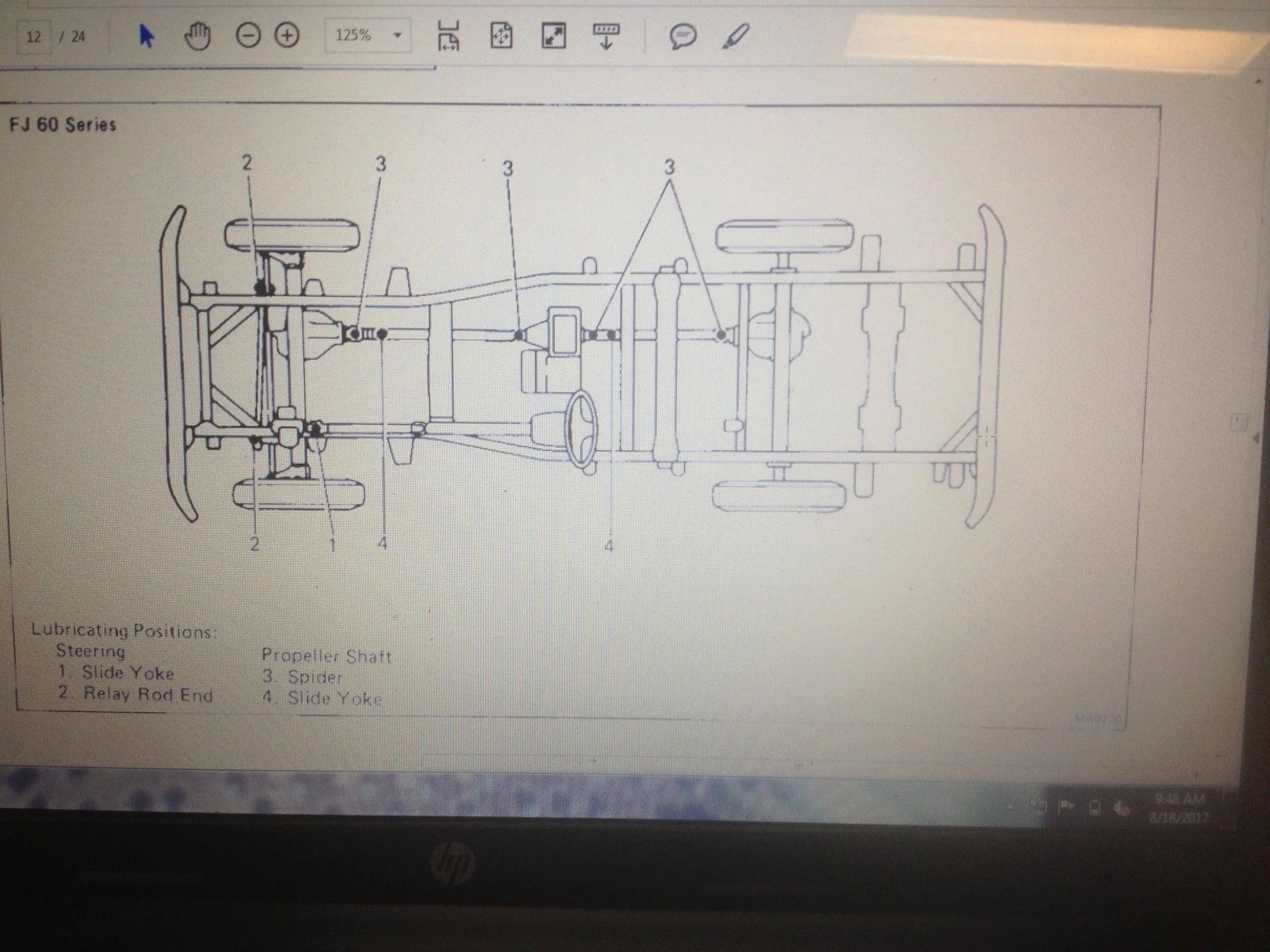

With the help of the FSM's I started the preventive maintenance schedule, changing oils and filters as well as greasing lubrication points. It was a good way to spend some quality time underneath her and figure out what was what.
Lubrication points:

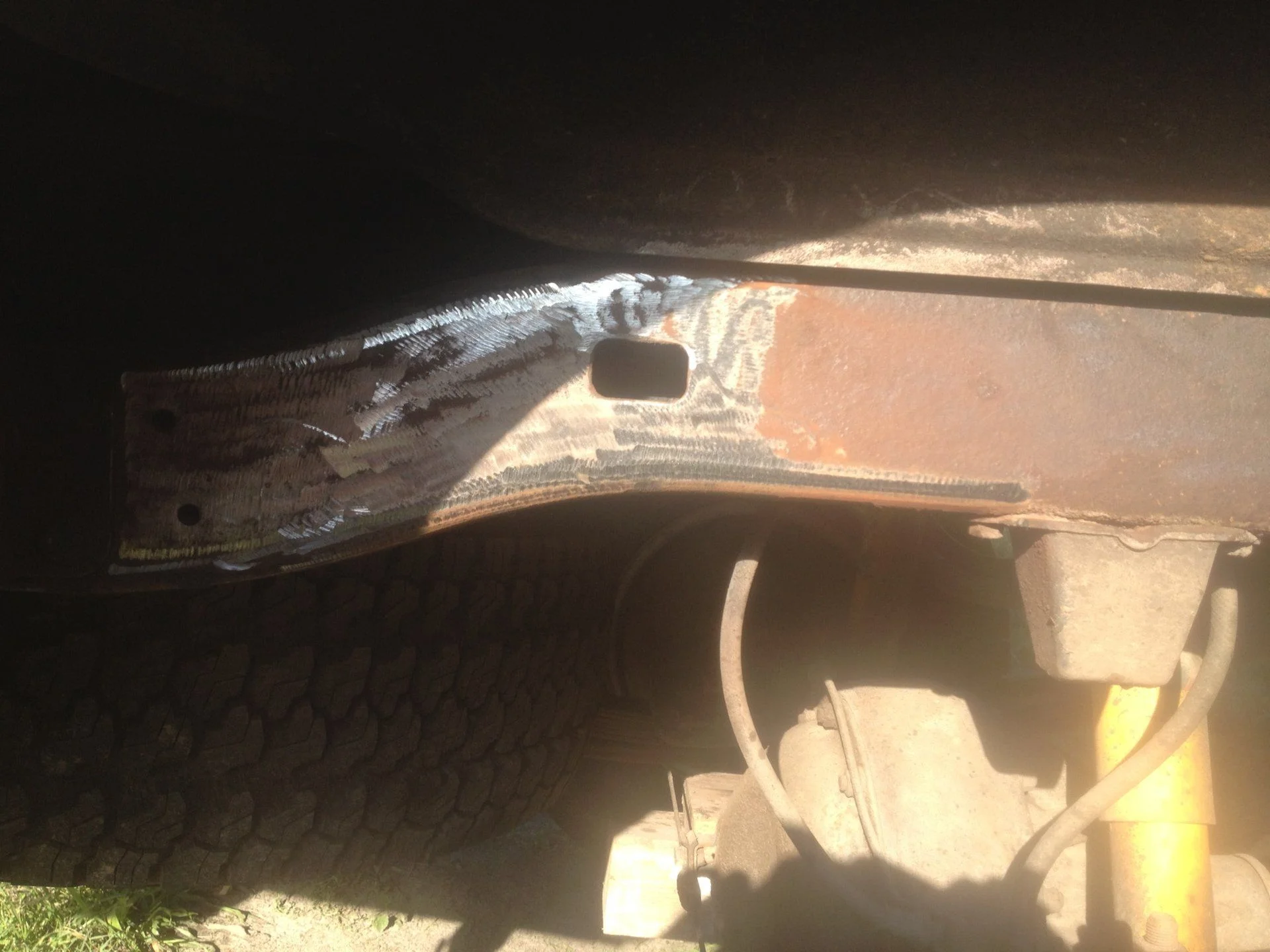

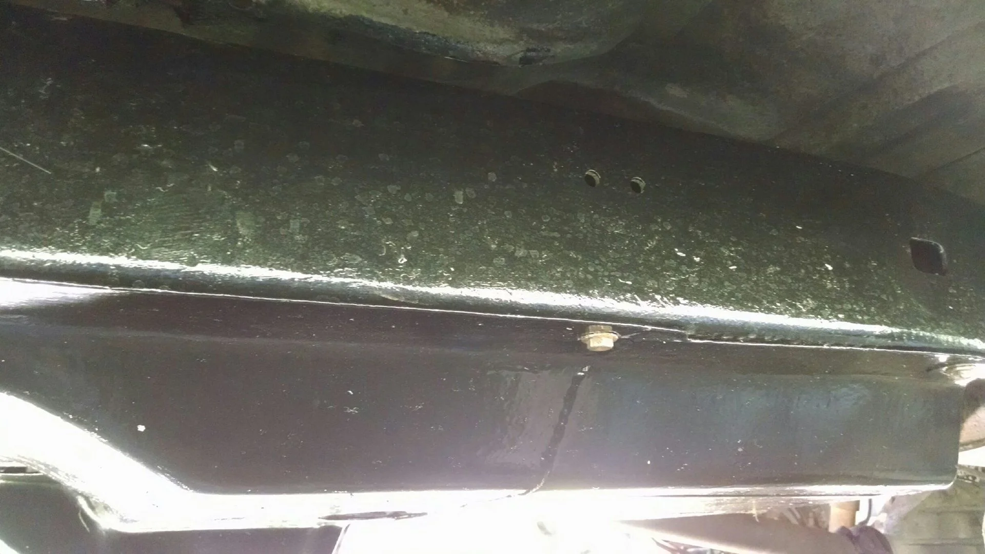

The lower part of the rig was mostly rust free, the worse section I have seen so far are the rear inner fender wells and the inner C channels in the rear which will have to come out and be replaced at some point, it seems that TT is the source for those. Other than that, I was luck enough to only find surface rust on the frame, cross members and skid plates. These had been undercoated at some point but was wearing thin. Skid plates and tow hitch came off to paint, for the rest of the frame I did the best I could and did not paint anything that I did not prep first.
So, I took the surface rust off the frame and put it in me... I used an angle grinder with a wire brush disc or cup, then a grinding wheel. To avoid inhaling to much bad stuff I did use a half face respirator and P100 cartridges.
Bare metal was then rinsed with phosphoric acid, a sacrificial coating of zinc primer, a coat of Rusto's rusty metal primer and then 2 coats of Rusto's gloss black mixed with Majic's catalyst hardener.

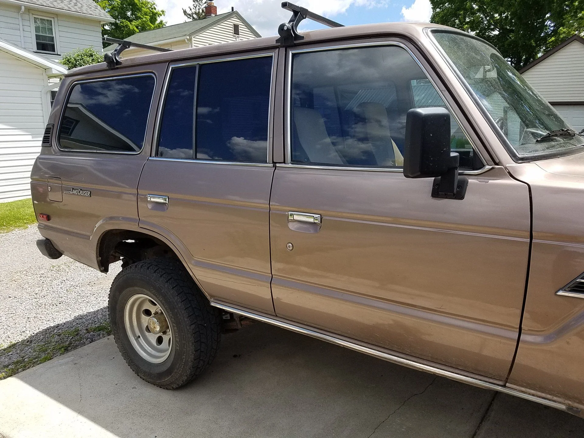

Nice looking 60.
About the only thing (aside from mechanical) I would do to that is replace the wheels with oem types. That is a very nice clean ride
Thank you and I couldn't agree more, those chrome MT's don't do it for me either. I'm patiently looking.

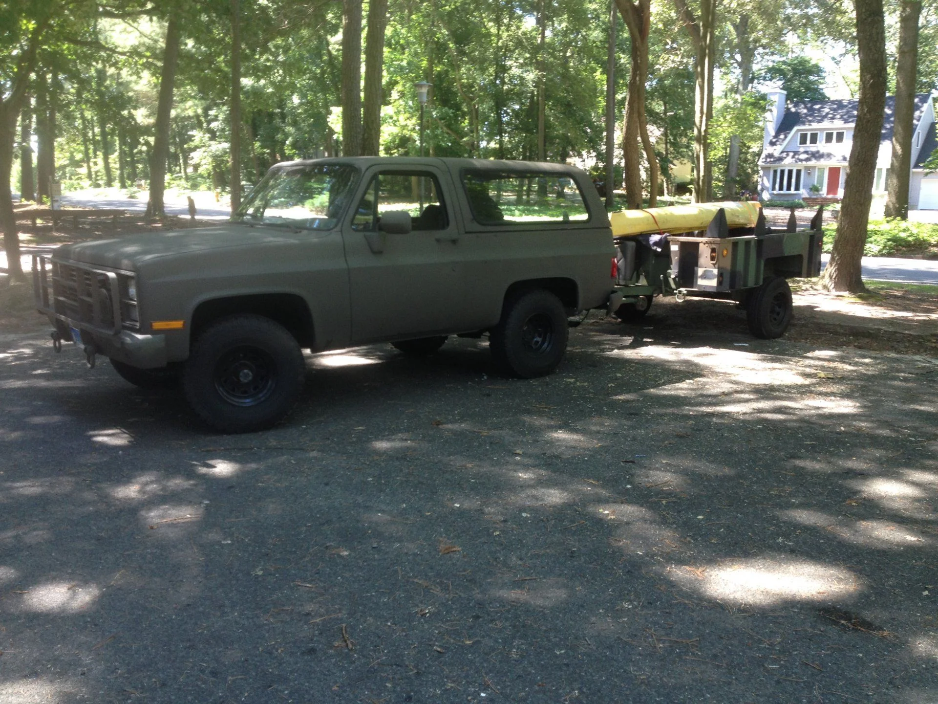

This is what I bought in 2013 in Raleigh, NC. It was winter with holes in the floor board and no heat, made for a cold drive home.
And how she sits currently on 33x10.5x15 Bfg AT, it's mostly stock otherwise, I've followed the whole "if it's electrical its been cleaned, if it's rubber it's been replaced" mantra. My first project vehicle, she's taught me a lot.
For some reason I don't have glamour shots of the rig without the trailer, hmmm.

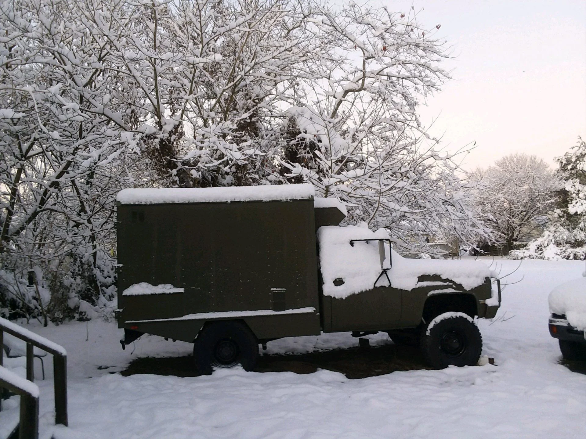

Be careful with green animals, they like to herd. Here's a project I had just started when Mrs.whatever's DD bit the bullet. It's moving along at a snails pace. M1010, 3" lift on 37"s, crossover steering... it'll get there.

The last one was considered an ambulance, although some units removed markings and used it as a command and control truck, good catch. Link to the description of a M1010. Both are powered by 6.2 NA/TH400/ NP208.

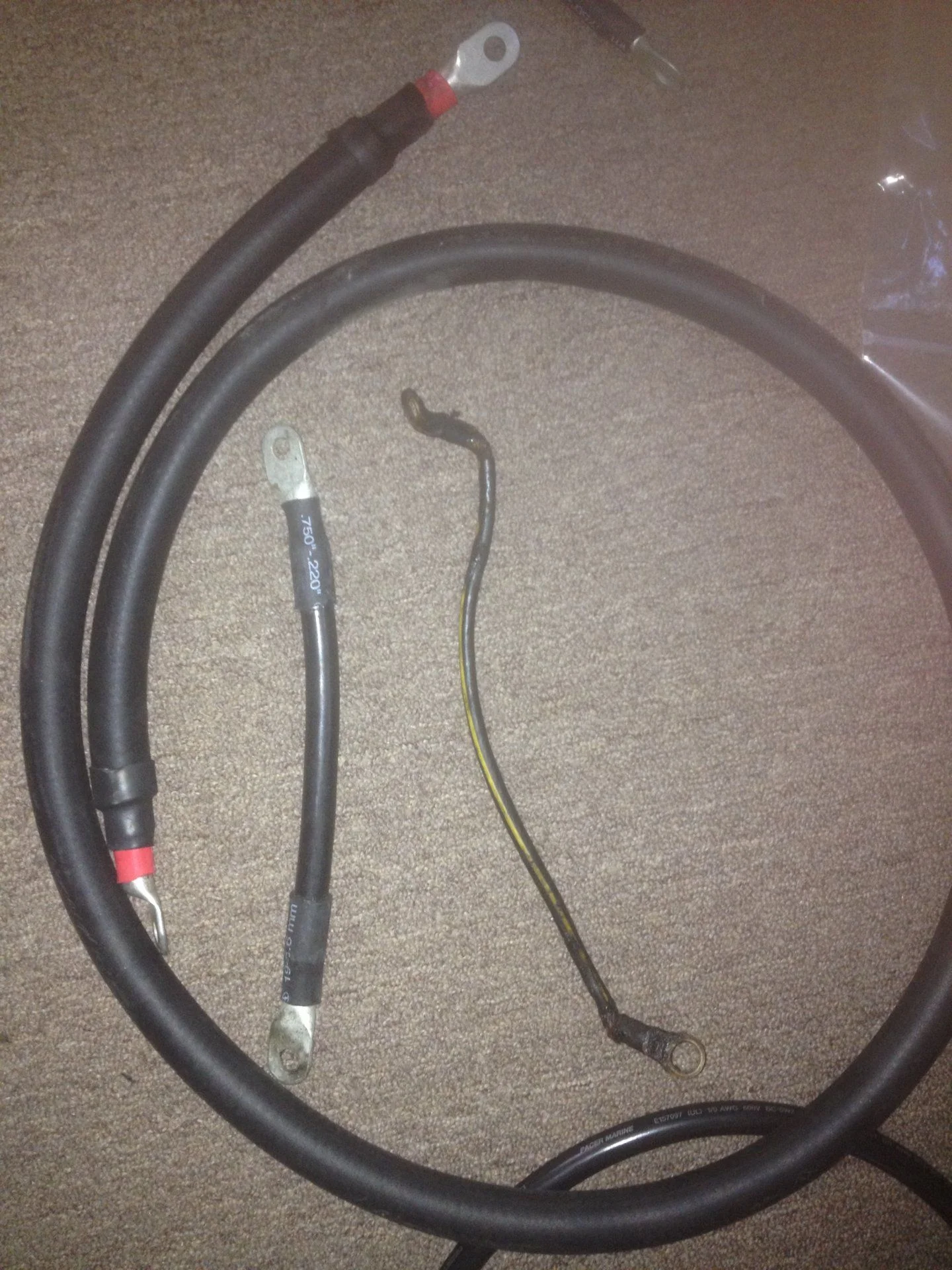

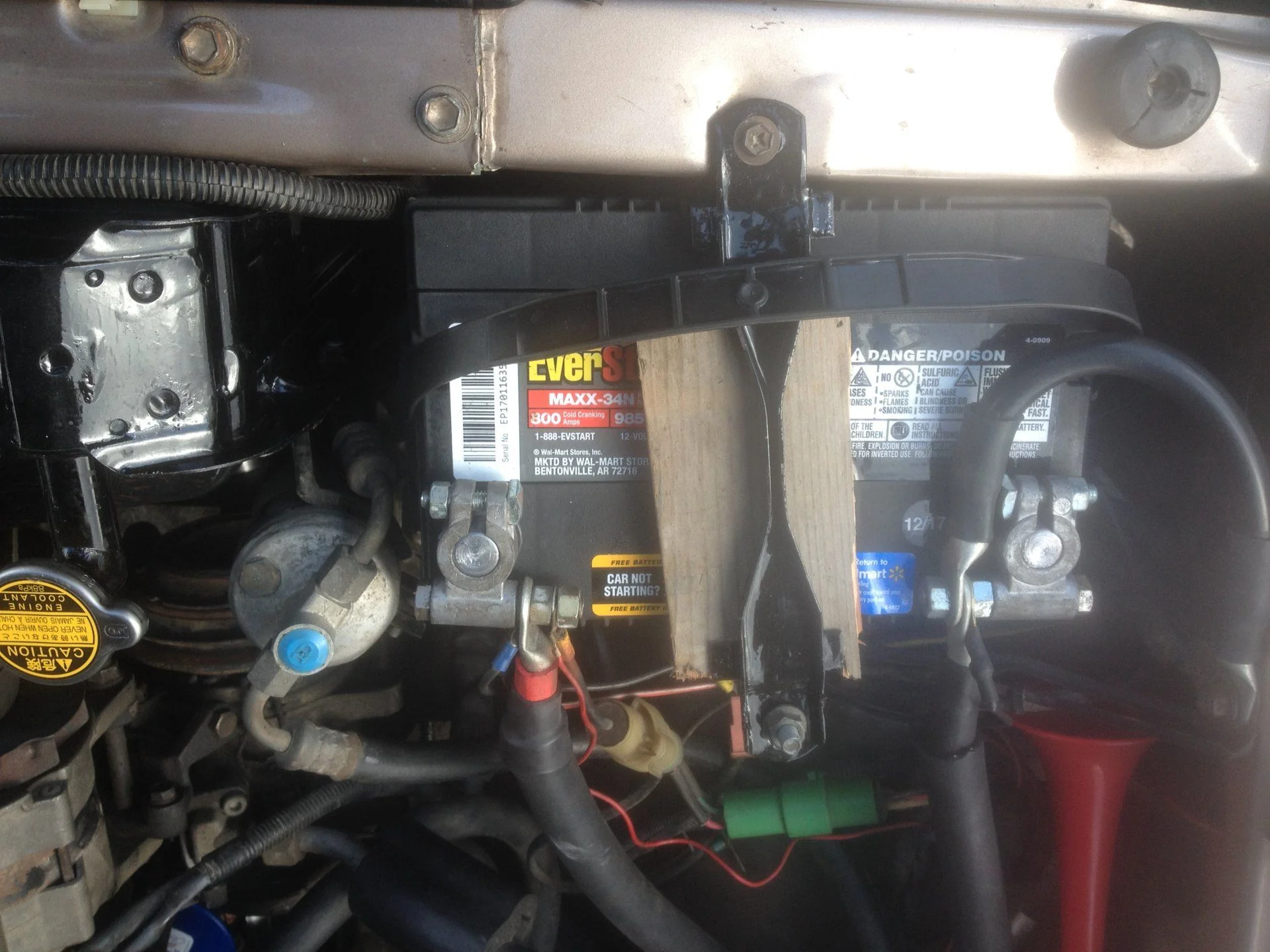

Back to Bernie, when purchased she came with a couple totes of spare parts. Including a bag of cables from Urban Land Cruisers (RIP) in the bag was letter from 2009 saying sorry for the delay and explaining why. No worries, they got installed in 2017.
Way overkill, in a good way. List of materials.
On account of the oil leaks in the engine bay (working on them), I chose to run the cables through heater hose, used heat shrink for the ends. Pictured also is a ground cable that was replaced for reference.
Switched out battery terminals to military style. The new battery required a hold down, version 1.0 fit, so haven't changed it.
