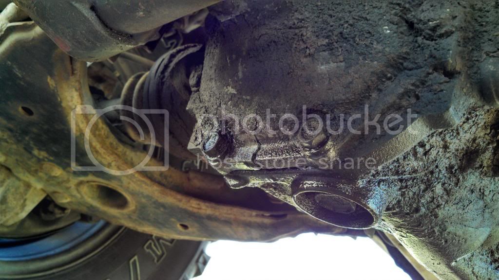

After I brought it home, I noticed it didn't seem like 4WD was working. Locking the hubs and engaging 4WD and driving in a figure 8 didn't result in any driveline binding or tires skipping, so I took a look under the truck. With the passenger side hub locked and the transfer in 4WD, the driver side axle shaft can turn freely, meaning the axle shaft isnt engaging the differential for some reason. Perhaps a blown diff? In any case, an closer look revealed the following:
Well dayum, maybe that had something to do with it. Everyone says I should go SAS, but being a daily, I don't want/need the lift that comes with the SAS, and the budget is pretty tight at the moment. Gonna look for some used parts (front housing and 3rd member) and get it put back together with new CVs, and that should take care of the front drivetrain.

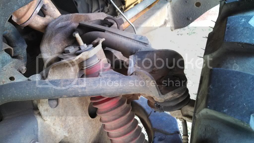

While poking around the front suspension, I noticed several things that didn't look stock. One was the upper control arm. I'm familiar with Toyotas having stamped steel arms, so this seemed out of place.
Anyone know who might have made this? I'd like to see how it is supposed to be installed, as the backside of the passenger side mount looks a little suspect. Here is a shot of the mounting brackets:
I guess the factory bushings wouldn't fit, so I'd need to order those from the arm manufacturer.
