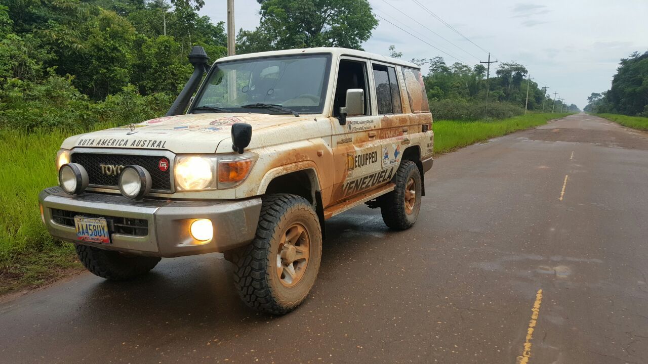

Omar bought a new 2016 HZJ76 and he is currently driving, with my friend Iker, from Venezuela to Ushuaia (Tierra del Fuego, Argentina) and back visiting several spots in between. Last I've heard from them they were in Buenos Aires, Argentina already and visited some cool places like Iguazu Falls:

Some photos of the HZJ76 during the trip:

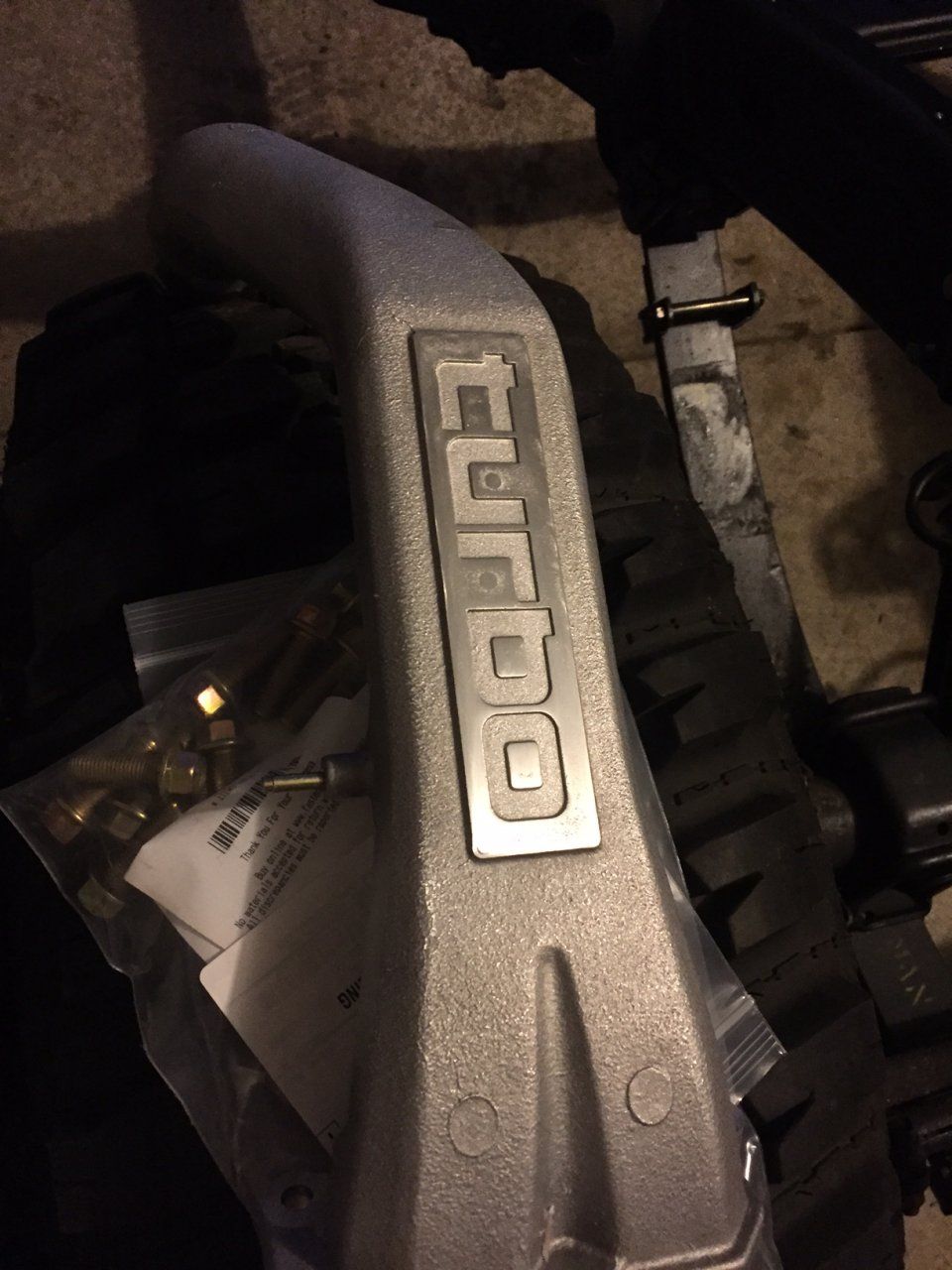

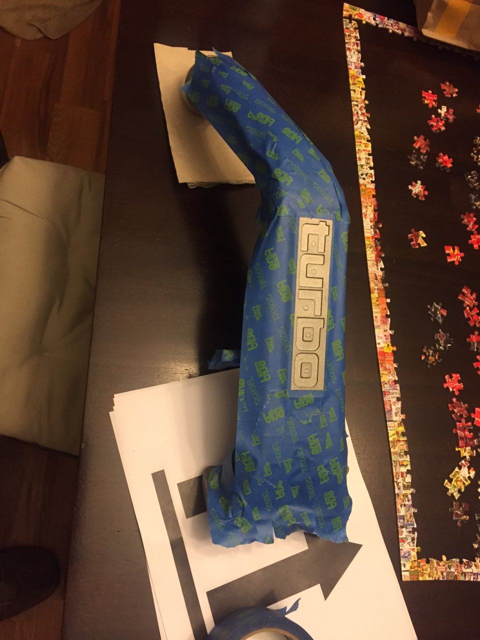

I want to start the engine and let it run for a few minutes and then keep moving forward and disassemble the exhaust manifold to install this:

Sounds like it is going good, any time you need to add a "TURBO" crossover pipe things are good. Is that going to be a factory set up off a 1HDT or are you just using the crossover and an aftermarket turbo? Either way high class.
That is rad you have that connection to Alien Workshop, I still try and skate when I can, but its a bit harder these days.(the ground that is)
A GREAT friend of mine, Brian @gifu, donated a CT26 Turbocharger for the 70. The Turbocharger came out of one of his vehicles and he graciously donated it to the cause. To do justice to the big savings Brian helped with, I tried to collect as many Toyota Factory parts to make it a clean install, and mimic (as much as possible) a 1HDT set-up.

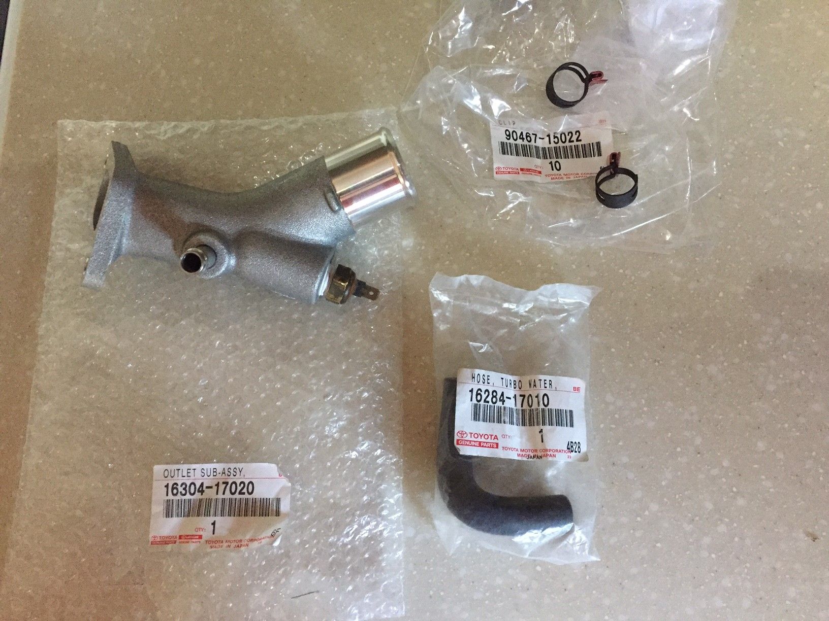

The CT26 Toyota Turbocharger is water (coolant) cooled, so I gathered the 1HDT Toyota parts that supply and return water to the CT26 Turbo.
Many of the steps I followed and the part numbers I used are described in this IH8MUD thread:
How to: 1HZ CT26 turbo install
The Water heater pipe that runs on the RIGHT side of the engine is replaced with the following part number:
There is a little pipe that uses two of the studs on the Water Pump that also provide cooling to the turbo, and this pipe assy goes behind the timing cover plate, so I needed to get that step added to the mix when assembling the Water Pump / Timing Belt combo:
And then finally the outlet of the engine also needs to be replaced:
Land Cruiser Parts and Consulting did the Lion share of sourcing these parts and I want to give kudos to Onur @beno for helping me with this:
