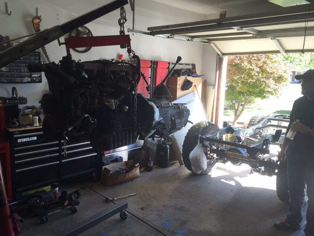

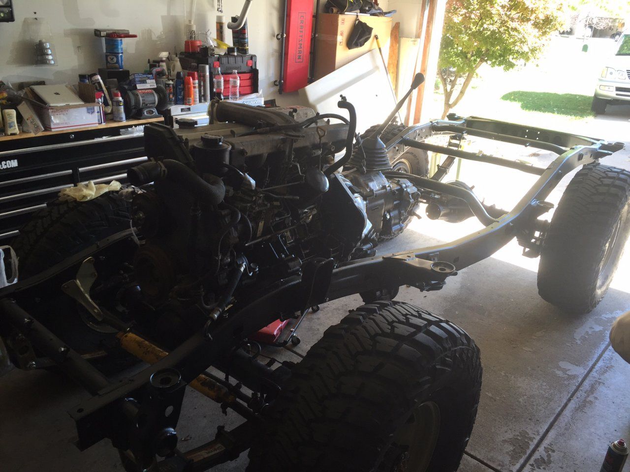

Then my friend Pete @94SRUNNER came over to help me mate engine and tranny, and also to place the drivetrain on the frame. Some photos of the process below:
Thanks for the help, Pete, I really appreciate it!

You are welcome Alberto! Happy to be able to help with such an awesome build!

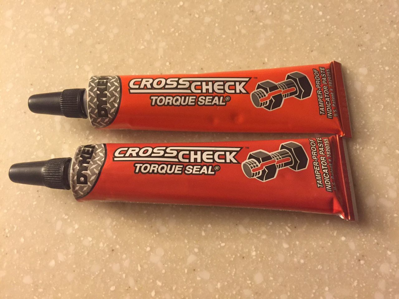

I bought this thing called Cross-Check Torque Seal from Amazon to mark the bolts/nuts once they are correctly torqued. I think it is mostly intended and designed for the Aerospace and Aeronautical Industry, but I want to see how well it holds the pressure wash and normal off-roading conditions.
It says that it meets Boeing Specs ;)

Then tried the Cross-Check to see how it goes. It is more like a paste than paint, I like it.

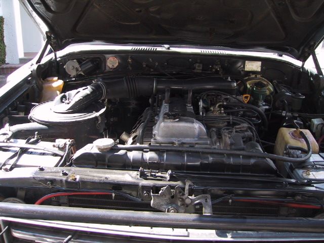

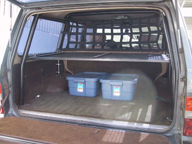

But, back when I lived in Venezuela, I had INTI (the shop that makes, in my opinion, the nicest custom build bumpers in Venezuela) build me a partial roll-cage with a cargo divider for my carbureted powered 1FZ + H151 60-series.
Below some photos of my ex-FZJ60:
And the roll-cage load cargo divider that I really found useful:
