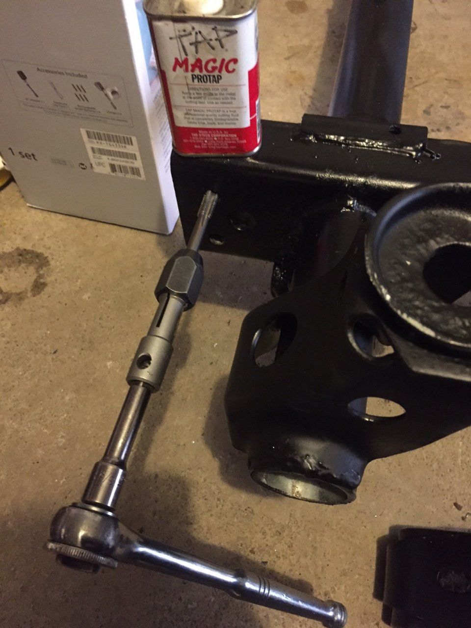

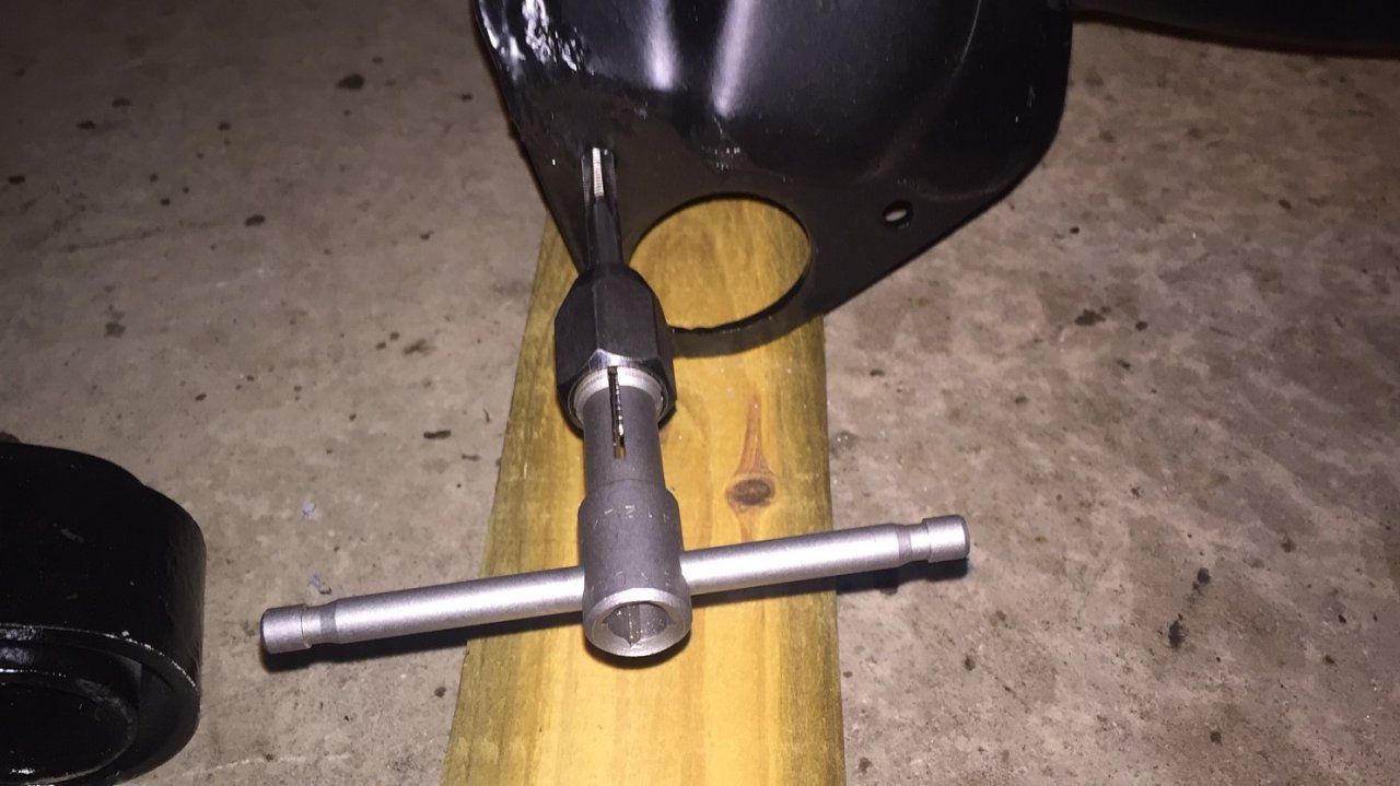

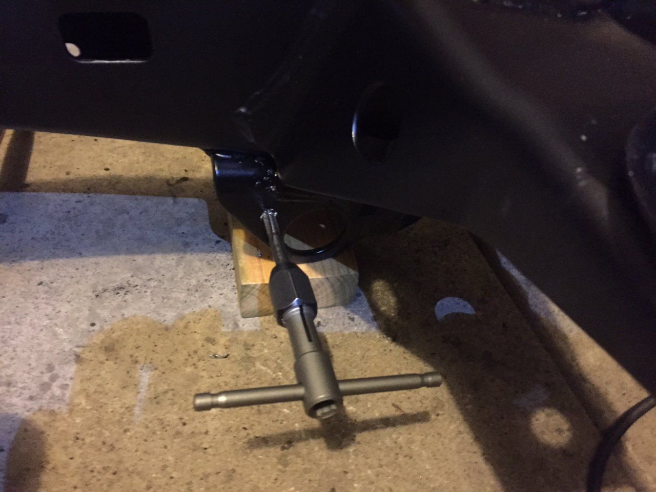

The frame prep is going "OK". Before the galvanizing, I had left a few bolts in some of the threads thinking that this would "protect" the threads making it easier to clean them later.....wrong!
I probably left about 10 - 15 bolts on the frame and about 7 or 8 broke when I tried to remove them. These were left hand-tight prior to galvanizing. I think that the galvanizing process somewhat fused them and broke when trying to remove them. It turned out to be WAY easier to chase the threads on those holes where no bolt was left than having to deal with the pain of drilling out broken bolts.
There was a lot of this going:
I am now done with the drill/tap session so I can move ahead and start assembling parts.
Note to self (and to whoever wants to galvanize something later down the road): Do not leave fasteners attached to the frame/structure. It is easier to run a drill and tap to clean threads than having to deal with broken bolts.

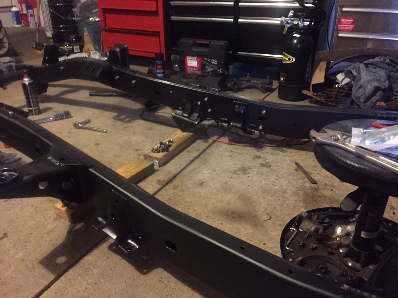

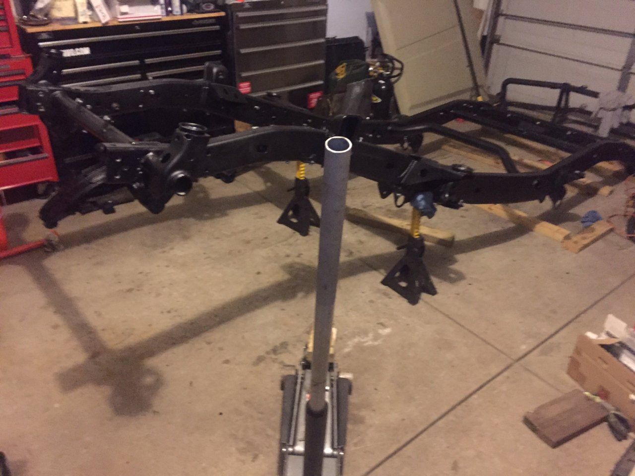

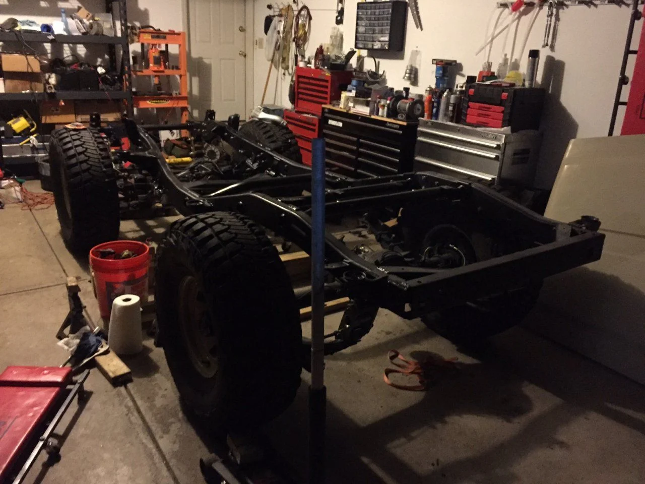

Some of this has been going on lately (in other words, veeeeeeery slow :confused:):
1. Jacked up front of frame to install front axle and suspension
2. Front axle/suspension loosely attached
3. Jacked up rear of frame to install rear axle and suspension
4. Started to look like a rolling frame
5. Another angle
Haven't torqued any bolt yet. Will do some of that when the weight of the vehicle is back on the suspension. I will put paint markings when I go over every single fastener on the frame.

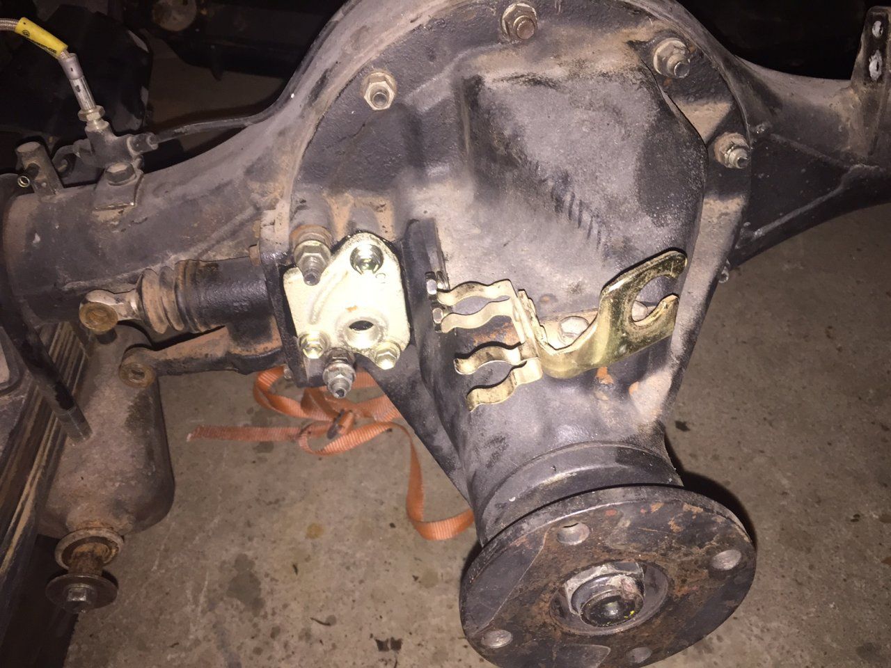

While I was installing the suspension, I noticed that some of these pieces were looking a little sorry. I had used a wire-wheel and paint when I put the axles together but was never really happy how they turned out.
A little Moab dirt on the axles. Wish I was there again this year.
Took both of the locking mechanisms to get cleaned and took another few miscellaneous pieces to get cleaned and plated, too.
Before:
After:
I had Smith Electrochemical in Cincinnati do the work Smith Electrochemical Company. I asked for yellow Zinc which looks "ok" but maybe a little to flashy/bright I guess.
What do most people get when doing this type of work? Cadmium plated?
