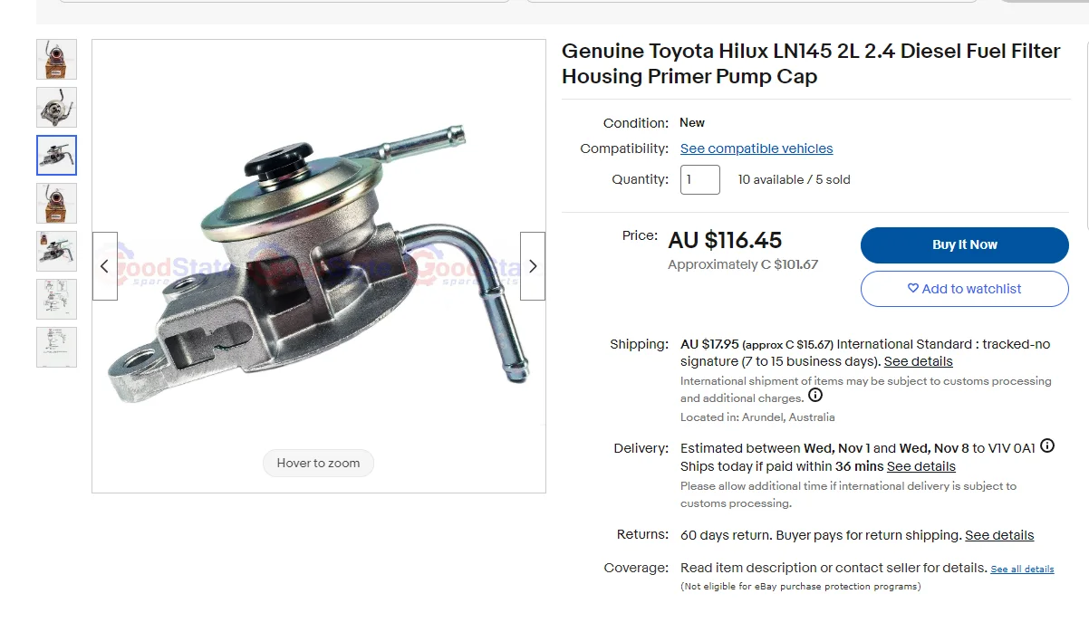

I would recommend upgrading to the newer style fuel filter with built in water separator in the 84 and above models.
You can get the housing for relatively cheap online
You can get the filters at most parts stores as they share the number with modern duramax filters.
