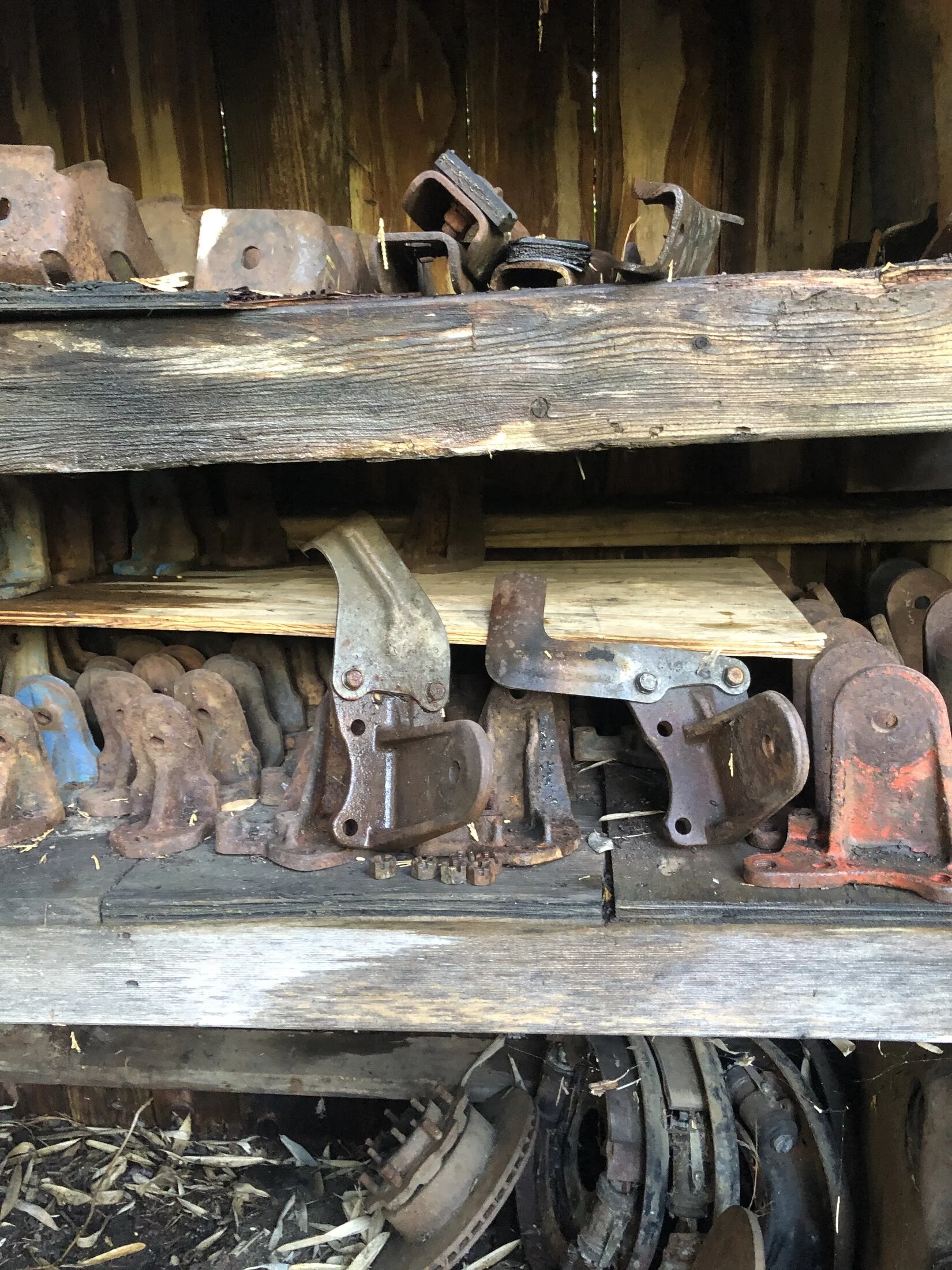

I have several of the second bracket. I might have one of the first.

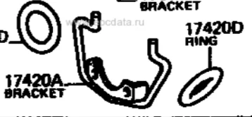

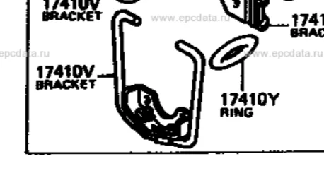

@pardion I think the one on the right is 61030 and it may be for the earlier models where the exhaust pipe runs down the inside of the frame. Just looking at it (I've never laid eyes on these parts before) leads me to believe it may catch the pipe lower. The one I was thinking fit my plan is 61060. I'm wanting to catch the down pipe earlier in its run because I have to cross over to the outside of the frame rail.
However! The one on the left is the US normal for the 79+ twin down pipe. I had not considered using that bracket because i'm going single pipe....but it may be the best option. I could probably weld a hold on the down pipe to work with that one.
I have to think about this a bit. Unclear.

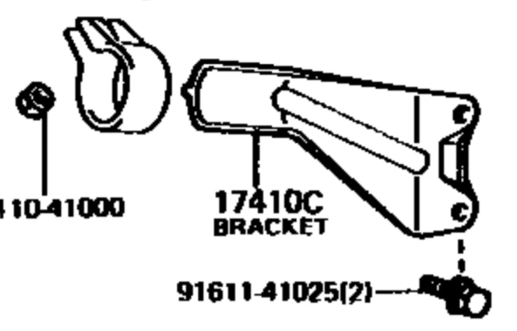

The parts diagram for 1/79+ in most markets and US 8/80+ market shows the bracket angle up not down. Which makes sense since the exhaust runs over the frame not inside along the frame. Part number is 17571-61100 of course it is NLA.

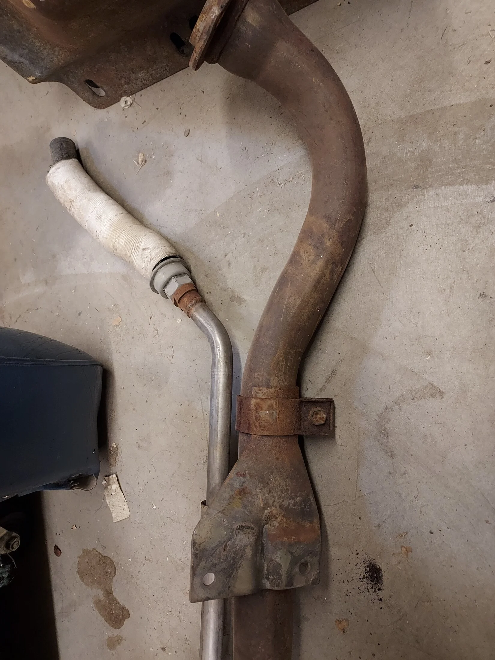

I've got the two different down pipe from the used on US FJ60s.
Not sure if either of these could be a start at making one.
Yep @Living in the Past .... this piece of your second photo is what i was "thinking" was the proper choice.
This type of bracket is pointed more forward (as opposed to down) as you pointed out. For 1979+ the down pipe crosses the frame on the "dirt side" of the frame and is routed outside of the frame rail due to the cat. I have seen pics where the FJ Company routes it "on the non dirt side / over" but still gets it to the outside of the frame.
