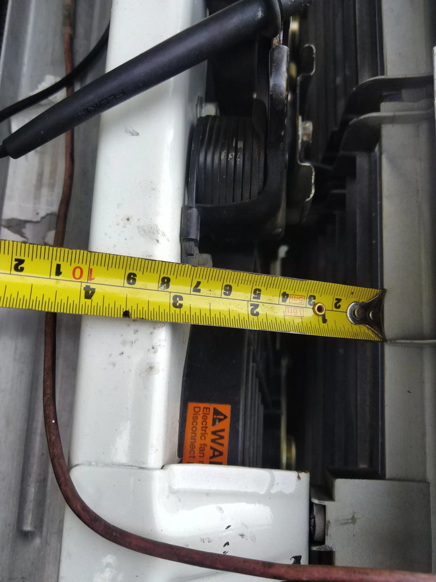

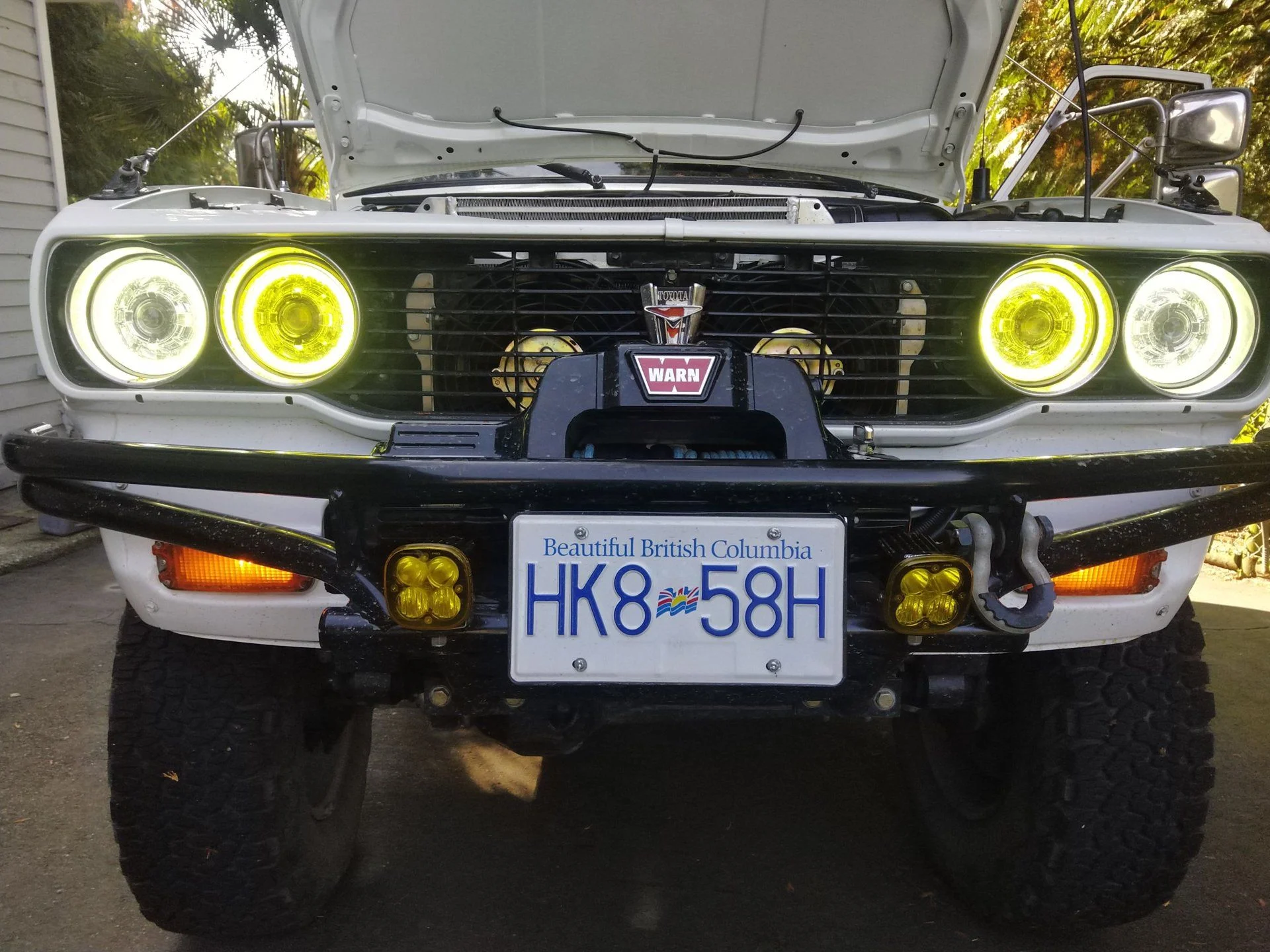

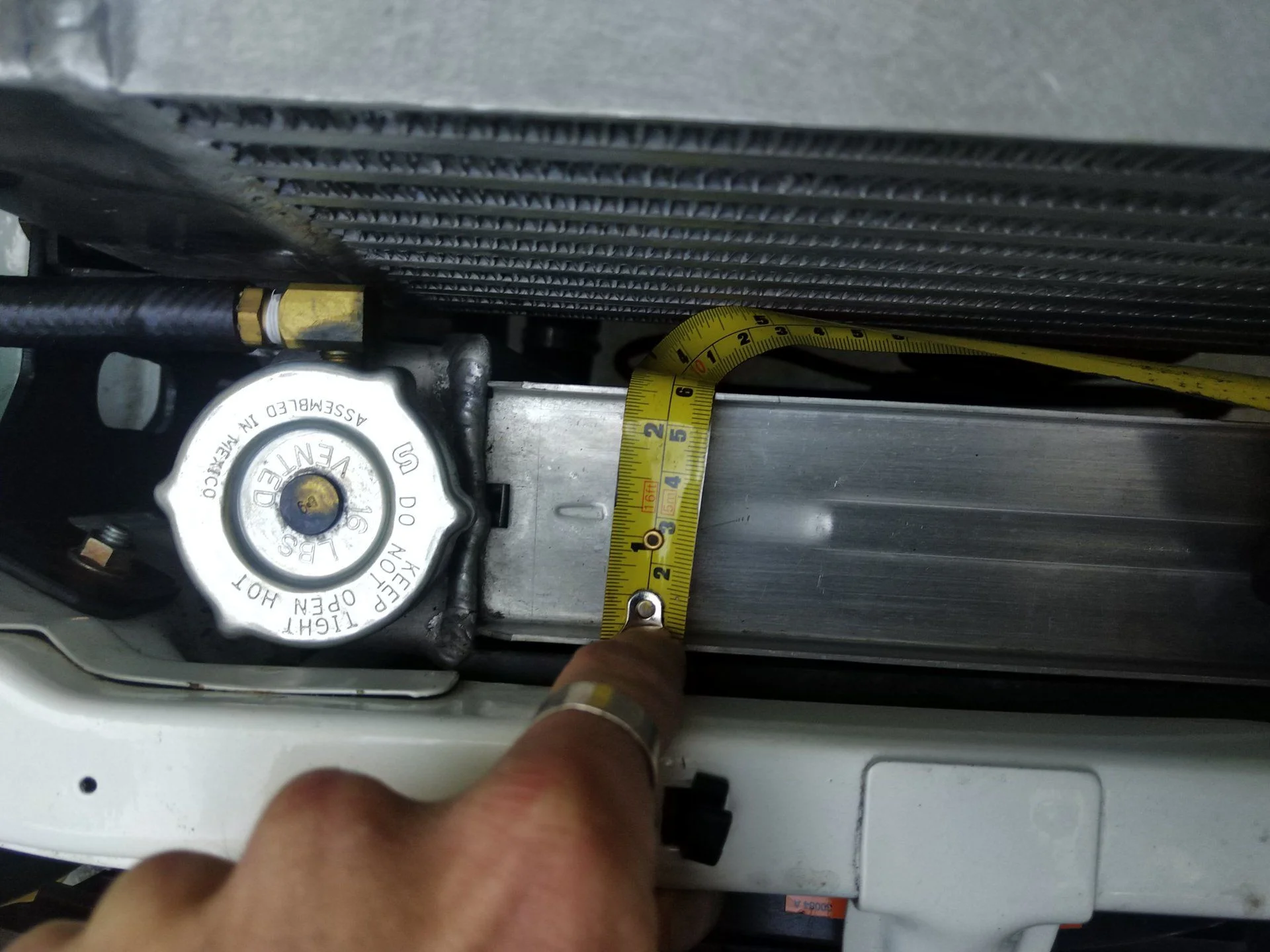

Agreed, but does an intercoole exist that is that narrow? I literally have inches between my rad and my grille.

I believe I really only have about 2.5" Max of clearance between my grill and rad support. Do they make some that small for that amount of airflow?
Look at an intercooler from a Volvo 740, 2.5 inches thick.

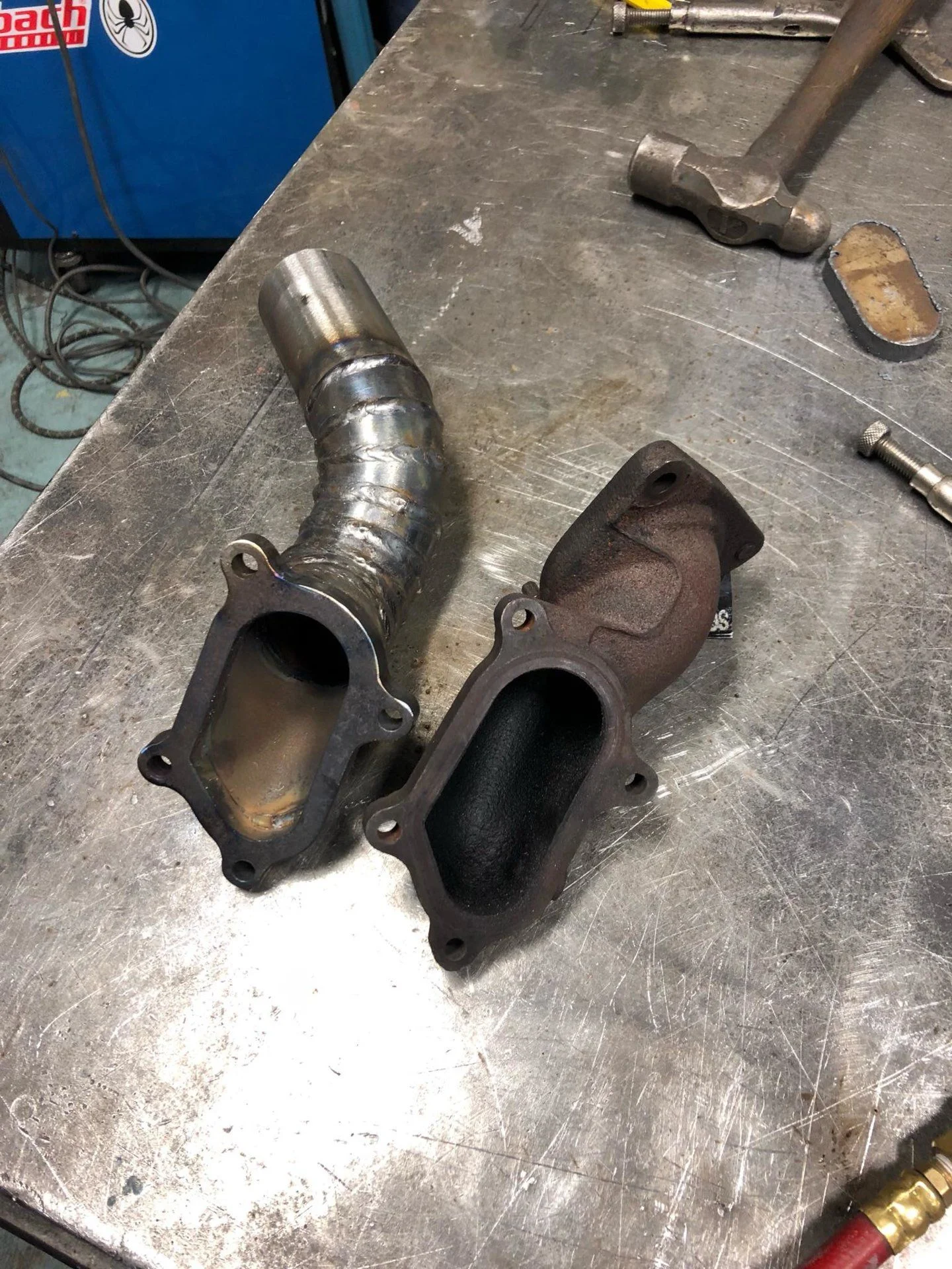

- Running a 2.5" exhaust with free flowing muffler from turbo back (custom dump pipe as well)

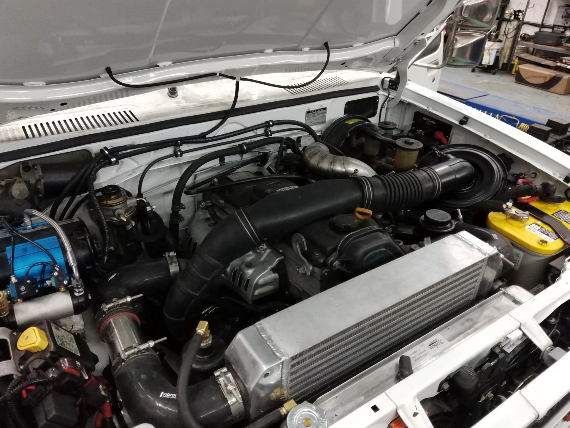

- inter-cooled

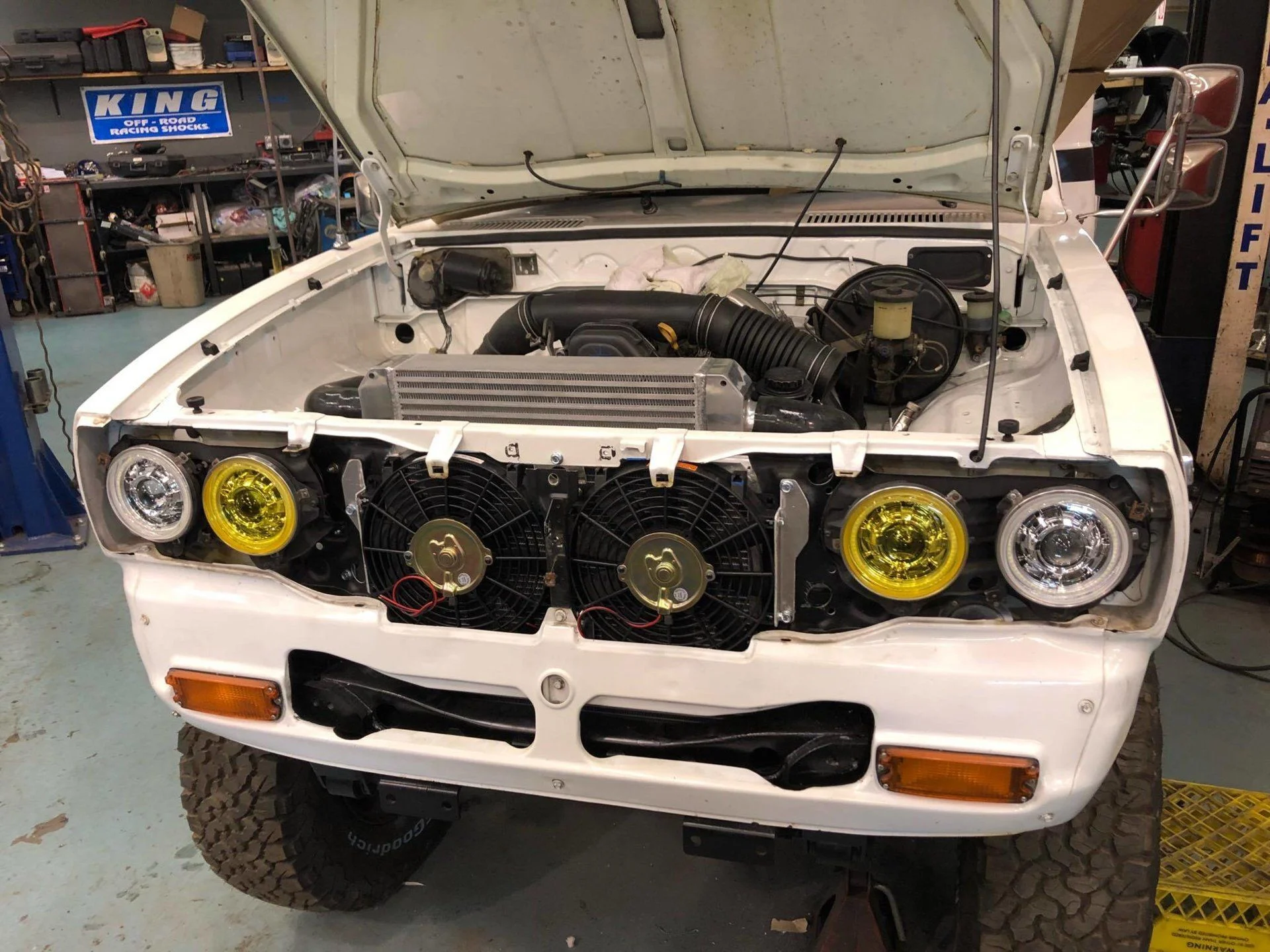

-Large radiator with two front mounted fans
(my notes of improvement are as follows, remove inter-cooler to increase room behind rad, add rear mount rad fans (no room for mechanical) possibly do hood scoop with top mount inter-cooler. Not a lot of airflow through the front of the truck)

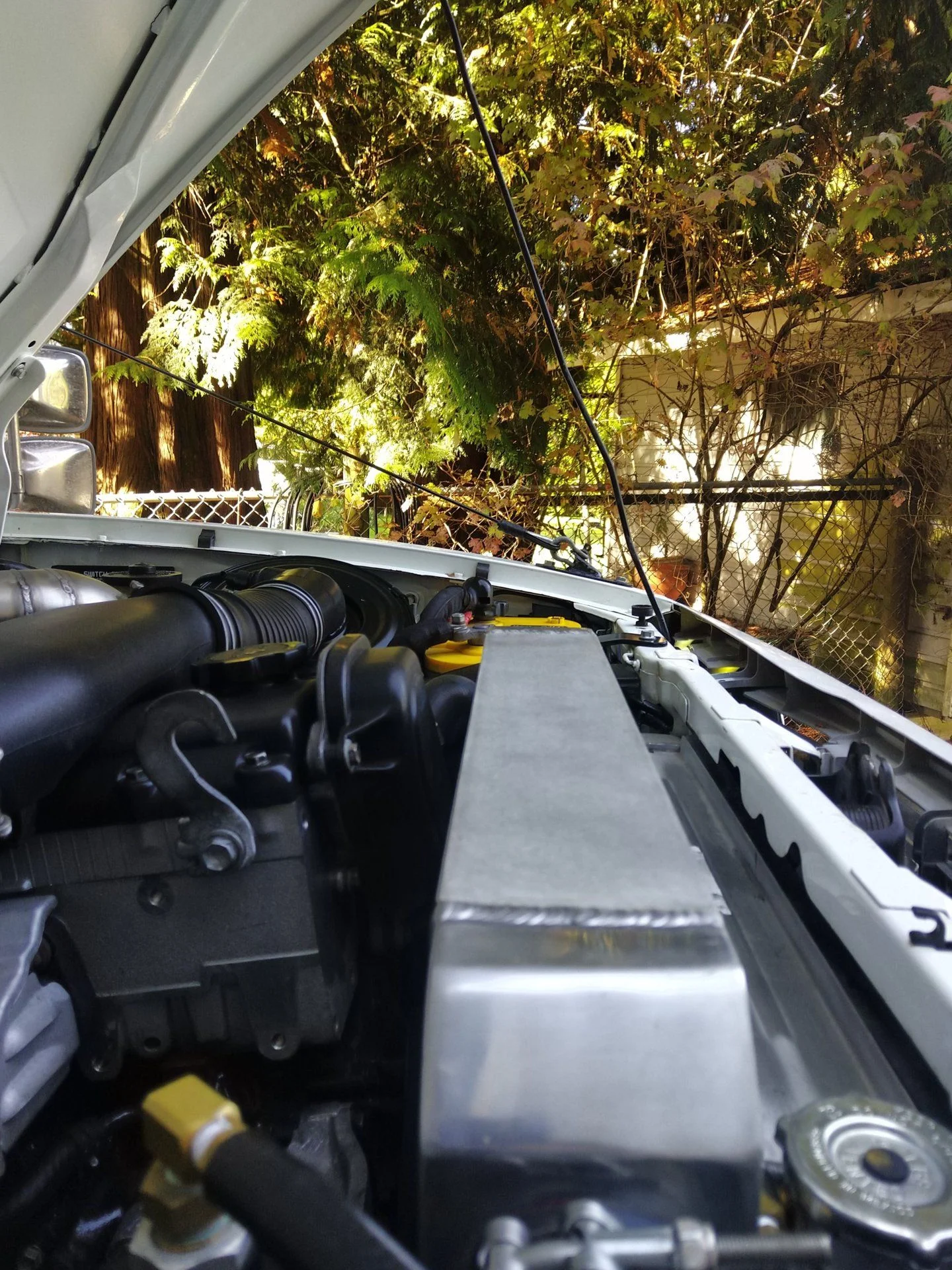

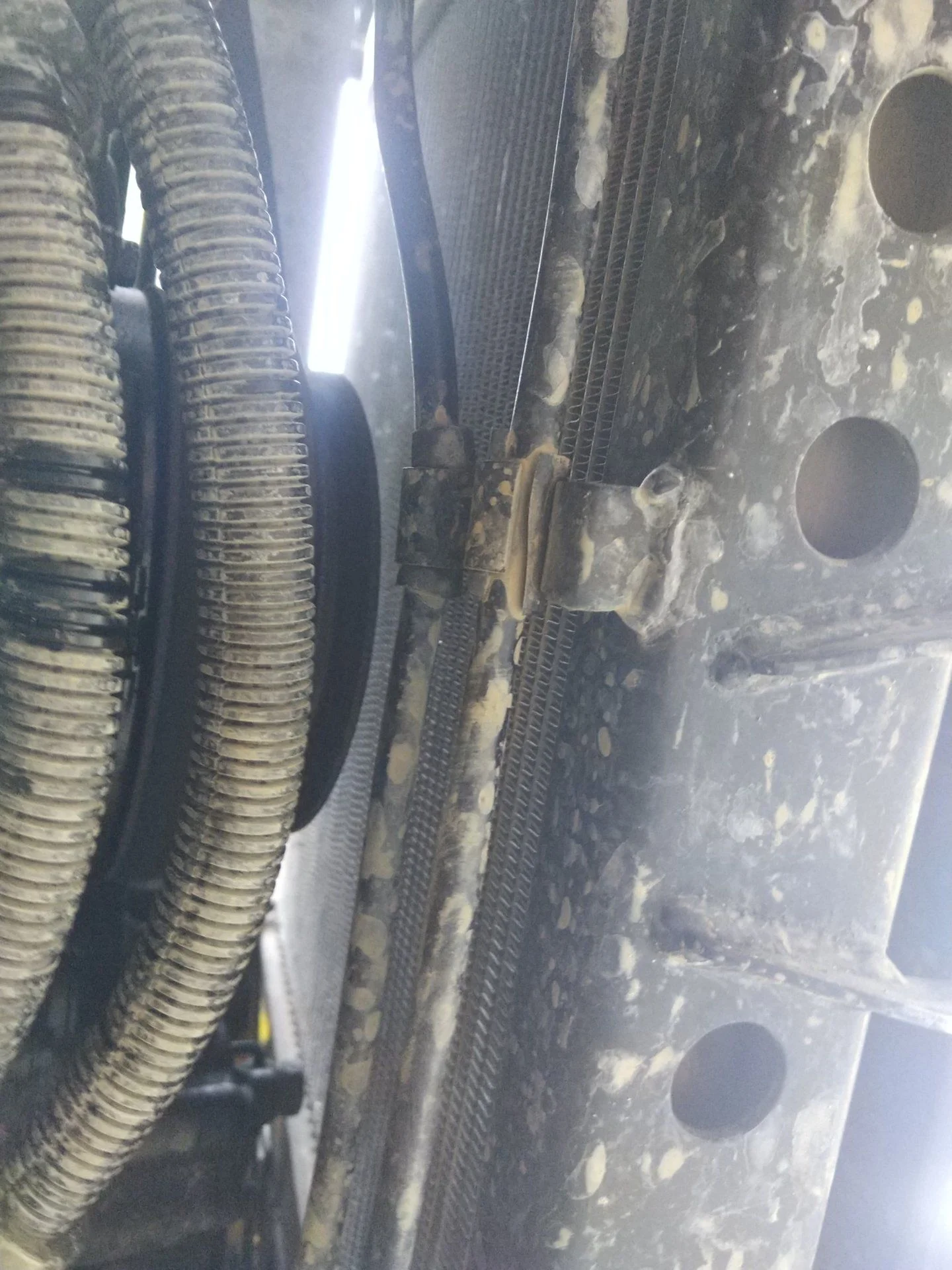

So there's your cooling problems right there. Whoever did your cooling system setup got it all backwards.
Intercooler goes in front of the radiator because it needs the coolest air.
Radiator goes behind the intercooler.
Radiator needs a shroud so the fans can pull the air over 100% of the radiator core area.
Fans go behind the radiator.
Currently you have pusher fans that are next to useless and your intercooler being heat-soaked by the radiator in front.

I can tell from the first pics though that cooling pack is the problem. That is a horrible IC install, none of it is sealed either. Electric fans suck, especially on a diesel. That cooling pack needs to be completely redone and reconfigured. It needs a mechanical fan and proper shroud and good sealing around it all. After that is fixed you can start tuning it.

In my opinion the shop who did this swap did a crappy job. That cooling pack is just foolish. Not to mention the location of the air box, I mean why would you ever put the air box on the opposite side of the engine bay as the turbo and then run intake hose across the top of the valves cover? 🙄 If it’s like that because things don’t fit, well the shop should have dealt with all that with the customer before even starting the swap. There is a process when you start a build and or swap to determine what is the best engine to install. That has many factors but right up near the top of the list is, will it fit!? And by that I mean will it fit correctly. This 1KZ looks to not fit. If you can’t even get the radiator setup right with a good shroud and mechanical fan then you should look at other engines to swap or look at doing body mods to make it fit right. Looks like what the OP got was a 1KZ crammed in there and hardly any thought about all the other important things.
